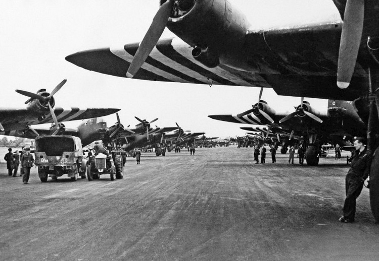

schweinhund227
Posts: 2627
Location: Ontario,Canada
Re: Invasion stripe sizes.
Post by schweinhund227 »
Nige201980 wrote:Hi guys thought this might help with invasion stripe if you plan to paint them.
Single engine fighters.
Real thing. 18 inch, 46cm
In
1:72 - 6.39mm
1:48 - 9.58mm ( I normal use 10mm tamiya tape)
1:32 - 14.38mm
Double engine/ 4 engine transport
Real thing. 24 inch, 61cm
In
1:72 - 8.47mm
1:48 - 12.7mm
1:32 - 19mm
And remember 4 engine Bombers didn't have invasion stripes
Hope that helps guys.
Sorry Nigel.....
what about these?
They are glider tugs norm or transports not bombers.
That's what the Stirling was mainly used for during D-day.
Stripes were applied to fighters, photo-reconnaissance aircraft, troop carriers, twin-engined medium and light bombers, and some special duty aircraft, but were not painted on four-engined heavy bombers of the U.S. Eighth Air Force or RAF Bomber Command, as there was little chance of mistaken identity — few such bombers existed in the Luftwaffe. The order affected all aircraft of the Allied Expeditionary Air Force, the Air Defence of Great Britain, gliders, and support aircraft such as Coastal Command air-sea rescue aircraft whose duties might entail their overflying Allied anti-aircraft defenses. To stop aircraft being compromised when based at forward bases in France, D-Day stripes were ordered removed a month after from the upper surfaces of airplanes, and completely removed by the end of 1944.
