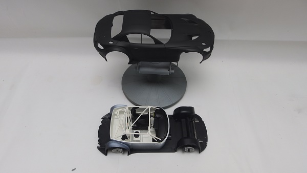

:banana: :banana: Chassis has been painted semi gloss black along with several other parts. The chassis gearbox was painted aluminium and the exhausts painted with oily steel. The brakes/discs were painted aluminium and steel then black panel washed to bring out the etch detail. :banana: :banana:

Re: Fujimi 1/24 GoodSmile Racing Team BMW Z4.
:banana: :banana: The cockpit tub has been painted and various parts added along with the roll cage. Some etch added to the front.
The upper body shell has been assembled by adding side panels and the bonnet air scoops. After a clean up the first coat of undercoat has gone on. :banana: :banana:

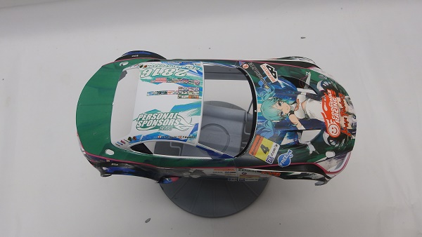

:banana: :banana: Started at the front with the decals. :banana: :banana:
:violin: A word of warning if your contemplating building this kit Fugimi decals are thin and delicate, you will be ok if you lay them so you have minimal movement to get them in place. They dont take well to decal softener either so use it if at all in small amounts, take your time and be very careful. :bash:
:banana: :banana: :drool: :drool: All the major decals are now done just some small ones to add here and there. :drool: :drool: :banana: :banana:
That looks eye wateringly good mate your definitely in the groove with decaling 👍🏻
Awesome decalling :th:
