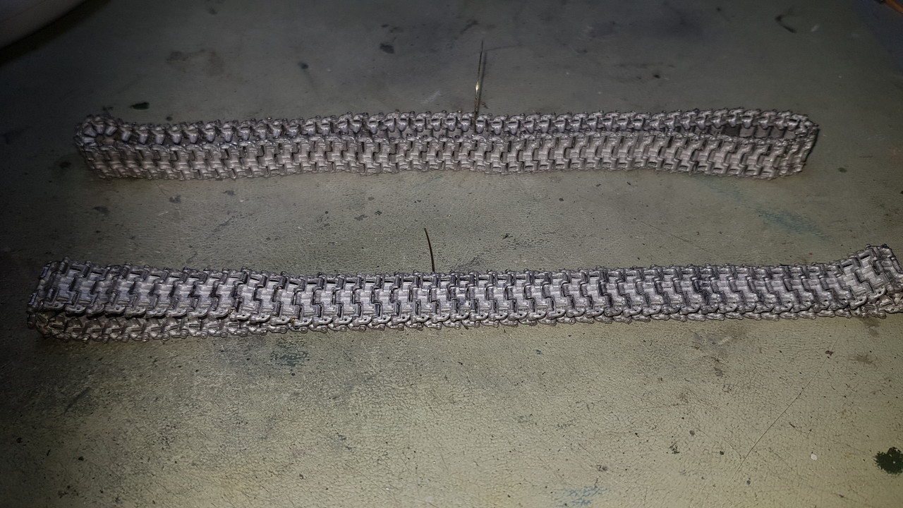

The T34's tracks are completes - all cleaned up, super-glued and ready for a good wash in soapy water tonight. Then into the Burnishing Fluid together with the Shilka's.

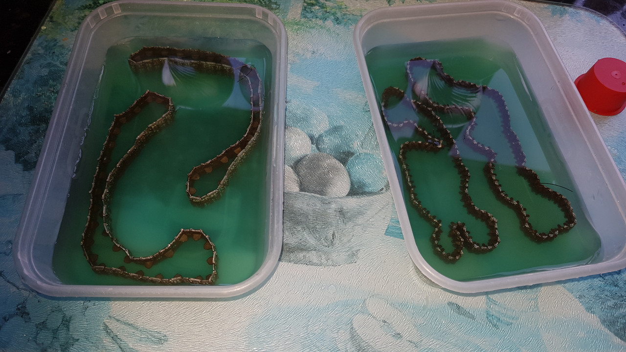

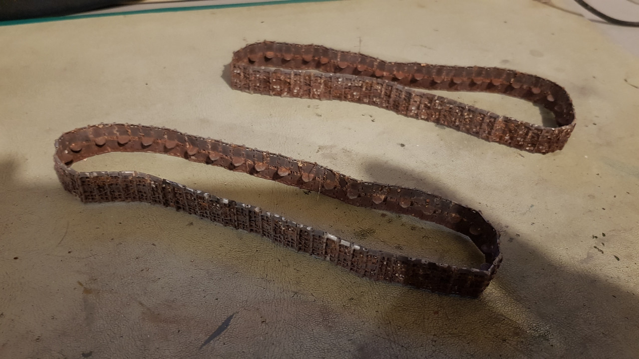

    So - the big day - time to try out Ultimates Burnishing Fluid. I split the bottle into two and topped up with fresh water as per the instructional video on the umpretail.com web site:
    And left them to soak. This is the state after some 10 minutes:
    The bright spots being where the fluid hasn't taken - hopefully just a case of "yet". :)
    I am going to leave them in for 6 hours checking hourly to see what happens,. Might have to stay in overnight...
    One thing to note for the future or if you are going to try using metal tracks and fluid - its best to soak the links BEFORE building the track up - the fluid won't take to superglue - and that's what holds the pins in..... Silly me missed that bit in the "how to" video.. :(

      They're looking good! It should be an easy work around if it is super glue stopping a few areas from burnishing, although inconvenient.
      Re: 1/35 Zvezda T34-76
      It is the superglue in most places. Somebody must do a dark rust paint colour - I hope! :)
      If I am going to do any more track that requires the pins sealed then I need to find a more accurate way of applying the CA other than using a toothpick - my hands are a bit too shaky for that to have the required accuracy.... Old age is a bummer I can tell you!!

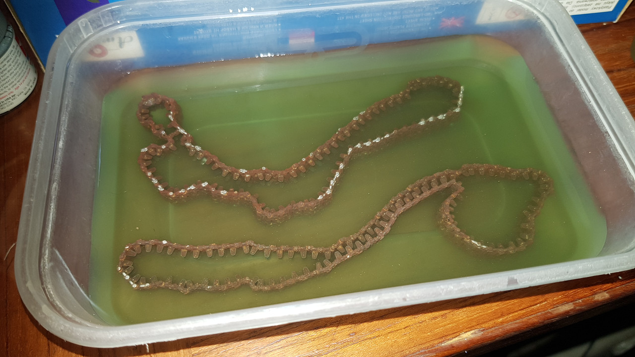

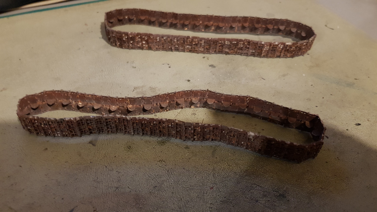

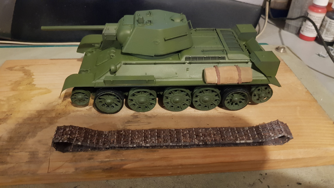

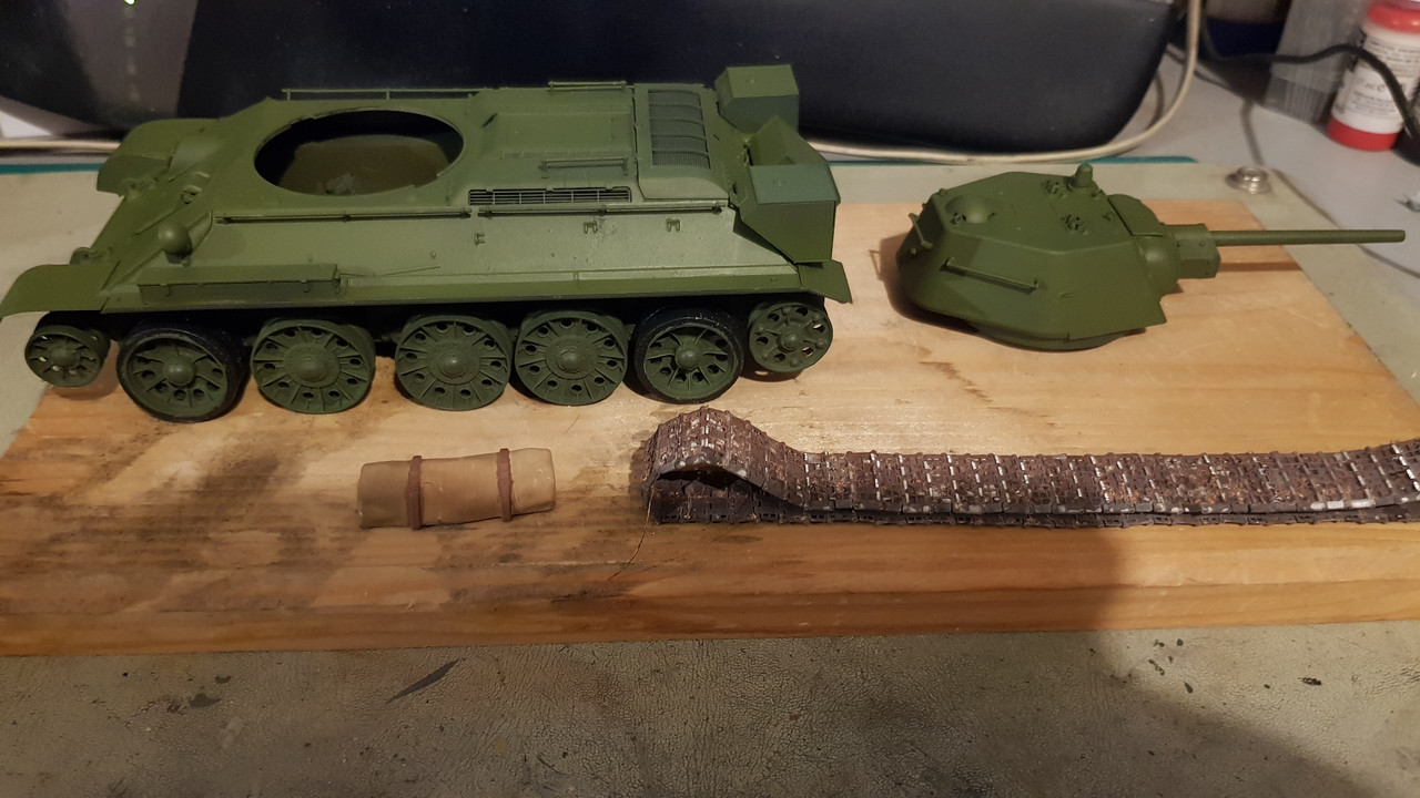

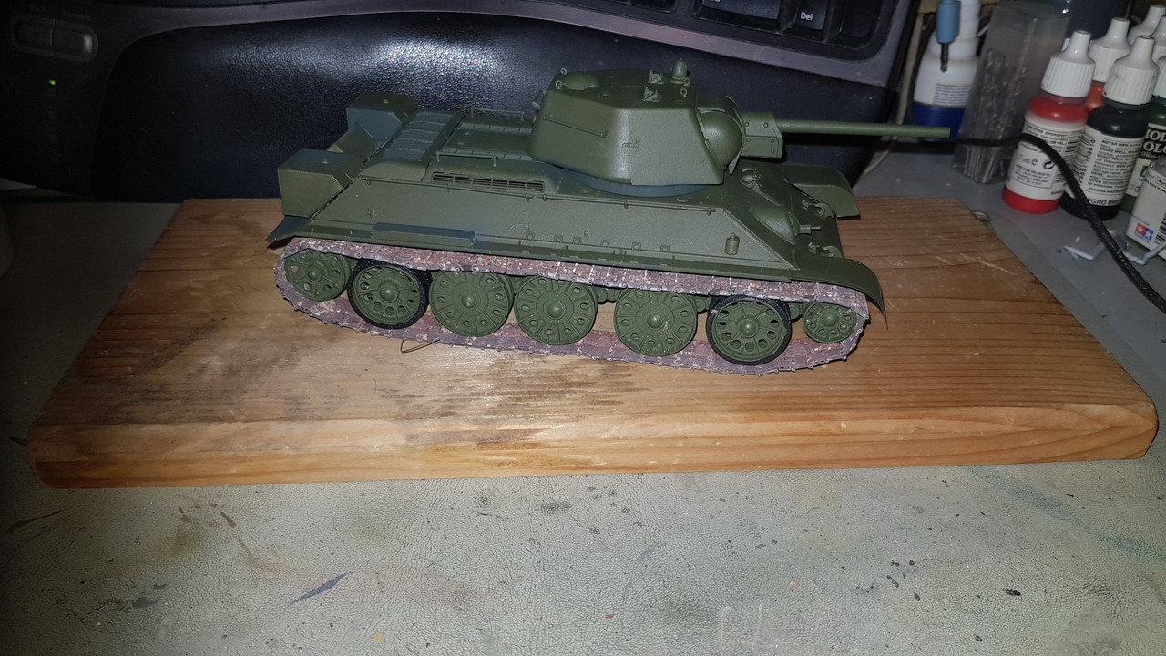

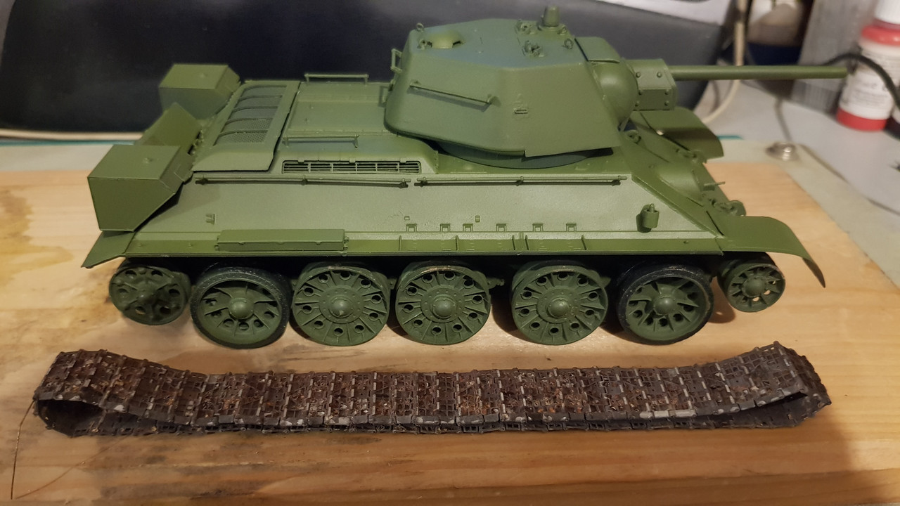

        Today I concentrated on the T-34. The tracks were left for over 14 hours in the Burnishing fluid and I am happy with the outcome - nice and rusty looking. Just need a very thin strip of abrasive run around the centre inside to mark the passage of the road wheels.. I don't understand, though why the fluid failed to penetrate some of the recessed sections. I worked them over in the fluid with a toothbrush to get the fluid in everywhere. I suppose that will be one of life's great unanswered questions!! :)
        And flipped:

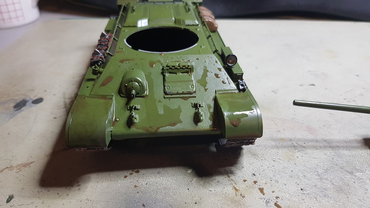

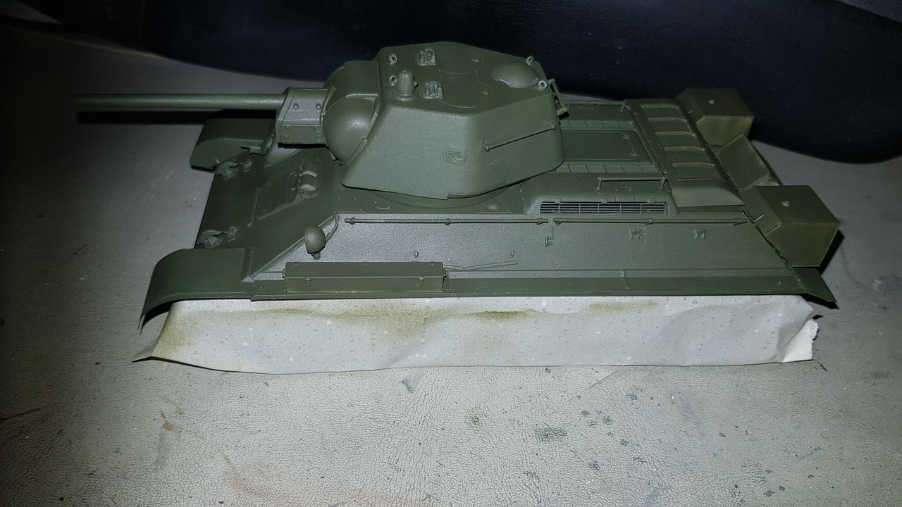

        I then got the airbrush out and gave the hull and turret a blow over with Vallejo #609 4BO Green primer. Wheels are masked as I did not want to be repainting those tyres again...
        That's going to dry overnight and then tomorrow I add the #018 black green into the recessed areas as per the instructions and #017 Light Russian Green on the high spots. I have one SMALL problem though - I have somehow misplaced the painting and decal sheet for this one!!! :oops:

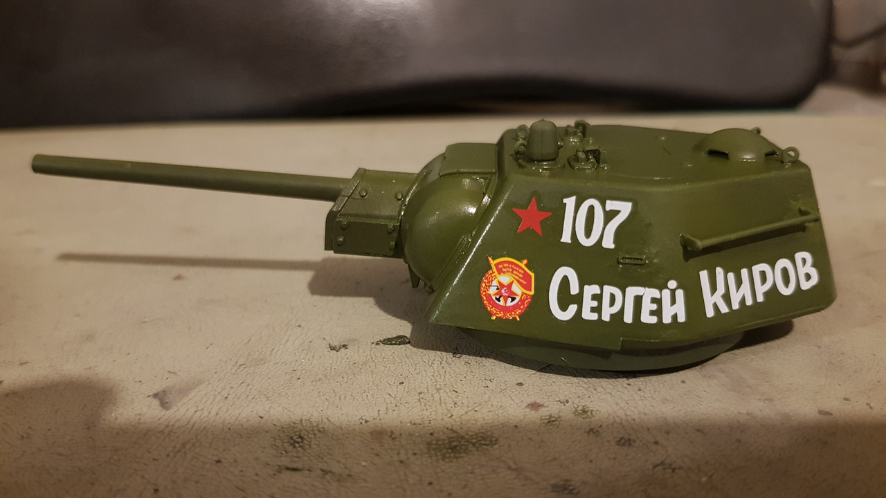

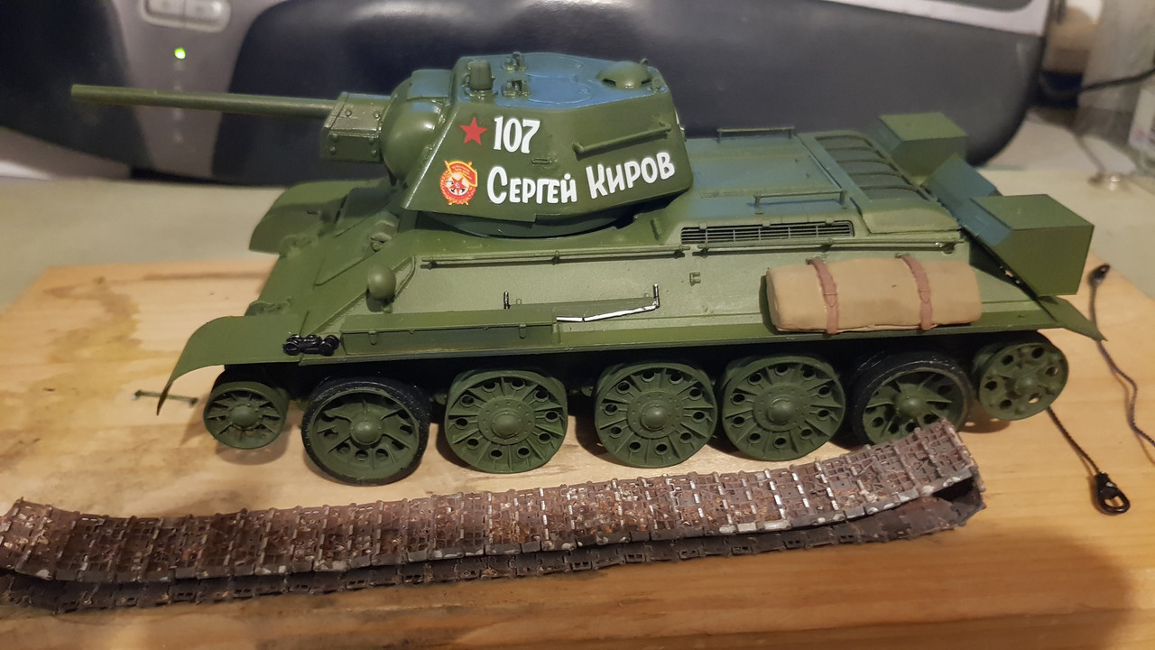

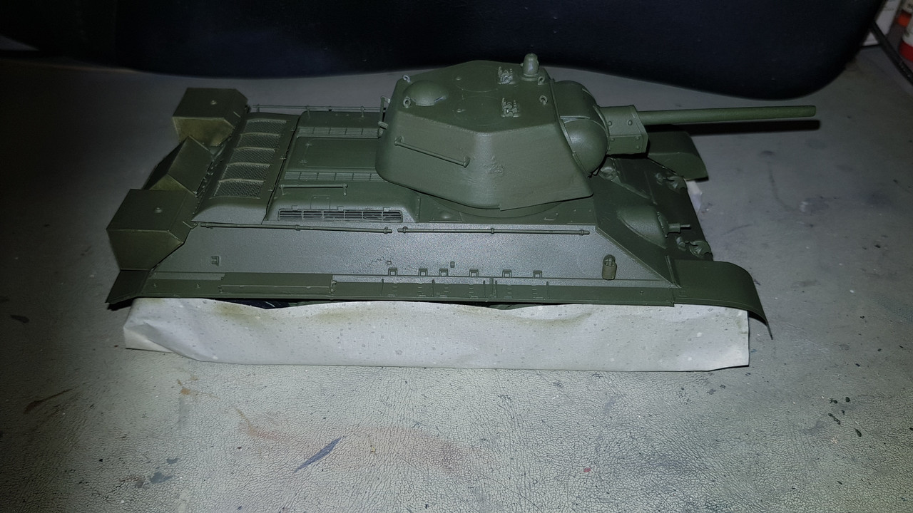

            Top coat is on, track is off again, ready for a coat of satin varnish after the decals go on Minor detailing left to do - spare track links, PE straps for these etc and then the vehicle will be complete but for the glazing. I'm putting the varnish on first so I don't have to try and mask itsy bitsy glazing pieces up. :) Yep - I am lazy :lol:
              Superb colour there Neil, just screaming for the weathering to begin :th:

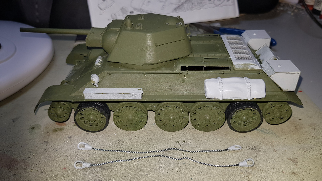

              Just got the extra track kinks and pioneer tools to go on - then, if I remember correctly its a coat of satin varnish all over before trying to apply weathering pigments!!
              Oh yes - and fitting the tracks permanently :)

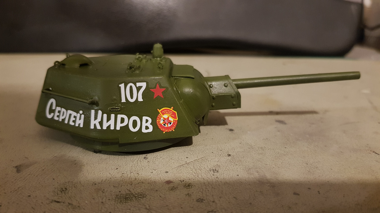

                Not heard back from Zvezda on the painting and decal guide but fortunately the back of the box has some good photos of the finished model so I used that decal scheme. Turret decals are now on ready for a coat of sating varnish. Hull still needs a bit of work in adding the final track packs and a bit of final detail painting once they are on.
                Rear number is still wrinkled from the Microsol in the photo - it has smoothed out but a bit of white paint may be needed for a touch up. Had to remove the rear grab rail to get the 107 on. I'll replace it when the turret has the varnish on.

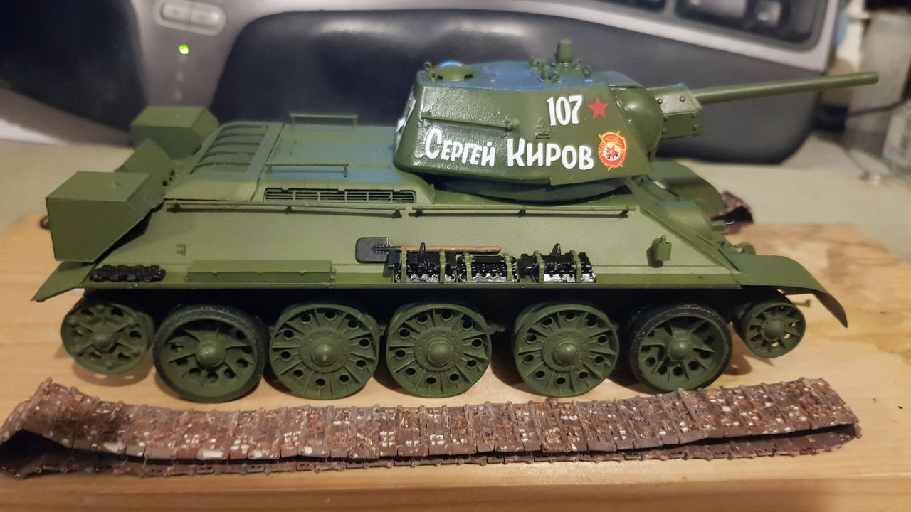

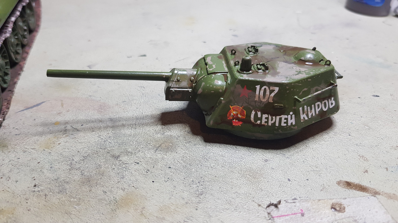

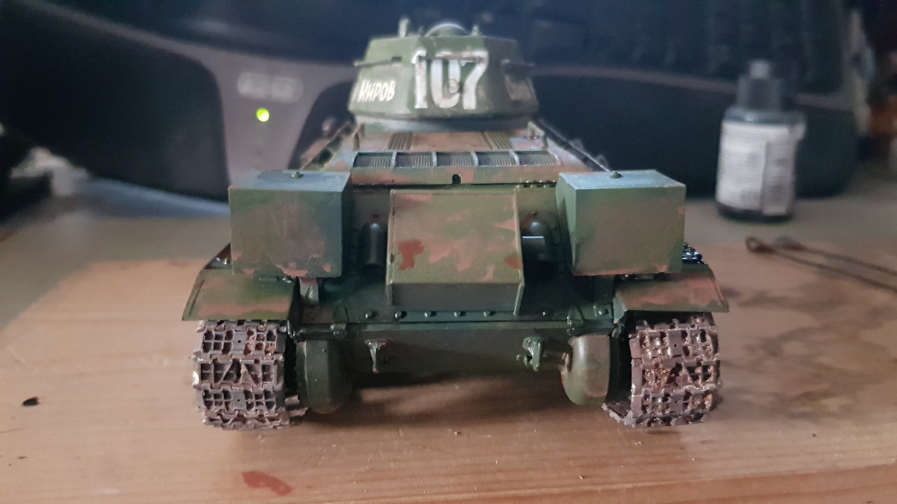

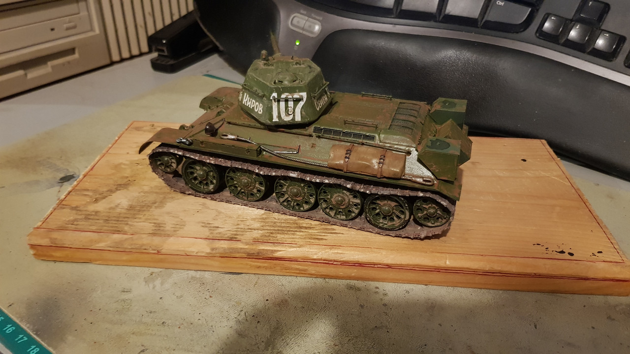

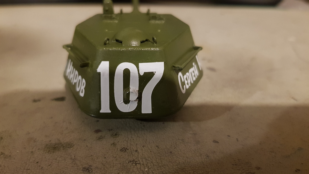

                  Tracks on, decals on - trying my hand at weathering now... Trying being the operative word......
                  Got to get a crack on as the NHS decided after a massive 6 weeks I'm no longer a "critical risk" and Amazon have recalled me to work on the 1st April (auspicious start back date)......
                  Using the Ultimate washes - its odd - in places its just balling up like rain on a windscreen rather than coating. I gave the T-34 a coat of satin varnish before hand - should I have used matt instead??

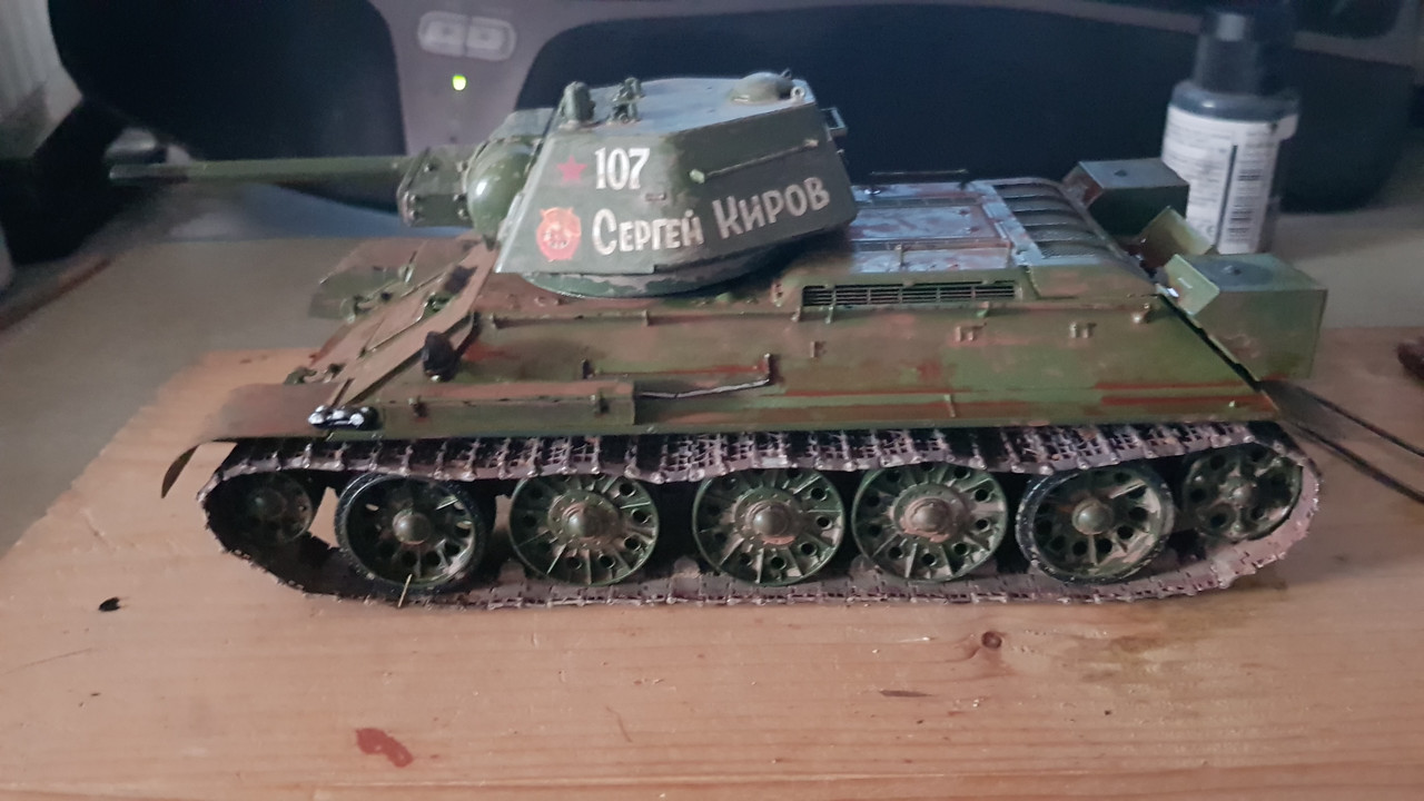

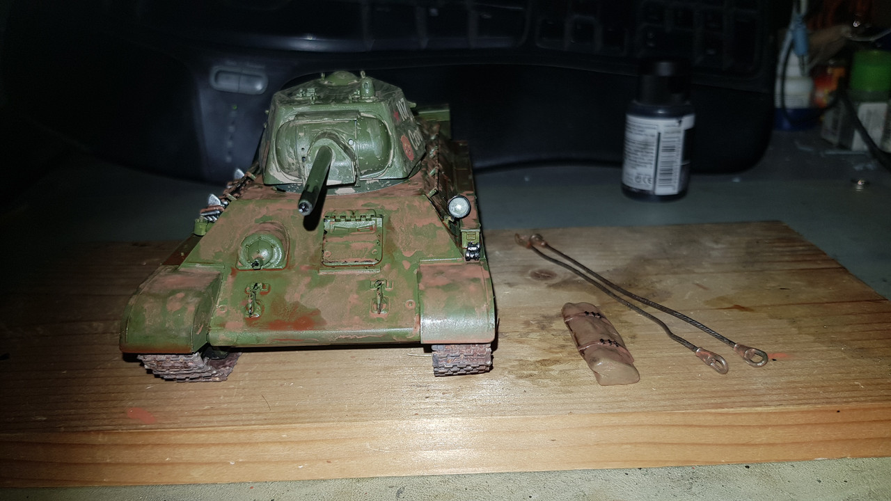

                        OK - got some of the VMS Smart Mud on order as it seems best suited for my needs. I think the Sculptamould would be better for "bumpy" scenery (and I have some ideas there involving a D30 Howitzer...)
                        Meantime I had another go with the Ultimate washes today. I used the "Mud" one all over with Vallejo "Dark Grey" on the muzzle to simulate the soot from the cannon firing. Hull still needs to be rubbed down with a wet cotton bud still. You can see the piece of wood I want to use as the diorama base. :)

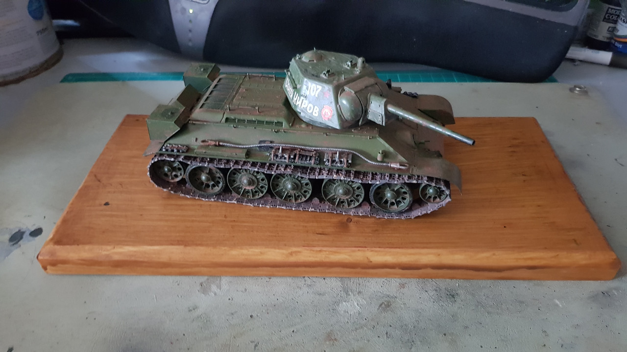

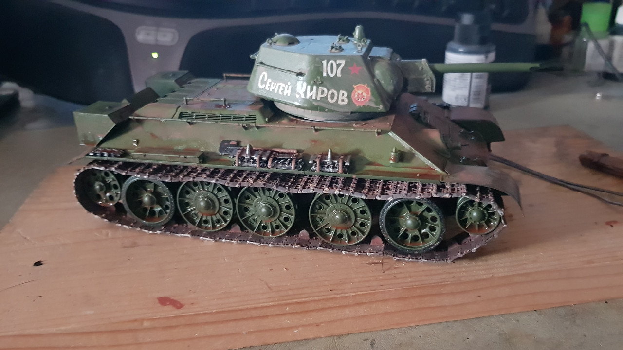

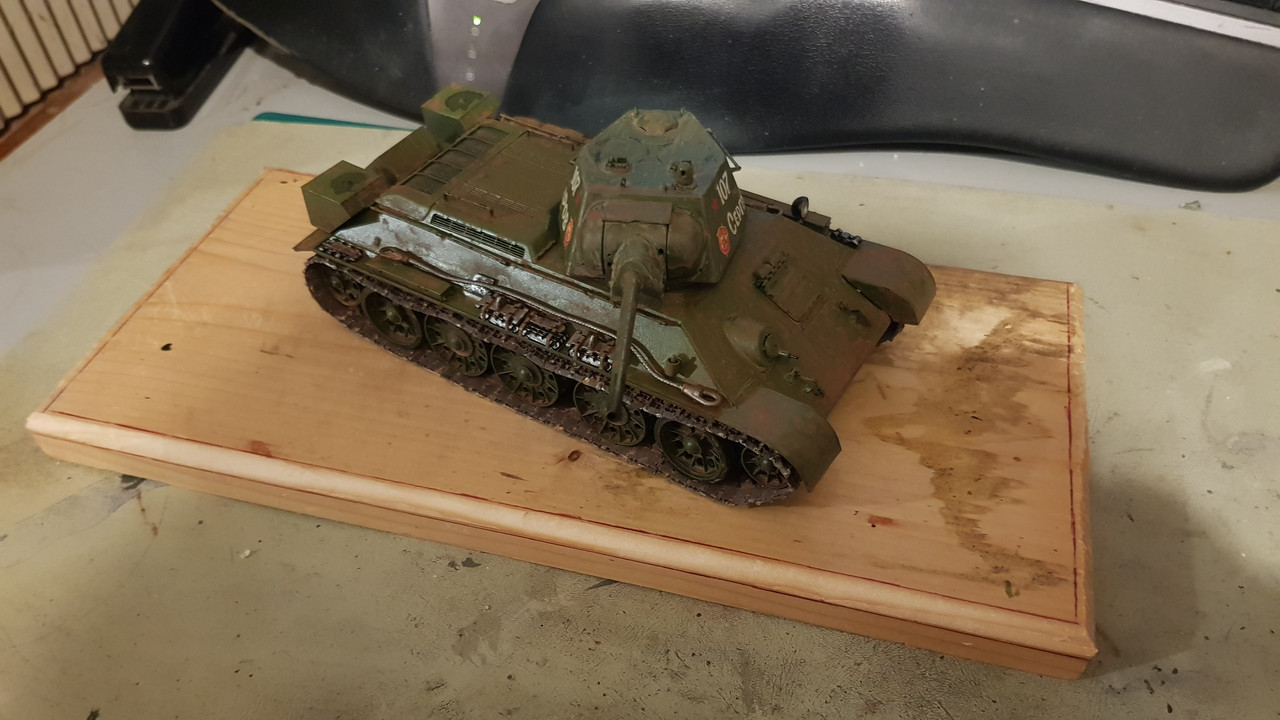

                          Well.... I am calling the vehicle itself done for now. I just need to finish chamfering the edges of the base, give it a coat of varnish and then I ordered some Smart Mud to finish the diorama.
                          Got to admit those Friul tracks were worth the aggro - they sit and sag just right.

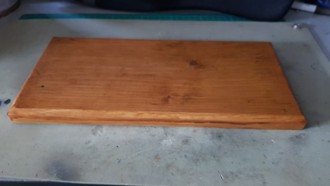

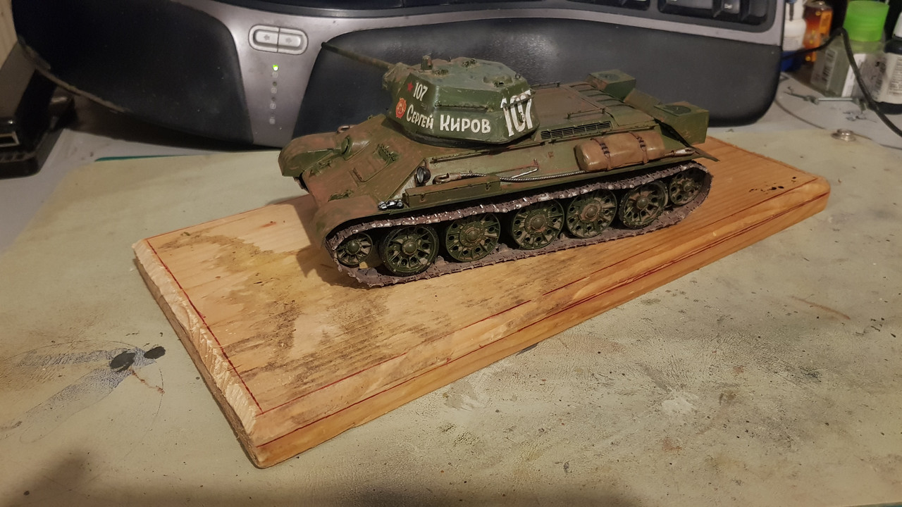

                            Little bit done today - got the base finished and given a couple of coats of varnish.
                            Most of the day spent going over a surveyors report on the place we are looking to buy - they had a grade of list of 1- OK - green, 2 - needs works soon - orange and 3 - red - critical. Most of the report was a lovely orange colour... :( :( Hopefully - he says with everything crossed - most is just the surveyor doing CYA 101.
                            Luckily we are buying through a firm called Homewise and they actually will own the building so they have a VERY vested interest in making sure its all OK and are dealing with the vendors.
                            Anyways - this is the base done. The Smart Mud also came today so tomorrow I will have a stab at that. :)
