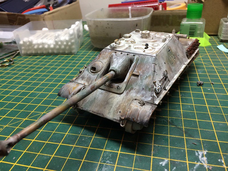

After a week of lack of interest on my part I got a proper session in yesterday. First up was a wash on the wheels. They'll get a matt coat and dirt treatments but they're ready to go now.
Then the fun began. I applied Ultimate dark dirt wash on the hull, forgetting the wash needs to go on to a gloss coat not a matt one in order to clean it off properly. As soon as I applied it I knew I had royally screwed the pooch! I started with the frontal armour plate and the wash sucked down straight away. I tried cleaning it off but it immediately started to lift the white wash right off the paintwork. I applied more water to dilute the stuff as it sat on the hull and removed it with broad sweeps of damp tissue paper.
Judge for yourself but I think I managed to save it. The result (in my boggled mind) is a vehicle that has been out in the elements for a couple of months longer than I had initially envisaged.
One thing - I need to take more wash off the roof of the fighting compartment as it doesn't match the rest of the hull at present. Shouldn't be a problem :doh:
I learnt my lesson after the frontal plate so applied a more diluted wash and wiped it off straight away. It still reduced the white wash but I needed to do that in order to match the frontal plate. It least I felt I had some semblance of control after the horror show at the start.
I applied a light rust to the grills as I figured the entire vehicle needed to look tired. This effect will be added to with real heavy pinpoint rusting with oils.
The black dots are the shell hits which will get properly rusted and streaked with oils.
Happy with the rear end after using the same process.
Tracks and wheels on. The tracks are only primed at the moment. They will come off again for primer touch ups then rusting and finally a dry brushing to bring out all that lovely detail. Point of interest - I double checked I had used the right number of links but both sides were way too slack. One link was removed from both sides and they tightened up nicely. Maybe I had glued the idler too far forward. I cant honestly remember if it was moveable or not.
I like these next 2 pics. They say I have a JP, your argument is therefore irrelevant! :lol:
Dirty JP, bad JP :lol:
Up close and personal
Next up is oils for rust and stains. She's sat on the bench, daring me to do it!
