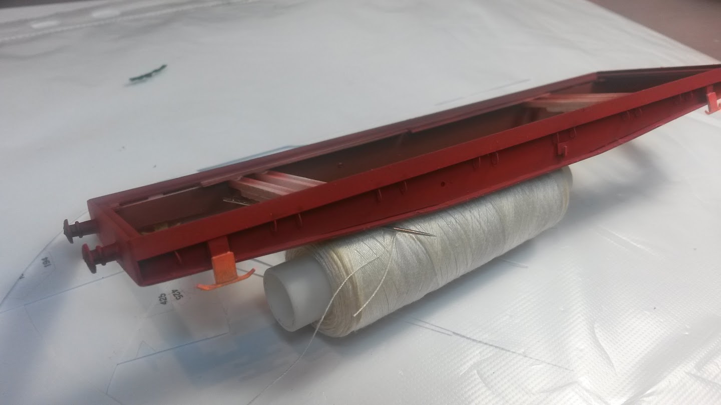

Guess what happened Friday! The postman arrived and brought me a package from England.
A flat car in OO scale (1:76)!

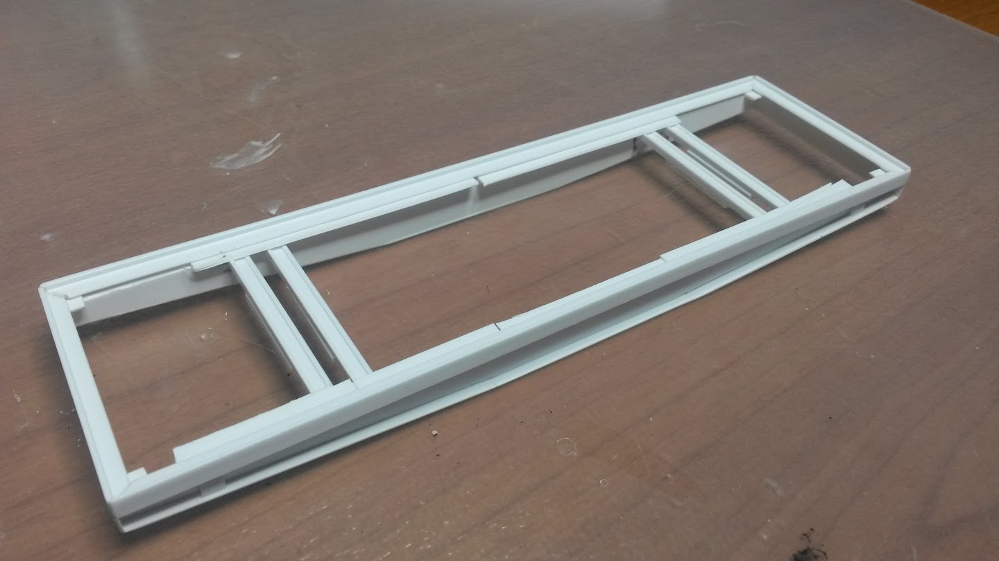

But there is a small problem with it:
it isn't wide enough :doh: - and a bit too long also...
I could build a wider platform over the existing one, but it would look "funny". So I think I'll keep the boogies and the bumpers, and build the rest from scratch. This is the vision:
Now I'm looking for details about it's dimensions.
Does anybody have experience in scratchbuilding such flat cars? :roll:

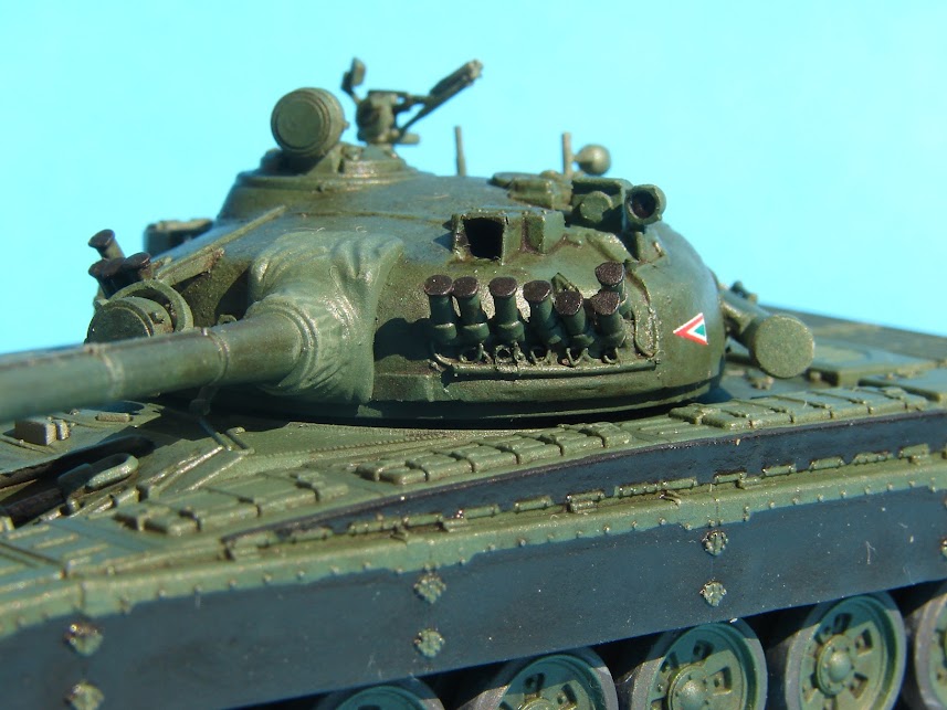

Ladies and Gentlemen!
I announce the tank to be completed! :banana:
I have 2 more month the complete the diorama. Currently I'm not entirely sure that I'll be able to finish it. If so, I always can fall back to this stage, and make a final reveal.
Here it is:
The turret with the cast texture, hand made wiring, viewports:
Muzzle-cover (guess what is the material used to imitate fabric*)
(* toilet paper! :) )
Upgraded exhaust:
Shining rubber skirts:
And two more:
Now I have to go pack, we are going to a wellness-week. So no modelling for 7 days... :cry:
Until then please leave comments and suggestions! Thanks!

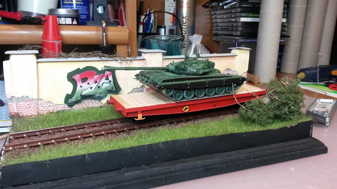

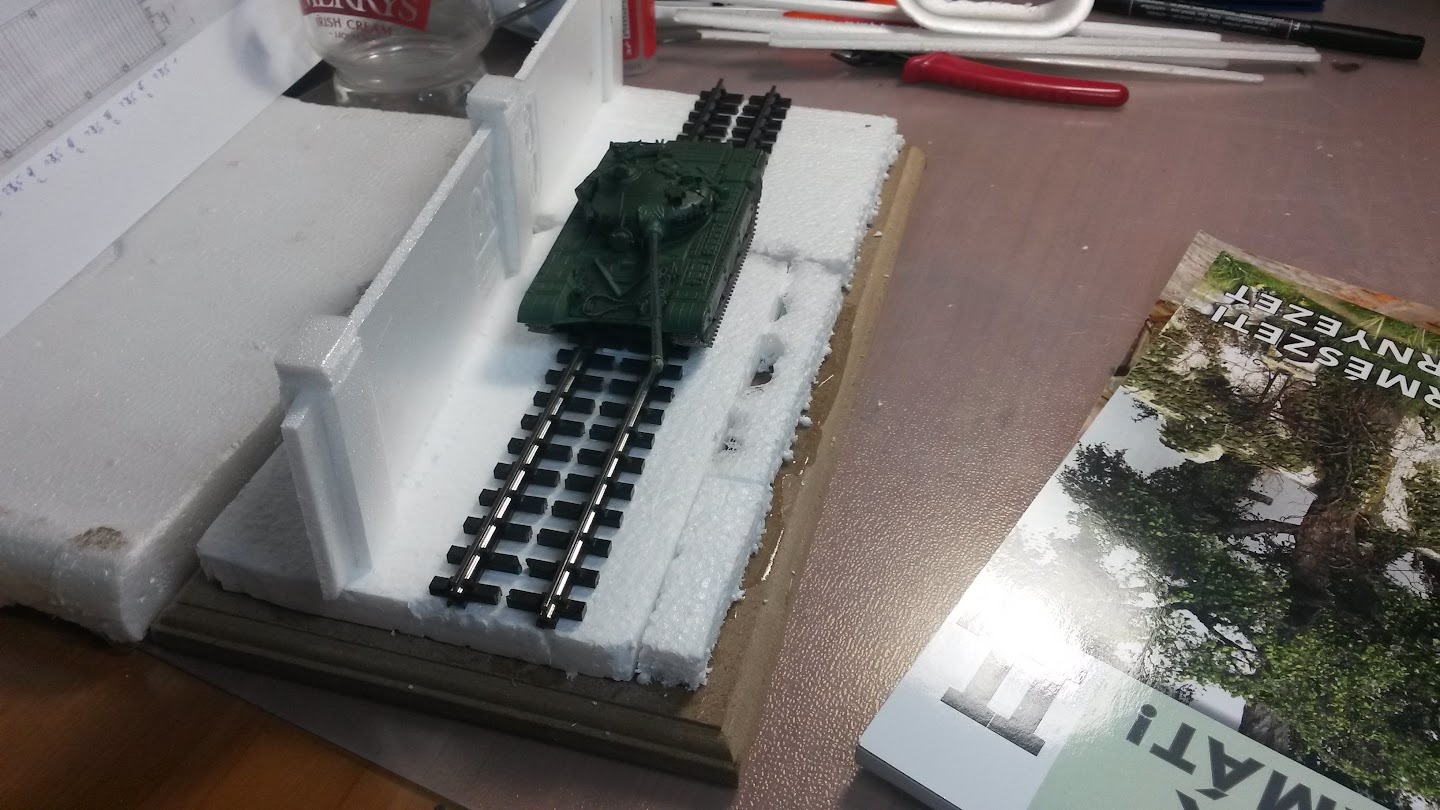

I am working on the diorama. I plan to put the tank on a railway flat car, and put some brick wall behind.
Something like this:
I continue the building in 3 parallel sub-processes:
- the flat car
- the brick wall
- the ground and the tracks
So stay tuned, updates are coming! :)

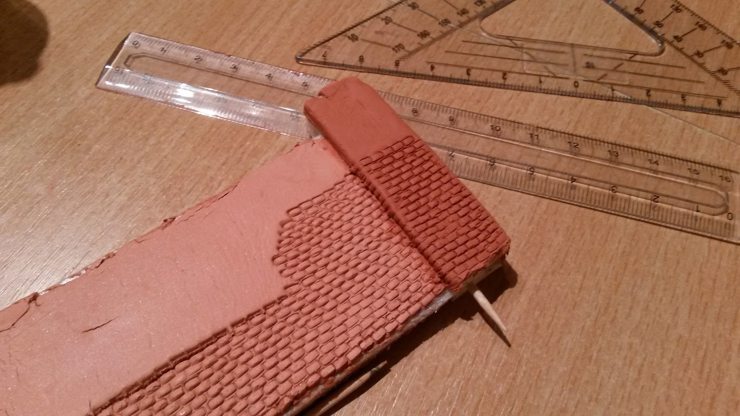

BRICK WALL
I want to add the wall in a slight angle to have more visual interest.
I used polystyrene foam as base. I found the raw material in the kitchen :th: :
I have covered it with modelling clay. Terracotta color, to have a brick-like color.
The bricks are really small, 1x3 millimeters. So I created a tool using some scrap photo-etch frame and a toothpick. With this a bunch of tiny-little brick could be made, in a pretty random shape. The tool is just pressed into the clay, but not through it, so it won't fall apart.
And it was too much job to shape those brick. Modelling used to be fun, and at the end it wasn't it at all. So I decided to add bricks only to the bottom. The upper part will be covered with plaster, like here:
The clay was fixed to the styrene with highly diluted wood glue. It took a day to get it dry.
Thanks to the wet glue the clay can be modified easily on it's place. The leftover can be stripped down:
For the columns I used a different approach. I glued the clay first, and created the brick only after that.
Here I am now with the wall. I need to sand it a bit, give some color variation to the individual bricks, create the plastering, paint it... so there is a lot of stuff to do.

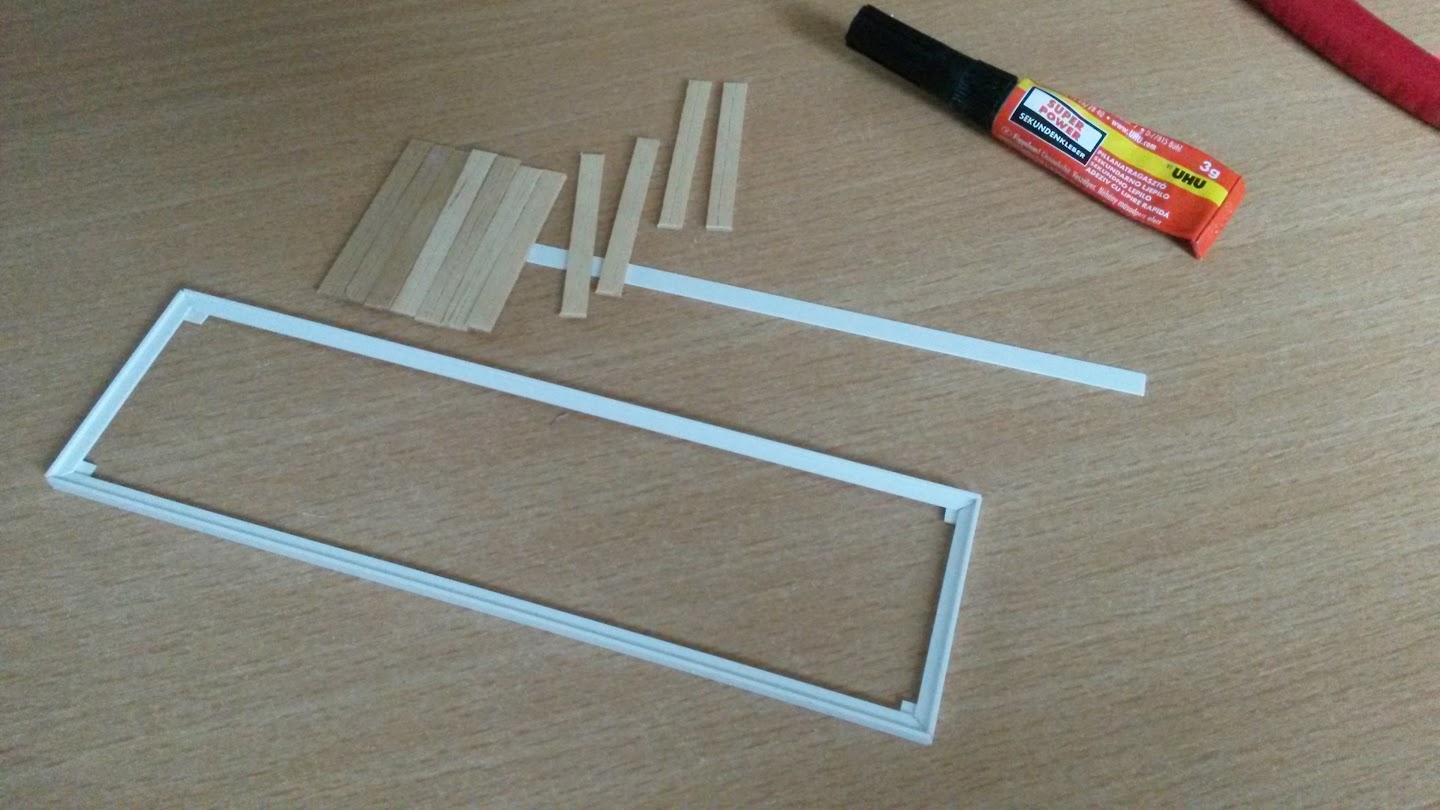

FLAT CAR
I decided build my own flat car, mainly using Evergreen and Plastruct plastic stripes. For the wooden upper deck I visited McCafé, and "rented" some mixing sticks... :) Cut them to length, and glued onto a plastic piece with superglue.
In the same way I built the bottom part.
I had to rebuild the boogies, too, they were not wide enough compered to the Hungarian standard. I cut the frame into to piece and glued them together again using styreen and superglue. I also cut the wheels into half, drilled 1.5 mm holes into the axis, added a copper wire, and finally covered it with two-component Milliputty.
This is how it currently looks like:
I already added some more details to the side. It will be primed with a rusty color, and painted with red and black. Currently I'm hunting decals.

GROUND AND TRACKS
First I wanted to glue the base pieces with superglue. Guys, don't do that. The foam just disappeared. :)
I added some elevation to the tracks, and cut them to two parts, because it wasn't wide enough according to the Hungarian standards.
Finally I glued some cardboard to create a flat side, and a small edge to hold the stuff I'd like to use as ground cover.
But now I have to wait until the wall is finished. Bushes, grass, gravel, all ready for application.

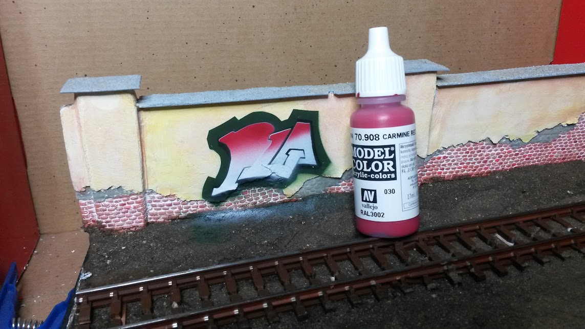

This was the fist time I made a wall by my self, and it turned out to be really nice. I'm very happy with the result. But there is one more thing I'd like to add: a graffiti. I was really afraid, if I screw up the wall, I'll have no time to fix it. So I was pretty nervous. I got the inspiration from a Youtuber, called Scale Model Medic. He made a really cool upgrade on a boxcar: https://www.youtube.com/watch?v=EefQ07lQD-4.
I wanted to have something, which represents me, and my Homeland country to pass to the GB's topic. :) I ended up having my monogram (PLA) in our national colors (red-white-green).
So I planned my graffiti in Gimp, printed in several scales, and checked with would look the best. Then I printed 8 more from the selected one. My wife gave me a transparent strirene sheet she uses for glass paints. The advantage was that I could see through it, so I could position the masks much easyer, no trick were needed like SMM made in his video.
I started with a dark green undercoat, which was used also on the tank itself: Military Green from Vallejo. I think it gives a nice contrast to the wall's yellow.
The next step was the black shadow for the letters, used Matt Black from AMMO
For the letters I wanted to have a nice, bright base, so the white was sprayed all over. (White primer from AMMO)
Vallejo's Carmine Red covers the upper parts of the letters. I positioned the masks a little lower to create a white shine on the top of the letter.
Resedagrün from AMMO gives the green color of the lower part. Again, masks placed a littlebit lower.
Some more details were added by hand (white and black dots with a toothpick, stars using a 5/0 brush), some cleanup on the edges, an the vents of letters P and A.
It looks much better than I expected! But next time I create the graffiti BEFORE I glue the wall to the basement. :wall: I had to put the dio in a vertical position to reach the area I wanted to paint.
I think the wall is ready! Next is to add some vegetation - where I still plan to do something new for me -, and to finish the flatcar.

First I added some static grass, but I'm not really happy with the result. If I would have time I would try to redo it. :(
I used 2 different greens to achieve some variety. But they were mixed up too much, you can hardly see the shades. And looks sooo "unnatural" :doh:
This spring during the maintenantce of the nearby playground I collected some fine roots. Using these and by adding some foliage by "Noch" I created some bushes. I do not want to seem conceited, but man! This bush rocks! :clap:
I added some more roots to the back of the wall to create a climbing plant.
For leafs I used the seeds of birch. Leafs were primed with Revell Laubgrün, upgraded with B Resedagrün and Dunkelgelb from MIG.
Unfortunatly I didn't have enough seeds to cover the whole plant, so one half is of the plant is dead, dry. :roll:
Finally some gravel has been added to the tracks.
The black frame got wavy, covered by earth and grass here and there, this needs to be cleaned up. Maybe in the remaining few days I find some solution to my grass problem. But if I fix the frames, the dio is ready.
The flatcar needs some weathering, and the T-72 needs to be tied to the flatcar. This is all that remains. There is now a chance to finish this project in time! :dance:
