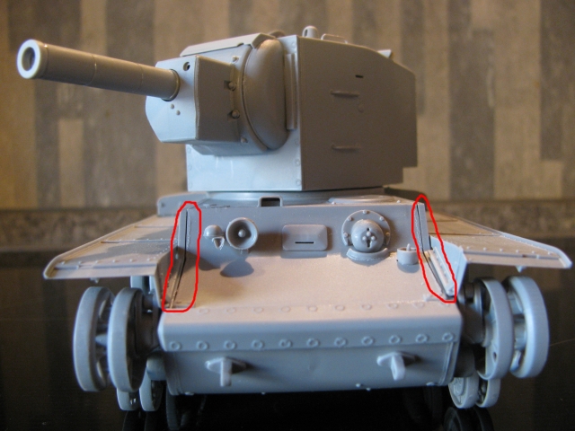

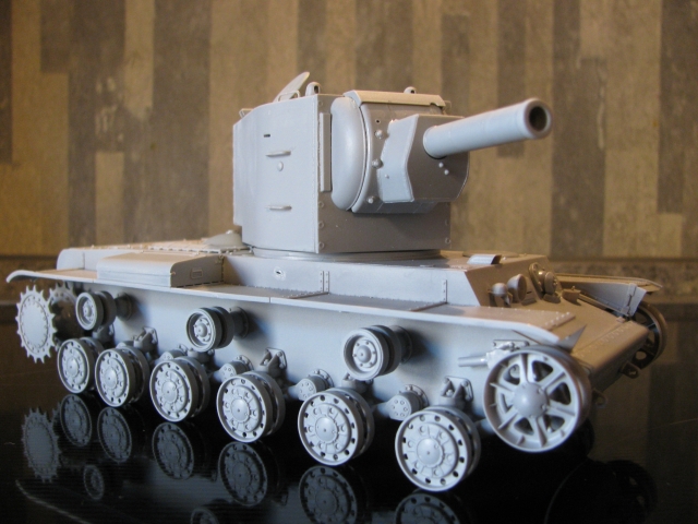

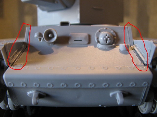

fellow modellers!
here's my 1/35 trumpeter kv-2. I'm really looking forward to painting and weathering, but first I have to solve some problems concerning gaps marked with red color. do I need to fill them? and if so, does diluted filler work? thanks and lets hope I can post some updates soon :hi:

I have this Kv2 currently under work and encountered the same problem. Dindnt fix it yet though. I was planning to use Mr. Surfacer to cover this gaps- Maybe someone more experienced can give us some advice on this?

I came to the conclusion that the gaps need to be filled. but since there are 2 armor plates welded together, you need to rescribe a litte bit. and you also have to take care of the welding seams. hope I can post an update soon :crazy:

Thinned putty would work, but those gaps look a little difficult to access for application of the putty. It might be a good opportunity to use fine stretched sprue. Glue the stretched sprue into the gap, coat with more glue to soften the sprue, then add weld "texture" to the softened plastic with a toothpick or other similar tool. I'll be honest, I have not used the sprue method yet, as the thinned putty was all that was needed for my latest builds.

I would approch this by using dissolved putty (or Mr. Surfacer 500) to hide the seams and to buildup a fake welding seam on top of the existing one. To make it look realistic I would probably use thin strips of masking tape to make an hard edge on both sides of the weld. You need to stipple the putty with a brush to get that rough surface.

Great looking build so far, though I don't envy you for having to fill those seams right next to the welds.

it's been a while since the last update on this one. so I didn't care too much about the weld seams and just tried to fill the gaps as careful as possible. if you don't concentrate on the issue it doesn't look toooo bad.
