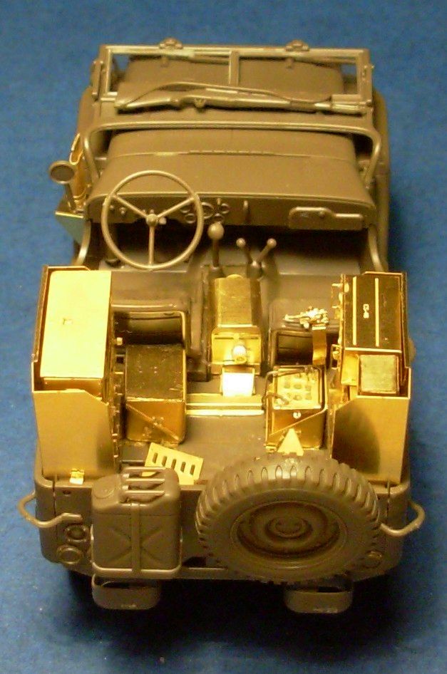

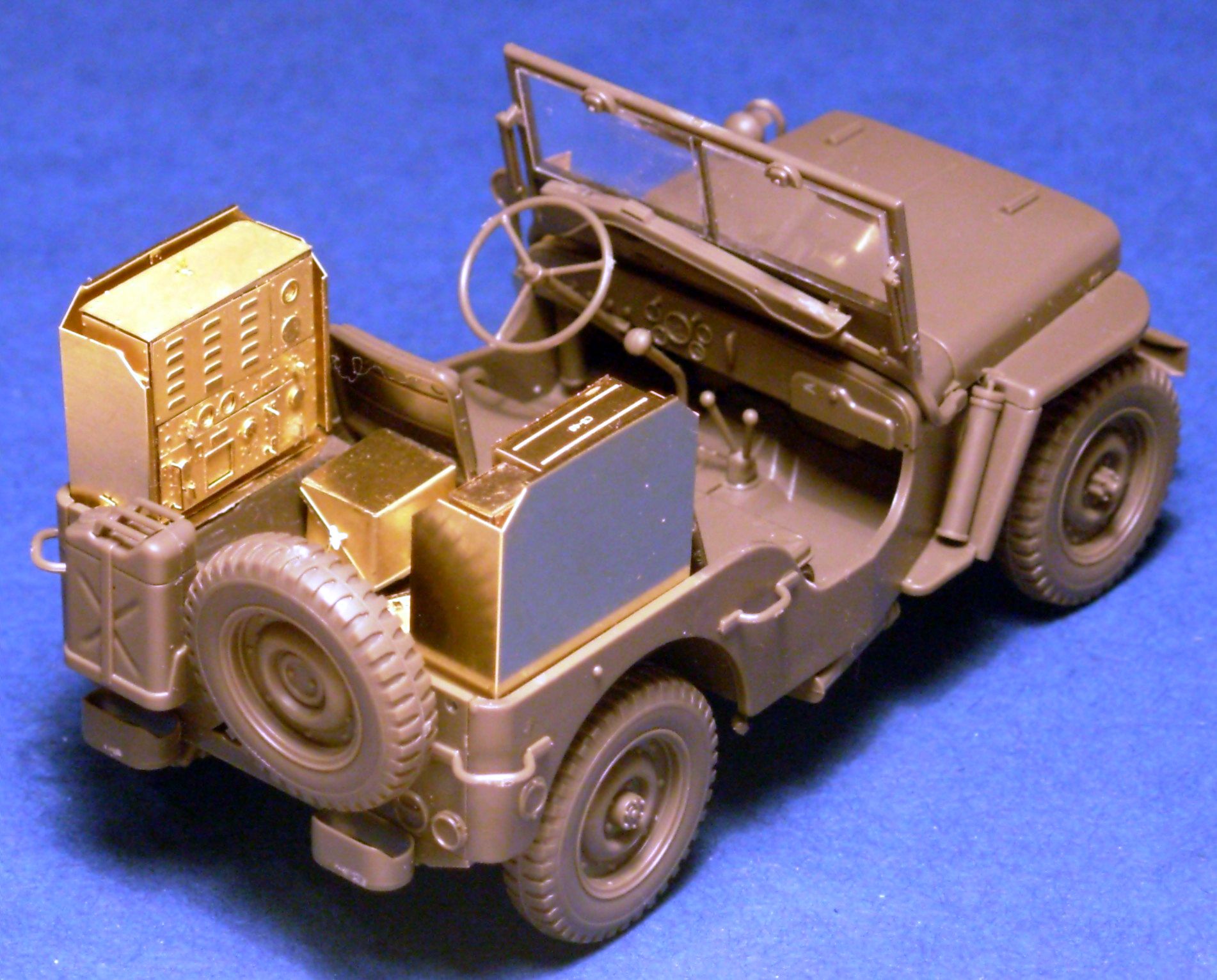

Managed to get some build time in again YEAH.
The body tube has got the ABER and Eduard Photo-etch treatment. Looks pretty sweet if I say so myself.
Waiting on a replacement PE set from Minor Models with radio equipment and a Power Off-Take. Done some digging on the internet and found the old TM's applicable to the radio installation I'm intending to replicate.
Also started to add some scratch detail to the body sides. More to come as the Italeri kit I'm using as a canvas is lacking detail in all the places where we now expect to see them.
Right body reinforcement plate made from 0.1 mm ABS Sheet. The uprights are 0,1 mm thick and only 0,4 mm wide o what fun I had making these.
Here is the end result on the left side of the body.

I did some googleing into follow me jeeps I found some more information and some cool pictures I would like to share with you.
Follow me jeep from the 8th Airforce 381 Bomb Group 532 Squadron 7th vehicle on the inventory.
This is decripted from the unit code on the bumper. For a previous build I did a lot of research into unit identification bumper codes on US vehicles in WWII.
After finding out that there where also Follow Me jeep equipped with both VHF and HF radios. I thought it would be a nice touch to ad these to my build. This to create some interest into the rear of the jeep which would have been an "vast" empty space as the did not get filled up with all sorts of stowage you would normally see in the back of a "normal" operational jeep.
This lead to me doing some research into the radio equipment carried onboard USAAF jeeps in WWII. I found out that the set in the second picture was actually the AN/VRC-1 radio set. with this information I started looking into getting either resin or PE radio equipment for this build.
It seemed like an almost impossible task and I almost gave up. That was until I stumble onto something that could just be the ticket I was looking for while I was doing some retail therapy for another build. To my surprise there where the radios I was looking for for almost a month staring me right in the face :O. To my delight the where made in Europe by Minor Models in Spain and the model shop even had some in stock.
After a couple of days waiting these two sets show up. Happy Chappy until I found out the radios wouldn't fit the cabinet which I was planing to use.
More google investigation was performed by myself and I found digital copies of the original TM 11 field manuals pertaining to the radio equipment. Bonus. Now I was really cooking on all boilers again. I also found some better photo's of the equipment and the radio rack cabinet.
Front view.
Rear view.
Rear view right.
To my horror I found out that there was a second spare tuning unit fitted inside the cabinet O O and that there was also a strange box in between the driver and passenger seat in the front.
That turned out to be an Electrical Power Off-Take which contained a second Dynamo to power the radio equipment. And these where not included in the original radio set I had lying on the desk. To ad to the agony even more the required radio set was out of stock at the shop where I got the previous sets. So off the manufacturer to do a direct purchase of the required set.
It did not however contain the correct cabinet which I found out to be a CH-217. With that bit of information I called out the people of keep them rolling a WWII vehicle special interest group that has all sorts of real WWII vehicle owners as its members. And they gave some leads to where to go to get the required information.
Well that's all for now, als always happy modeling and keep sticking styrene.

Managed to some more stuff done yesterday and earlier today so its time to share some more pictures.
After putting in the reinforcement brackets on the side walls it was time to also add the drivers and passengers side padding. As this was not in to kit (well what did you expect form a 1979 original release ;) ) It was out with placticard again and some reference pictures this is the end result so far.
The passenger side.
And the drivers side.
As I'm still waiting on my second radio set to arrive work on the cab came to a halt for now. With this in mind it was time to start tackling the chassis as this was also getting the Aber and Eduard Photo etch treatment.
The frame as it came off the sprue. As you can see its riddled with ejector pin marks, the front and rear bumpers are solid casts and the bumperets are out of scale. Out with the razorsaw and Ultimate sanding sticks for some plastic surgery.
This is how it looked after the cleaning and offending parts where removed. The front locating holes fort the front springs where filled using some Evergreen rod that was glued in place with the new Tamiya extra thin quick setting. I opted for this method as these holes will not be needed and was the easiest way to fill such a small hole.
Now that the frame was prepared it was time to get the first photo etch on.
The front bumper, attaching brackets and front body mounts.
And the rear bumper.
The frame was test fitted on the body and found there was detail missing and that there would also be an fitting interference in the rear. Some of the detail that was missing was: The frame to body reinforcements strips where missing from the bottom of the bodyshell, The rear wheel-wells where missing the aft end on the internal wheel-well. As this part forms the bottom of the rear cabin stowage cabinets and are visible with the wheels installed it was time for some more scratch-build placticard alterations. As this was going to be a complex one peace shape I first made some templates from some thin colored cardboard.
The templates where then transferred to 0.2 mm plasticard and glued in place with TET and sanded back to alleviate any fit interference.
This how it looked after the wheel-wells where reconstructed.
The reinforcement strips where cut out of plasticard and fitted.
After these where fitted the frame was test fitted again and I discovered a fitting interference that would lead to a large gap between the body and rear bumper. This was caused by the bottom corners of the rear body square reinforcement plate hitting the tow hook sub-frame. Some X-acto chisel blade cuts soon sorted that out. Here's the after shot.
That's all for now on this installment of my build thread. Thanks for stopping by and reading what I have been upto.
As always happy modeling and keep sticking styrene.

Now the interior was sorted out (up to the dashboard) It was time to turn the my attention to the outside of the body
The mayor bits of photo etch fitted to the rear also re-scribed the Panel lines. It was my frist time doing this with the Tamiya Scriber II os it might look a bit iffy ;)
I scratch built some webbing loops from 0,3 mm copper wire but they where way off scale and looked wonky after I had fitted them and had a good look. So after a bit a searching in the instructions of both the Aber and Eduard PE sets I have for Jeeps found that there where a couple 6 included after all :wtf: :crazy: Gotta love PE instruction sheet right :lol:
Those looked a lot better, but it was a good thing a had a couple of Aber PE sets... Because of the size some when't flying, others got twisted, mangled or destroyed when making the up whit my Tamiya Photo etch tweezers.
Now the rear end was done and dusted time to do the sides. The right side was easy enough as it was only getting the reflector on the rear and the windshield reinforcement plate. The left was a different ball game as the most visible vehicle tools are stored here (Axe and Shovel)
Here it is all fitted, the sheath for the axe was a workable type and was a bit of a pain to construct and formed. The three loops for the webbing straps where now less tricky but ended up using 10 out of the twelve I had at my disposal.
Rear side view of the side detail added.

Thanks Frans and Tommy, the radio's are all done. Found out that the cabinet was about 3 mm off in hight and 1,5 mm in width after seeing some good reference photos via a historical military car club. So to add to the stress I'm rebuilding it.
Stay tuned for more before I can do my final reveal

Time to start on the Radio's that where going to be housed in the large cabinet I had made to fit on the back.
So back to folding and soldering PE and scratch building again. After two long night this is what I have made.
The HF radio's where all contained in the PE sets from Minor Models. The VHF radio's where not however. I knew this already so I had managed to get the digital copies of the TM11 handbooks needed. After a couple of hours I had them on the desk.
The Transceiver and Dinomotor for the VHF made from 0,5 mm sheet styrene and rod.
Time for a dry fit in the cabinet I had scratch built earlier. The radio's fitted but looked a bit crowded. After seeing some more pictures of the real thing I noticed that the cabinet was a bit on the small size. This was confirmed after I got a reply from a member of Keep Them Rolling (A Dutch Organisation for owners of WWII vehicles) got me the dimensions and a ton of detail photo's of his Radio Jeep.
As this build had spun into a full detail build anyway I redid the cabinet in a night.
Now that I had good reference pictures at my disposal I could also add the finer details to the top of the cabinet.
The size difference between the old (forward) and new (rear) cabinets. 0,5 mm in depth and 2 mm in height. It was only a small adjustment but it made all the difference.
