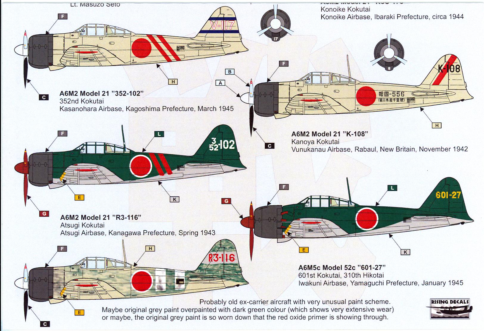

I will order this Rising Decals set to depict a Nakajima built Zero.

Below, are the aftermarket decals I'll be using. I will be building A6M2b "352-102"
