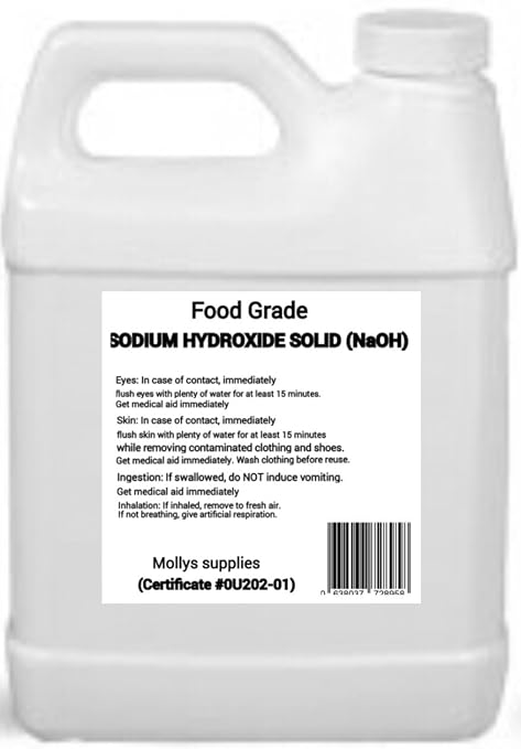

This is what I used. There are cheaper products, but I chose to get something that was more pure.
