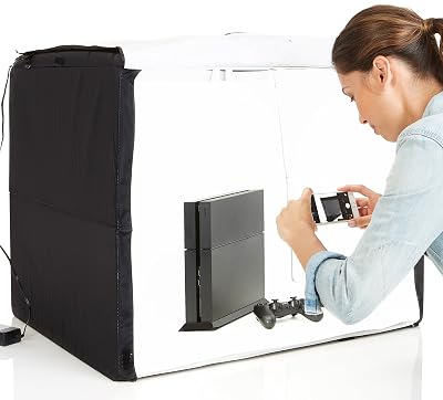

I have found that for modeling, a good light tent is very helpful. Many of us have made our own from foam board and strip LED lights. I did this at first but didn't have enough space to keep it setup. The homemade light tents don't usually stand up to well to being moved around. I bought one off of Amazon for a reasonable price. It is very large when setup but still folds down to a good size. It has a removable backdrop but so far I only have the white one that comes with the unit.
**Image links to Amazon.com
