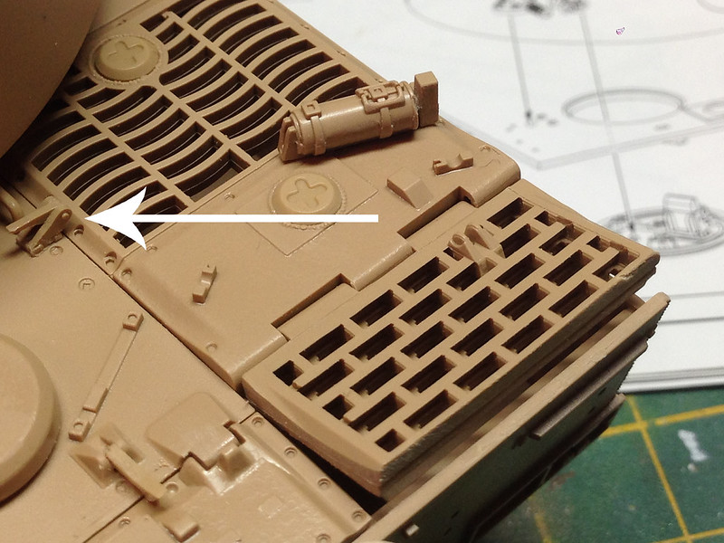

With the wheels essentially done, I turned my attention back to the deck of the Tiger. There is a ton of holes to drill for all of the tools and cables and whilst the instructions are clear, they don't match the underside of the deck. There are loads more marks than in the instructions and you have to be careful that you drill out the correct ones. Take your time and it should be fine, although, I thought I was being careful and I got one wrong. Don't you hate it when you get the wrong hole!!! :eeek:
The engine cover has some nice detail, but the engine hatch closure clamps are a total PITA!
Nothing unusual about how these go together. If my memory serves me right, Dragon tackle them in the exact same way, with three bits making up the complete part. The problem with RMT's offering, is that the tab on F7 is too big for the base plate, F6. More pesky seam lines again. The parts are tiny and you risk either losing them to the carpet monster, or scraping too much material off and the whole thing not sitting right. It took me about twenty minutes to do each one and when you sit back back and look at the finished article, you wonder whether it was worth the effort. I don't remember having this problem with other kits
Fitting the fan cover grills proved to be no less frustrating and once again, the culprit seemed to be the excessive pesky seams. They are just too wide to sit comfortably and you have to sand off quite a bit of material in order for them to fit. I would advise sanding the inner side of the grill as it will be easier to fill any "bodges", or mishaps. Hey! What do you mean it's only me that has bodges and mishaps! :tongue:
Don't get me wrong, I am enjoying building this kit. It's a Tiger, I would enjoying making it even if it was made out of dog crap! I'm just a little worried that if this was your first Tiger, or your first piece of armour, you might be put off altogether. The problems are minor and easily fixable, but you know what it's like, once you hit two or three in row, it can severely kill your mojo.

Carrying on with the upper deck, I decided to add some of the tools and gubbings. This is where I have to admit, I've made a bit of a schoolboy error. Before I started the kit I had a scan through the destructions, as you do, and I noticed that there was an option to add PE clasps to all of the tools. However, I had already dived in and drilled all of the holes for the moulded clasps. Oops! :oops:
No biggie. If the truth be known, I'm not a fan of PE and the fret that comes with this kit is very thin. Great for in-scale detail, but not great if you need any margin for error. Bend this stuff more than a couple of times in the same place and it will break. I know because I tried it! :wall:
One nice touch with this kit is that they provide both options with all of the tools. Both with and without clasps. So, that saves all that fiddly business of cutting the styrene clasps off.
There is also a very helpful diagram showing the placement of all of the tools and fixings.
However, the thoughtfulness shown in providing both sets of tools is soon negated by how poorly they fit. The axe sits slightly too close to the jacking-blocks for my liking, but it's not too bad. The shovel that sits below it however is just no good. It's too long for a start and overlaps the axe, but there's an even more glaring error.
See if you can spot the difference between this two photos.
That's right! The locating holes are in a straight line, but unfortunately, the lugs aren't. No problem, just remove the lug on the business end of the shovel and you're good to go. Well, your are once you've shortened the whole thing.
Cut a smidge off the handle and reattach and now you're good to go!

Update Eight
I've had this build side-lined for a couple of days as I've actually managed to start my entry for the Summer ScI-Fi build. With that all primed and ready for paint, I thought I'd turn my attention back to the Tiger. As the wheels are now painted, I thought, why not crack on with the tracks.
Here are my base colours of choice. Ultimate black primer and track primer from Vallejo Model Colour. The track primer looks grey out of the bottle, but it has a brown hue to it. Plus, I mix it with a generous glug of water so that it's almost a thick wash. Over the black primer this gives a nice worn dirty/rusty kind of colour. Plus, stippled on with a nice big brush, you can get an nice uneven finish to the colour.
As you can see, I've had my first guide horn casualty. I probably won't replace it, as once the tracks are installed, you probably won't notice. Also, in keeping with the well worn cry of AFV builders the world over, "Its battle damage!"
Thanks for taking a look! :th:
