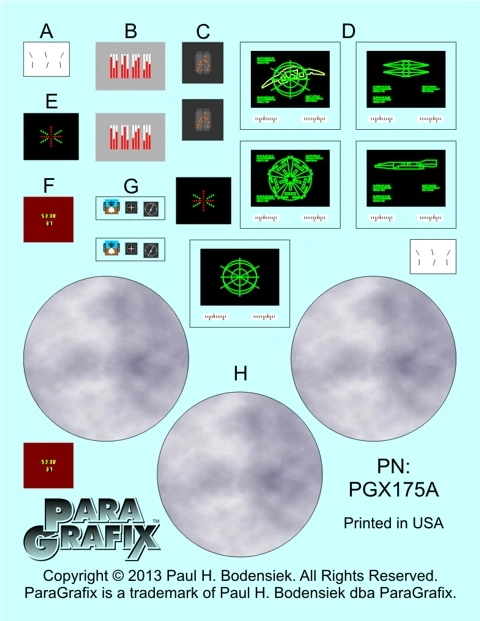

Paragraphix PE Detailing

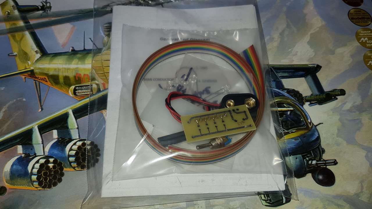

                  As stated on the "what the postie brought" thread elsewhere the first of the bit for this arrived today.
                  It got held up by BorderFarce for a few days whilst they whacked me with a £4+ VAT charge - and an £8 handling fee. To say I was considerably un-amused is an understatement (got me a bit worried as to what I'm going to get hit with when the other 3 items arrive from the USA).
                  But that's by the way - the kit is quite neat, comprises:
                  * An "On/Off" switch
                  * A length of ribbon cable
                  * A battery connector (9v PP3)
                  * 4 white LED's
                  * 1 green LED
                  * A circuit board
                  * Some white diffusion material to go behind the cockpit panels
                  * Some heat shrink tubing to cover the soldered joins
                  * What looks like a reasonable instruction leaflet.
                  At the moment its hard to tell how it all fits in to the kit but once it gets here I think it will become apparent. Mean time - I need to practice my soldering skills.... :) :)

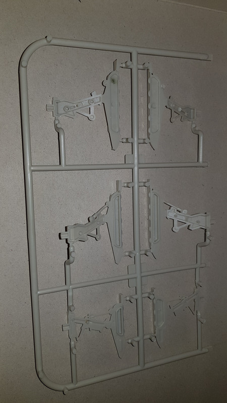

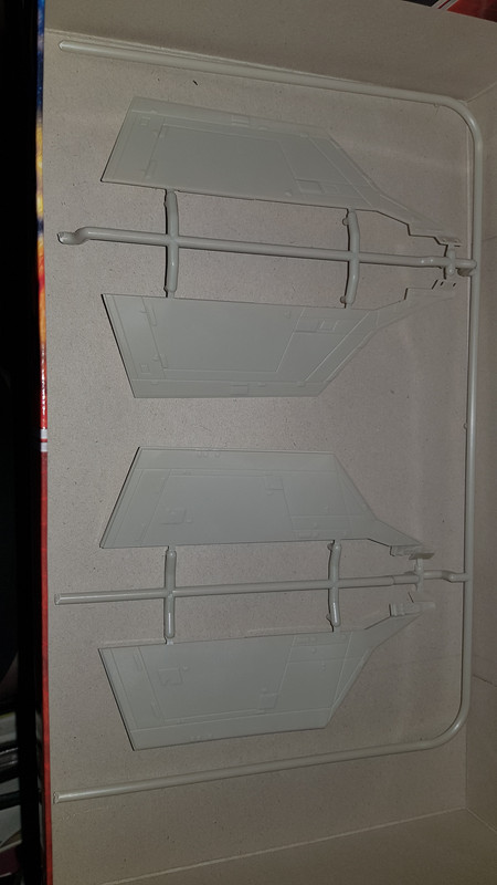

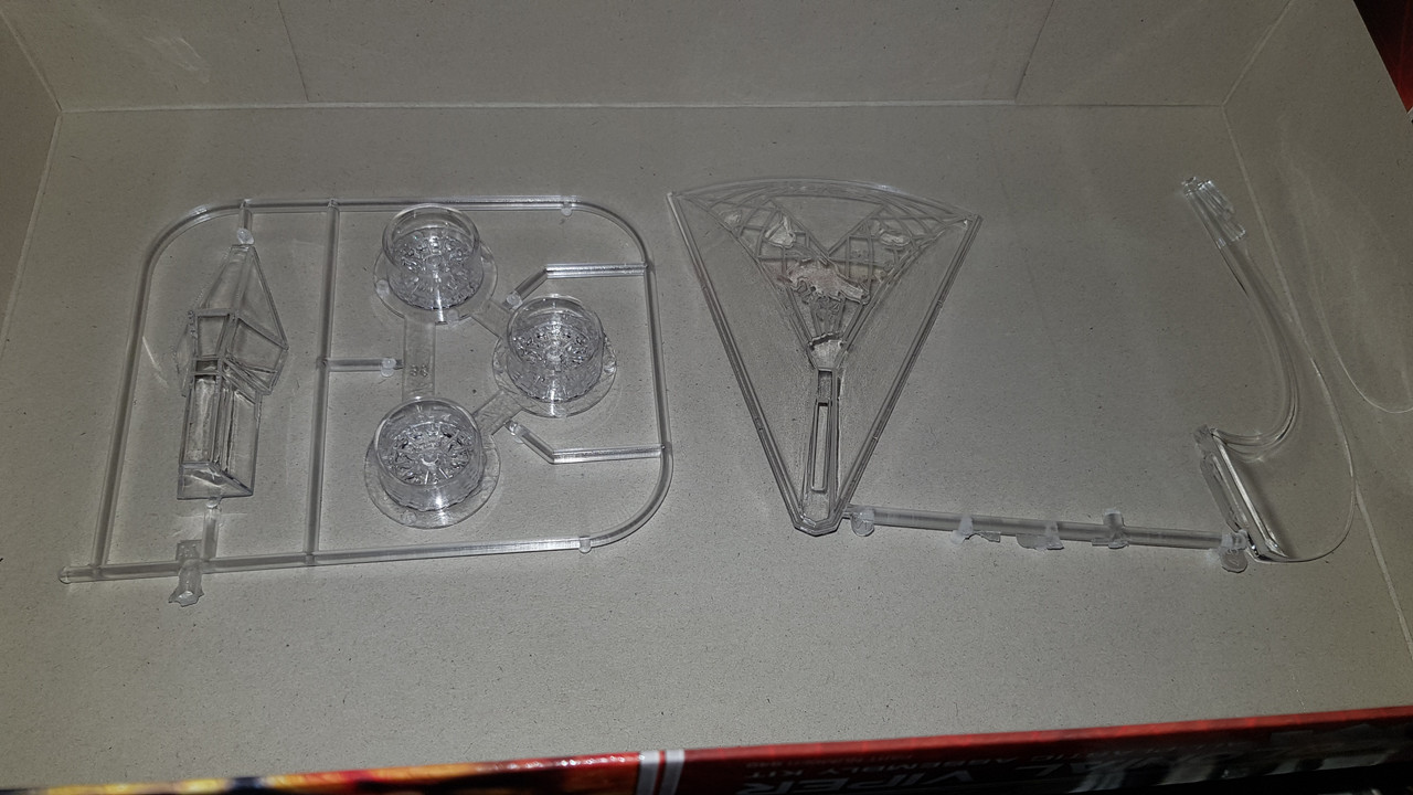

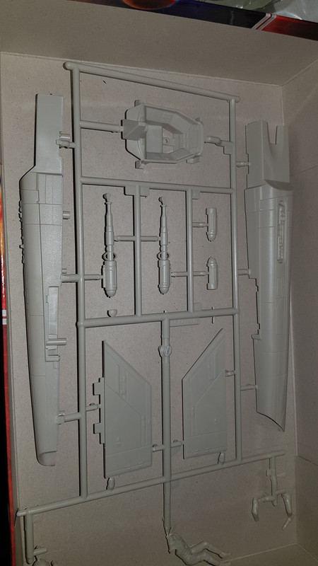

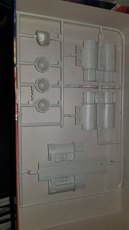

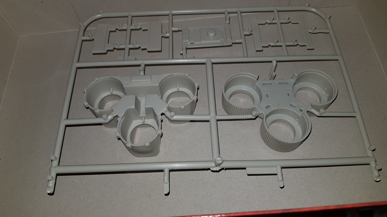

                            Right then - we have a kit to crack on with.
                            First off - the sprues:
                            Nicely moulded, no flash or visible ejector pins - looks like it will be a simple and pleasant build. Although appearances have been known to be deceptive. :)
                            First job then is to take the cockpit tub and clean off all the raised detail ready for the PE and hole cutting for the display films.

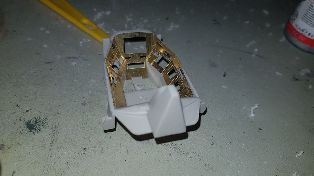

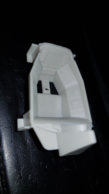

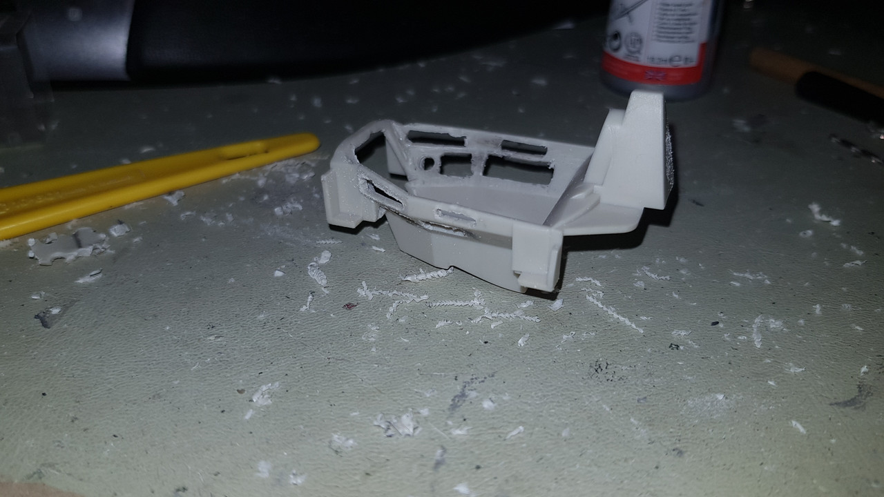

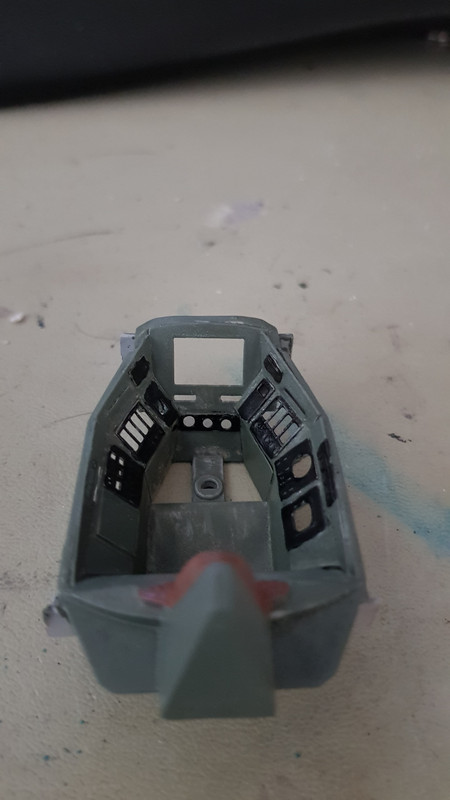

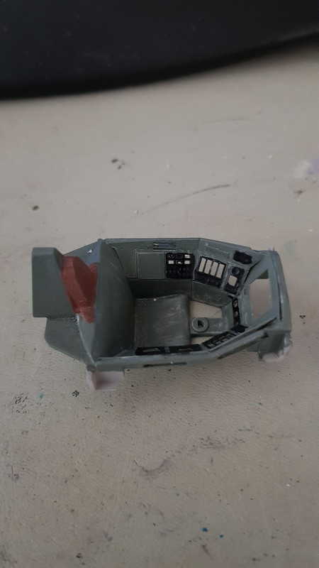

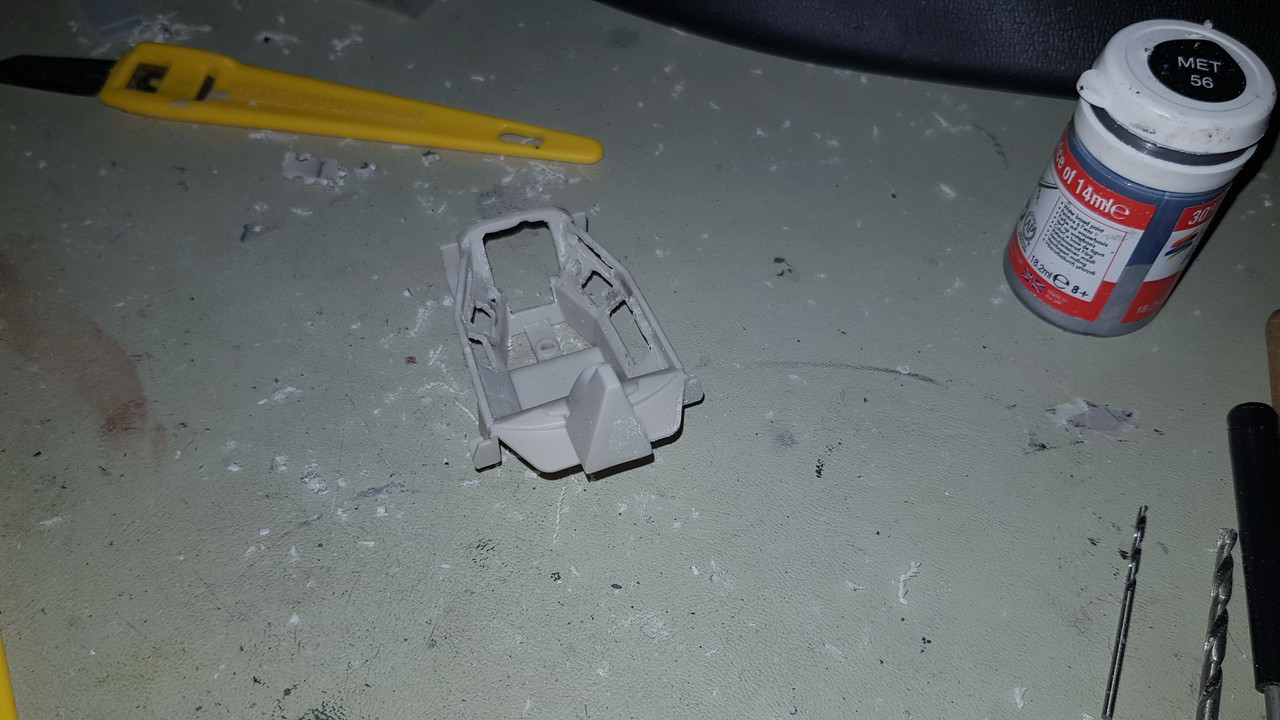

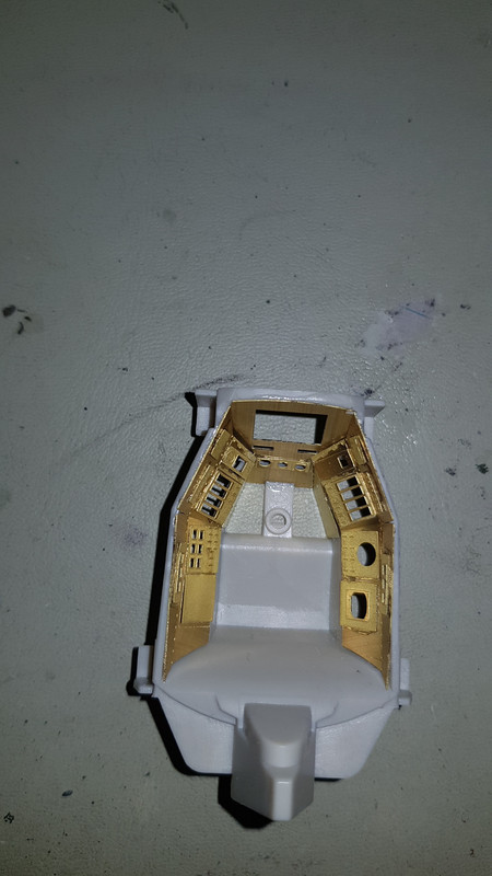

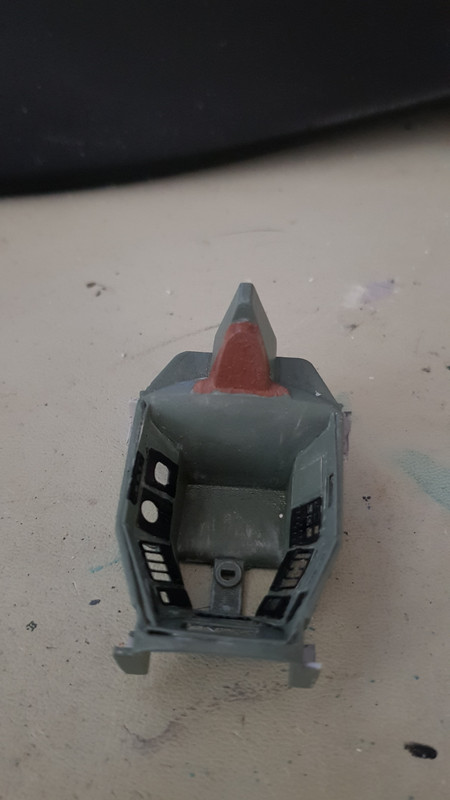

                              First step on this one was prepare the cockpit for the Para Grafix PE.. Sounds quite blase doesn't it?? :)
                              8 hours later my hands are knotting up with cramp and the job is done (old age is a right b*gg*r!!)
                              I started off with this:
                              Took about an hour to remove all the moulded on surface detailing on the instrument panels with a sharp knife and coarse/fine paper. The PE panels were then laid over and the various apertures marked out onto the now smooth surfaces 0 and the fun began.... (First time I've ever used PE and I was pleasantly surprised at how easy it was to bend the side panels to conform to the cockpit profile!!) Holes were hand drilled around the outlines and then the centres cut out - slowly - using the sharp knife until at last I reached this stage:

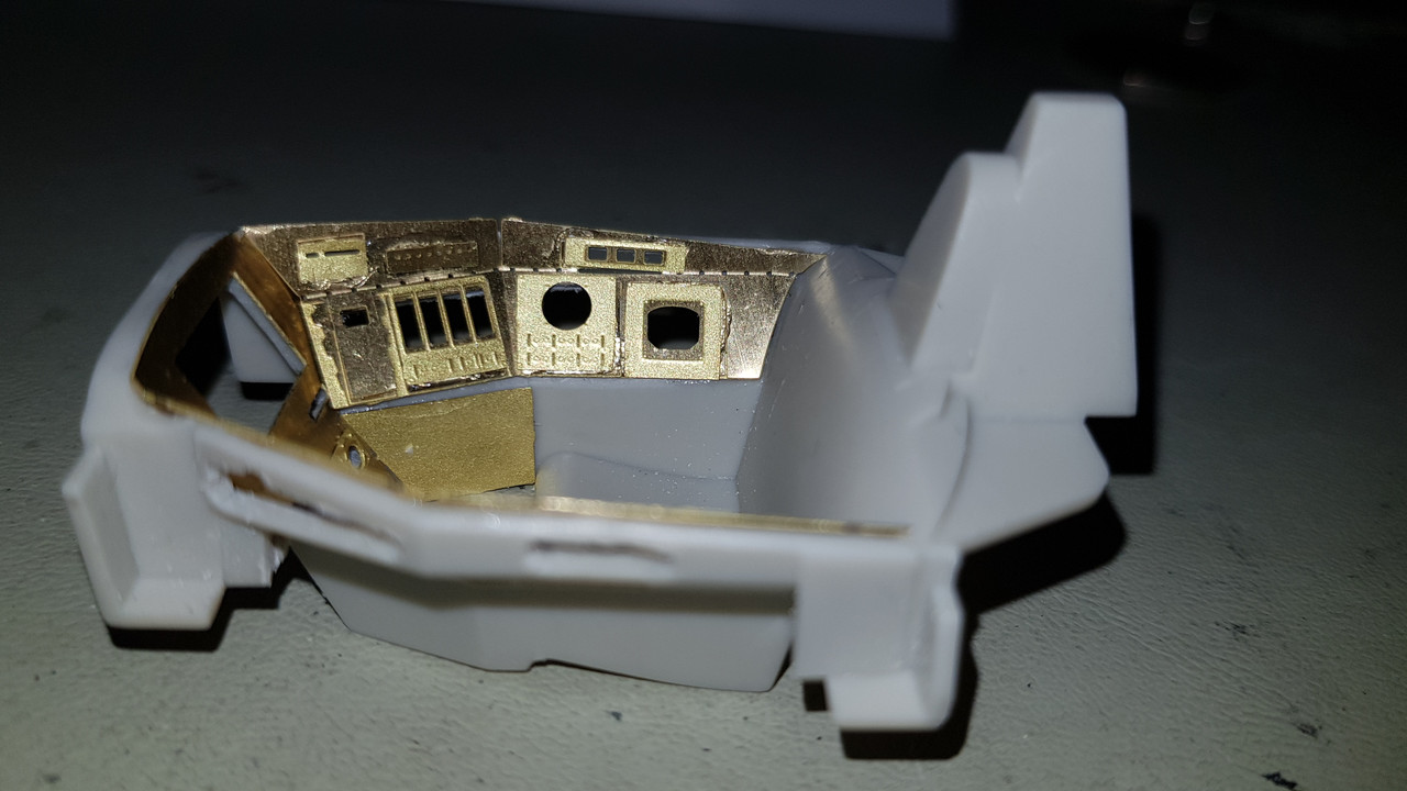

                              Then the PE panels were laid back into verify the openings match the cut holes:

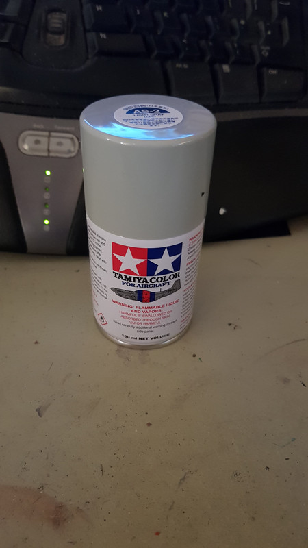

                              Now I have to wait for the primer to be delivered before going any further with this phase. Once painted there are film panels that get stuck on the back of the PE to simulate the various displays and which should - in theory - look very nice when illuminated.

                                The Pe really sharpens up the cock pit....it's brilliant :th: :th: :cheers2:

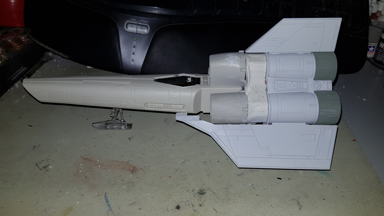

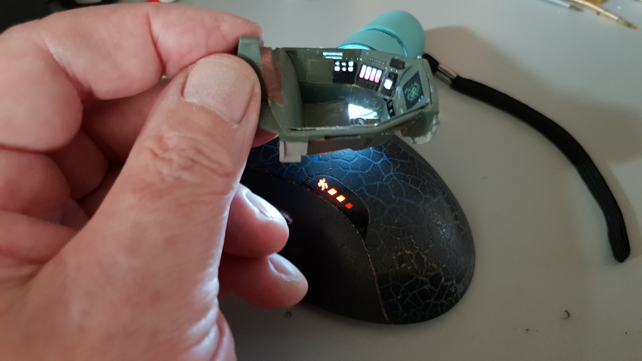

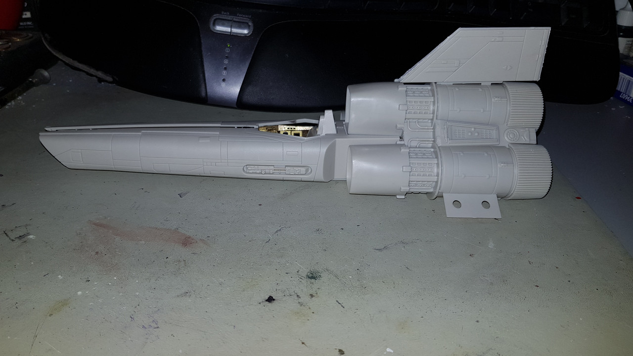

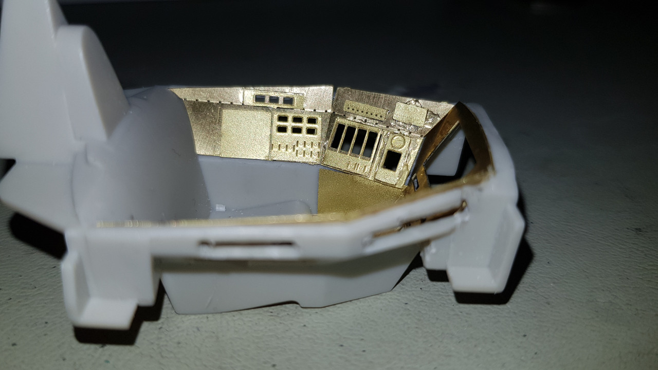

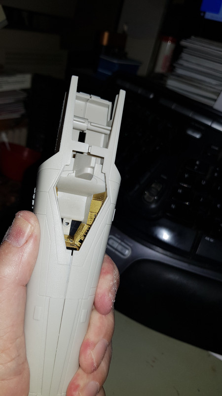

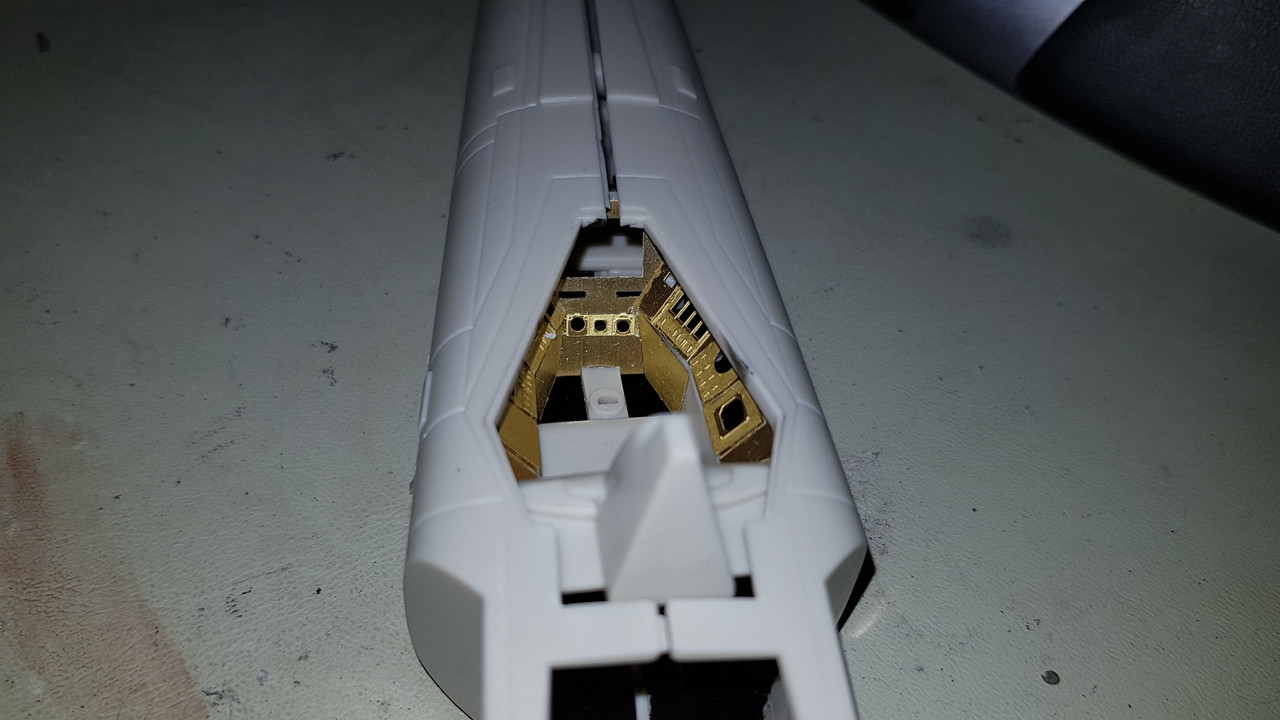

                                Finished off the PE for the cockpit today. I have to say - what a PITA it was getting the overlay panels to line up on the base panels.... Increases my respect for those guy who do a lot of PE work immensely. They are on now though and the assembly is awaiting priming and painting before the film inserts get put in behinds them.
                                All the YouTube building clips say joining the fuselage halves is bad news - I tried it on their own, just the nose gear bay in and it went together fine. Then I put the cockpit assembly in place and the story changed!!
                                The amount of pressure required to join the two halve where the cockpit site is - worrying - to say the least so I need to investigate the why of this.

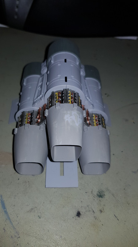

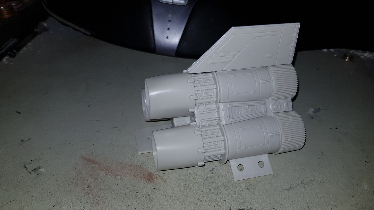

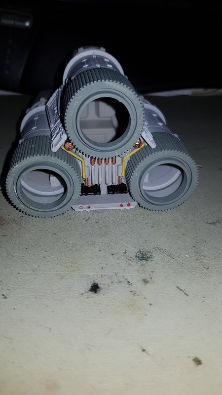

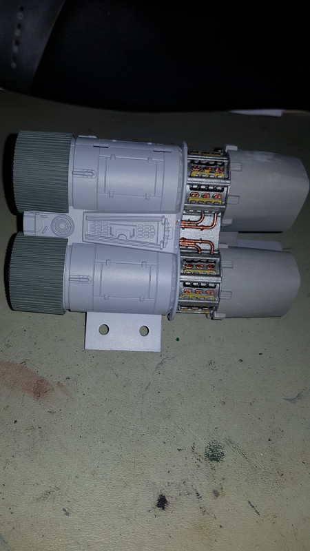

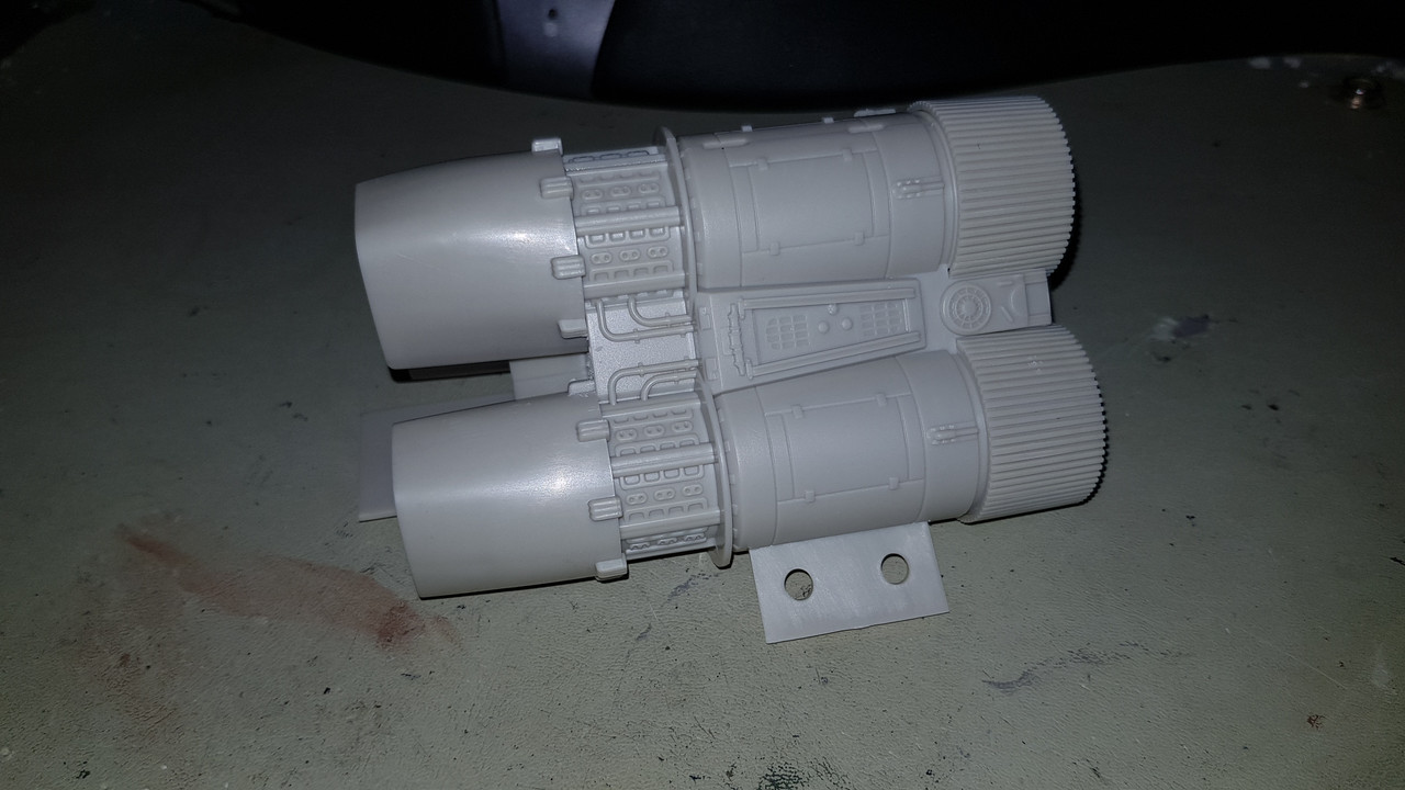

                                I also got the 3 pieces of the engine assembly together - the inlet and exhaust parts are only on loose at the moment to ensure correct alignment of the three pieces:
                                  Re: Colonial Viper Mk1
                                  Oh nice! I didn't even know they made photoetch for these kits.
                                  Like the engine module, looks suitably detailed and will paint up nicely. :th: Not sure how your going to go getting the cockpit and fuselage halves together. Almost looks like the walls of the cockpit are too high. Sure you will get it figured though :th: :th: :cheers2:

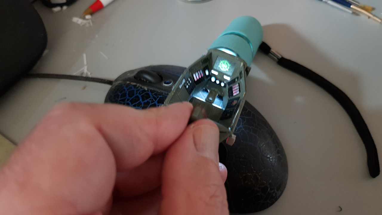

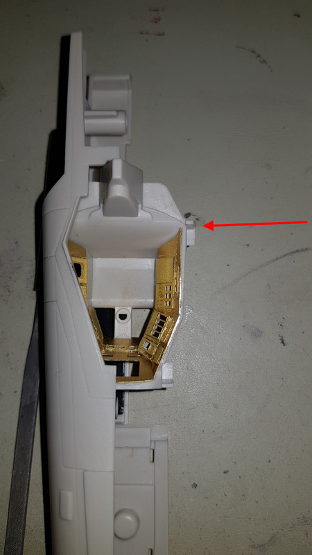

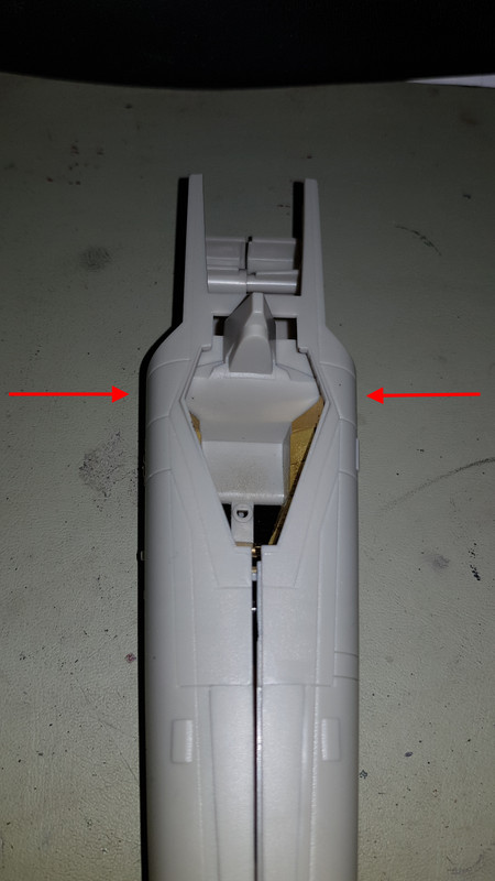

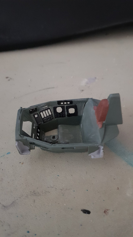

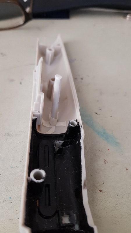

                                  Had a play today with the cockpit assembly before I start adding paint to it. In this picture the two red arrows show where maximum resistance is when trying to close the fuselage halves together:
                                  Separating the two halves to look at the actual cockpit module it can be seen that the points line up with the rear cockpit mounting points:
                                  So out came the file to take a little bit off of each of the rear mount points and bingo - perfect fit!!
                                  Strange thing is - none of the build video's posted on YouTube mention this issue - but the problem points they do talk about - I haven't had... The law of Murphy I guess.. :lol: :lol:
                                    Good fix...just a bit fat in the middle.
                                    :th: :th: :cheers2:
                                      RangerNeil wrote: Wed Jul 08, 2020 12:33 am
                                      digger303 wrote: Wed Jul 08, 2020 12:27 am Good fix...just a bit fat in the middle.
                                      :th: :th: :cheers2:
                                      To be expected Digger - because so is the builder!! :lol: :lol:
                                      aren't we all ... :lol: :lol:
                                      Doh!
                                      Nice fix!

                                      A bit more done today - fancied a change so I had a go at the main body. Essentially its 3 parts - the exhausts,, the main body assembly itself and the intakes. Like the Battlestar most of the work is in the painting I guess. Anyways this is how far I've got - the rear, exhausts piece still has work to be done on it and the main assembly needs the grey paint as its in primer only.
                                      Now - here's where I've hit a problem - the Tamiya XF20 I used to paint the intake nozzles dries far too quickly!! Look at the top intake in the front view and you can see where I've had to rub down bad brush marks.
                                      So I am thinking maybe I would do better trying to find an aerosol of a similar grey for the size of the panels on this kit....

                                        Quickie update on this one as I'v been concentrating on Galactica's the last few days for some strange reason...
                                        Sub assemblies are getting ready for final assembly - reason for the delay on this build is two fold:
                                        1) I'm waiting for the paint to arrive to finish the sub-assemblies off.
                                        2) I am struggling to find the mojo to get into the wiring and LED placement for the lighting kit.
                                        For #2 I really need to summon the whatever it is required to get into cutting out the films for the cockpit - in part I think because I cannot satisfy myself as to the finish in the cockpit. I did it in the evening and gave it a coat of satin varnish - then looked in the daylight and went "Ugh"!!
                                        Right now I really am in two minds as to whether to strip it all back to bare plastic and brass and start again...... :( :(
                                        On the positive side though the sub assemblies ARE coming together....

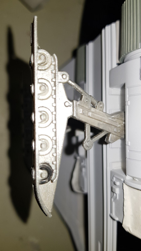

                                        Painting the wheels in the landing gear is proving another pig to do. Free hand is not working at all well. There is no way of using masking tape so I am thinking of trying Maskol to block out the back ground and do it that way.
                                          Post by Parker »
                                          Looking great!
                                          Your right painting those wheels is going to be a B*+*ch.
                                          Sorry can't think of any encouragement.. :lol: :lol: :cheers2:

                                          With the landing gear, paint it all black, then paint over it in silver & then use a cotton bud with thinner to rub off the silver so it reveals the black.

                                          That is a nice idea. Might be a bit tricksy getting the silver off the bit where the wheels meet the silver surface - but certainly worth a try!! Thanks :) :)

                                            No worries mate :D hopefully it does the trick :pistols:
                                            I think the cockpit will be transformed by the transfers.
                                            If you're not happy with it how about painting the brass all black (save for where the transfers will go. It will give it more uniformity and give the effect of wrap around instruments and controls like you see in a jet like a F14.
                                            It will highlight the brass surface detail better, maybe do it in a satin or a gloss to really pop the detail?
                                            I love that classic Viper shape. Those toasters must have short circuited when they saw Apollo and Starbuck coming!
                                            Stokesy44 wrote: Fri Jul 17, 2020 8:29 am I think the cockpit will be transformed by the transfers.
                                            The brass PE panels ARE black now! :lol:
                                            The fillings for the various holes are translucent printed film so that the LED backlight shows through.
                                            There are 4 LED's in the kit - a biggie for the cockpit and three lesser ones for the engines. Currently working through ways of mounting the LED's... :) :)

                                              Amazon delivered the top coat today. Been looking at video clips from the show and to me Tamiya's AS-2 was a pretty close match to the original finish.

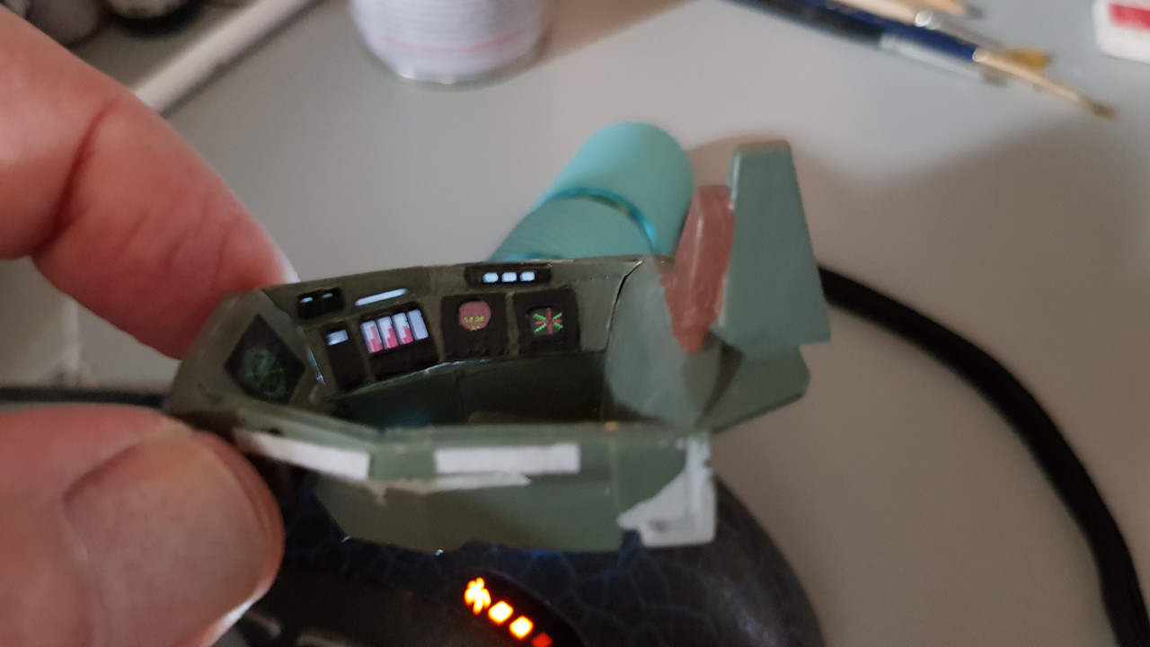

                                                OK - delivered my self the necessary kick-up the backside to get back on with the cockpit on this one.
                                                First I looked at how to mount the cockpit LED. A hunt on YouTube gave me the idea of a piece of scrap sprue stretched across the fuselage with the LED bonded to it. In the photo you can see the sprue taped into place whilst I trimmed the piece down until the fuselage halves fitted together properly.
                                                Next was time to get the instrument panel screens in place. Despite the instructions to the contrary none of them would fit the cut holes so a fair bit of fettling and VERY careful trimming was needed. Apologies for the torch in the photo being used to test out the lighting effect
                                                Next job is to get the LED soldered onto its feed cables and then mounted in place and the front fuselage closed up. meantime - here is the first pre-assembly build. Everything is put together loosely - only the fuselage and wings are joined up...

                                                  Loving this.
                                                  Looks better and better each time I see this :th: :th: :cheers2:

                                                  Looking good Neil, the light up cockpit will look awesome :pistols: great job so far
