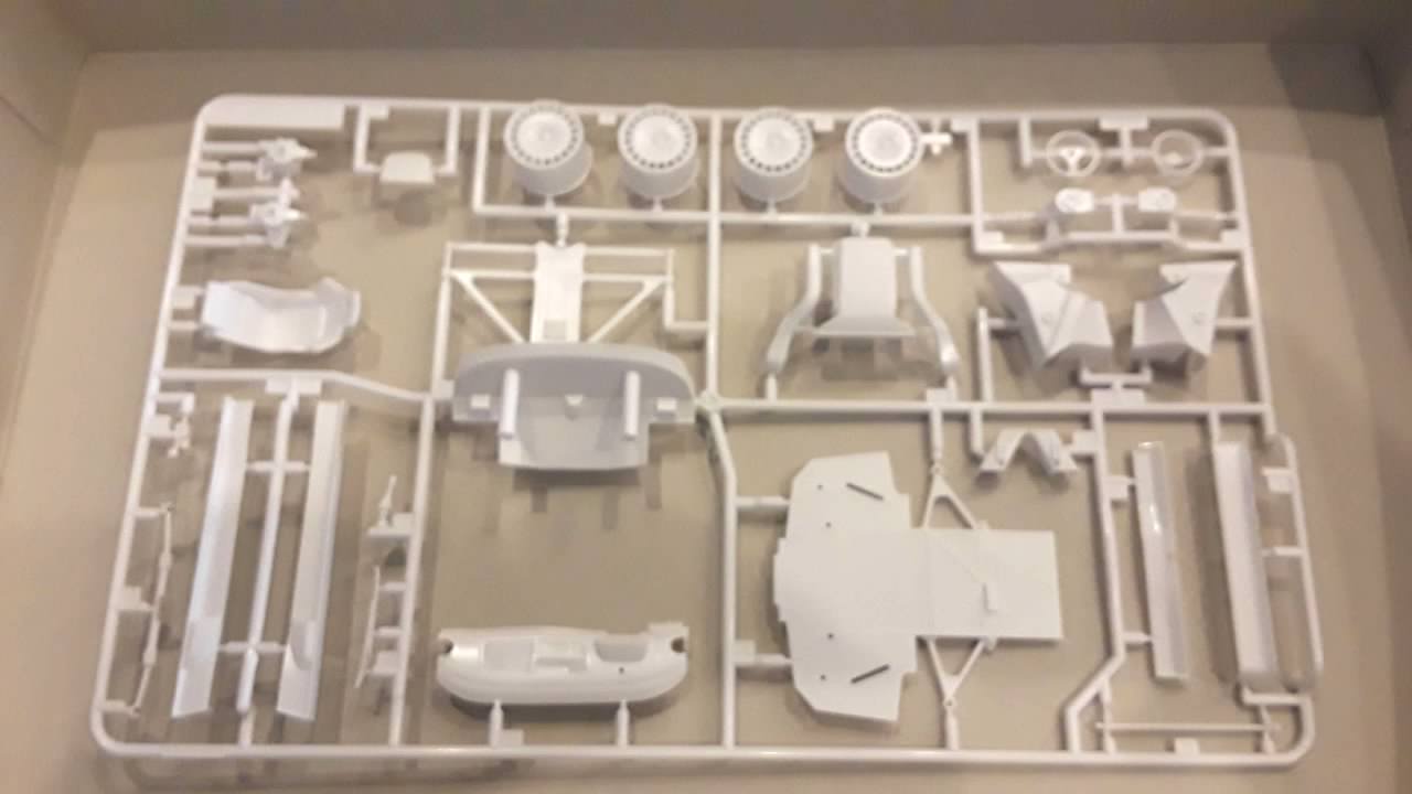

Now the GSR BMW is done and on the shelf... let the wife pick the next one.
Gave her the options of one of the 3 Tamiya Alfa DTM cars I have, and she picked the Jager Alfa.
Pretty happy she did - going from the Fujimi GSR BMW Z4 with over 200 decals to the Alfa with, like, 12. :dance: :lol:

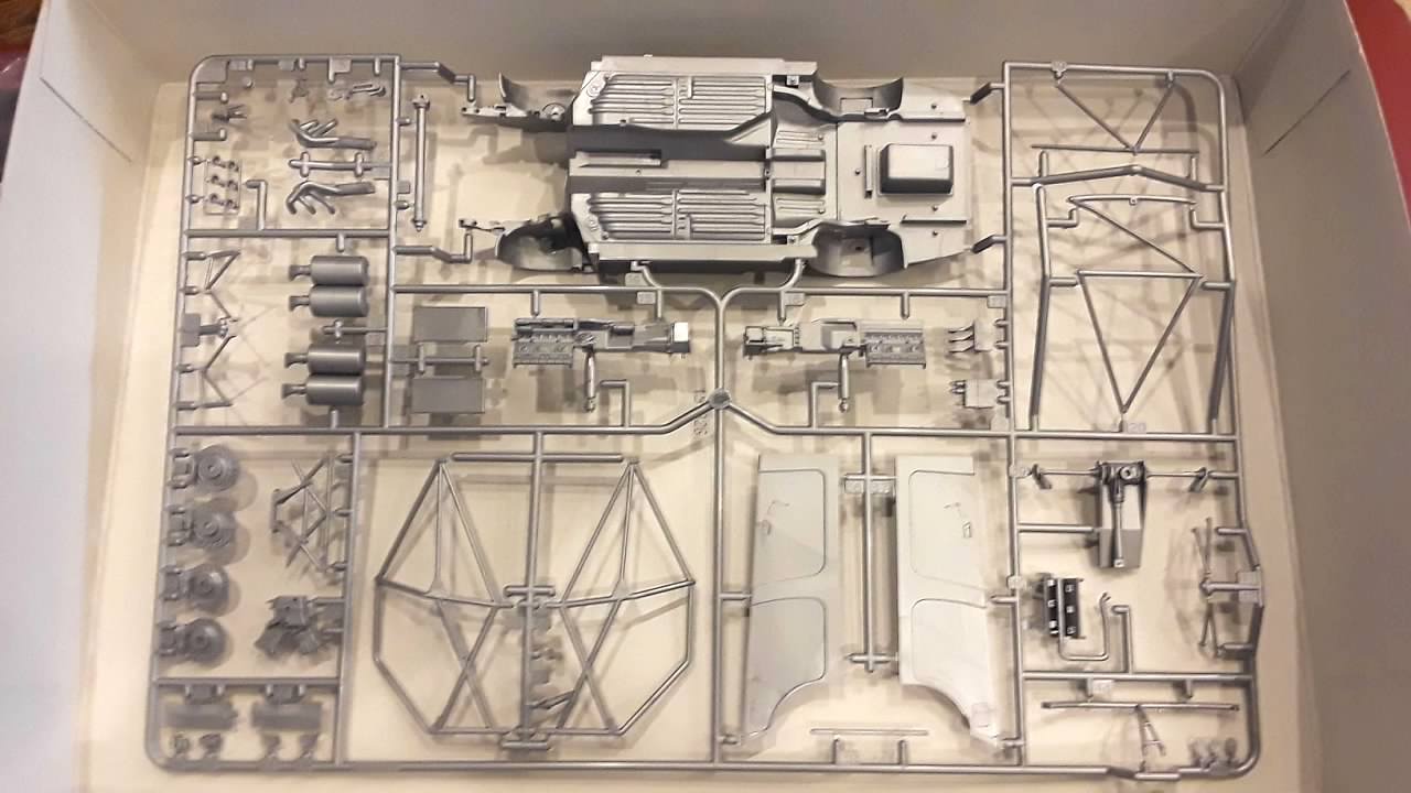

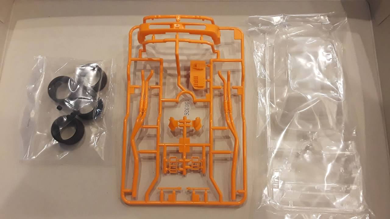

Few shots of the box and sprue:

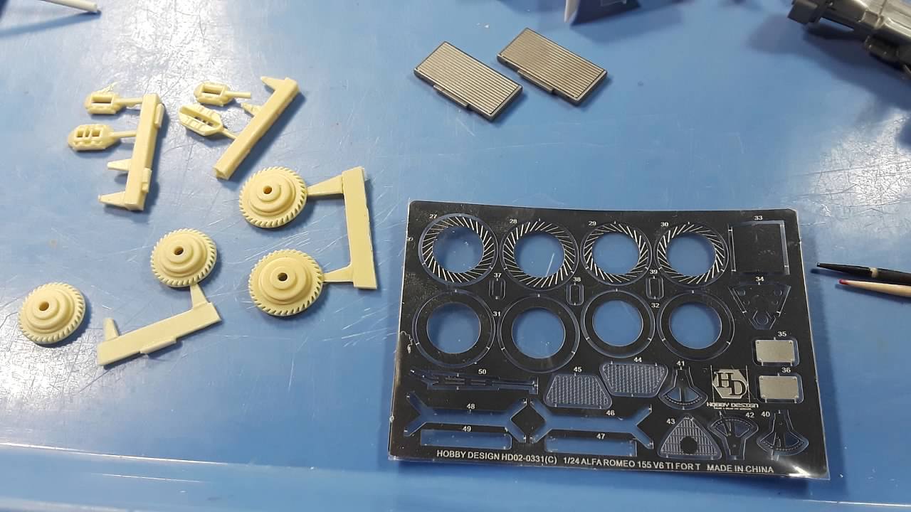

I've ordered the PE and window mask set from Hiroboy (had to make my own window masks again for the BMW :? ) and this will be the first kit that I will use aftermarket PE/resin bits on, so we'll see how that goes. I've seen the great job that guys on here have done using it for the first time and have been itching to do one.

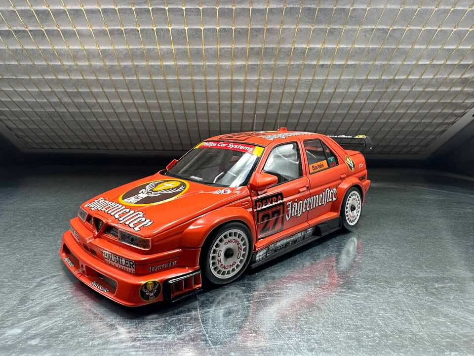

I’ve got the Works (the red one!) one in my stash as well, one of my favourite cars ever, looking forward to this :cheers2:

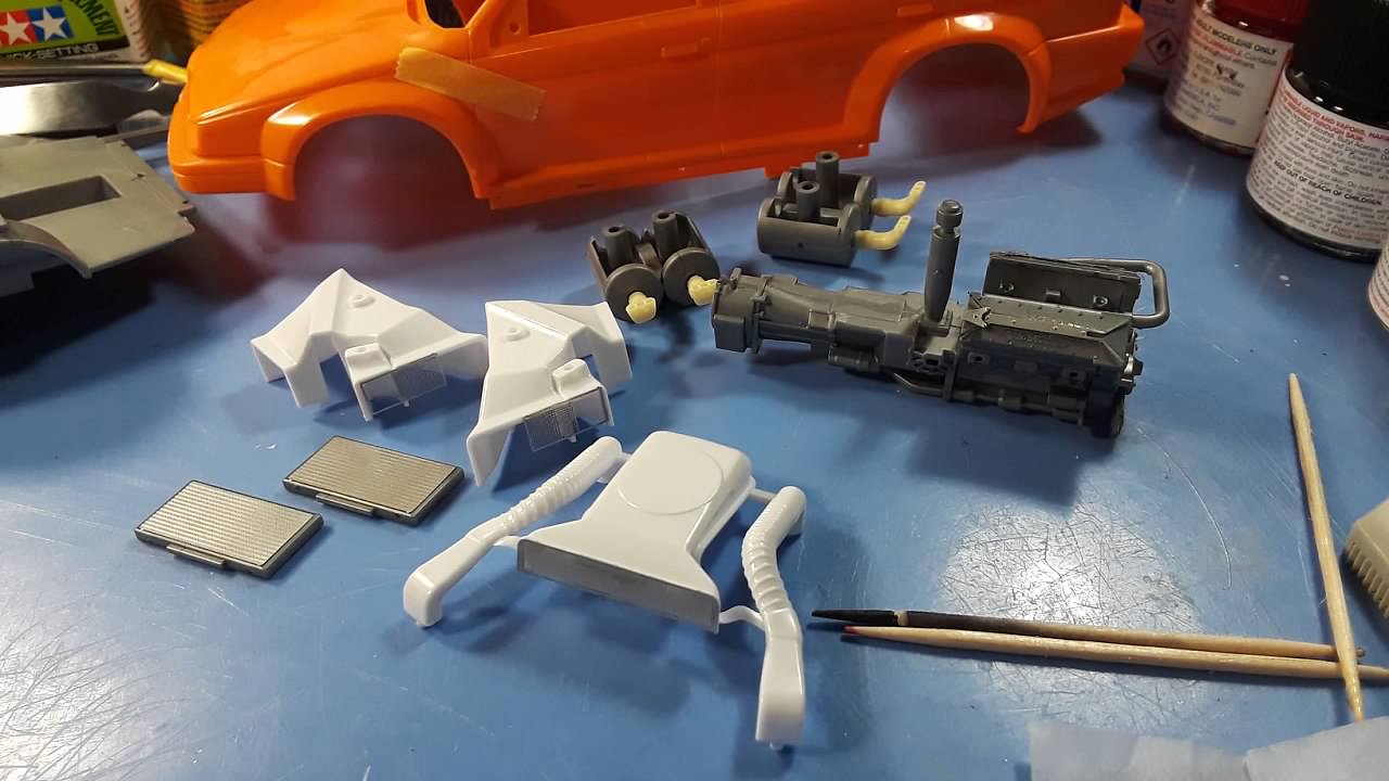

I've made a start on cleaning up some seams and getting a few bits glued together, but I need to wait on the PE set before I really get going. I'm not really sure what all is in the set I ordered - it didn't have a list, just a couple of pics of the contents. Thanks for looking in, man! :thumb1:

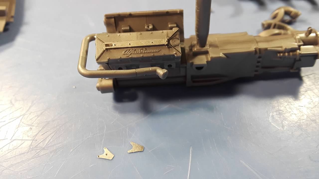

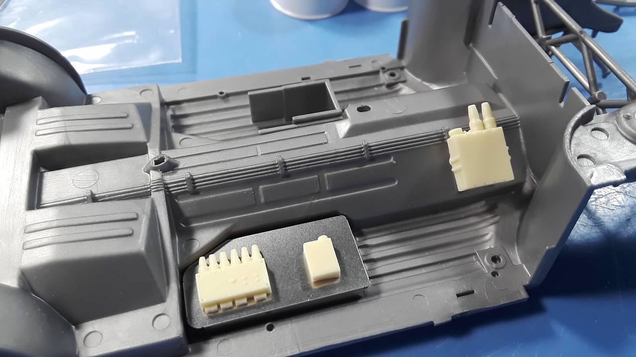

Well, got the PE kit for this bad boy whilst I was finishing up the Goodsmile Merc (waaaay back in November 2020). Then... life happened and the wife got a new job. So, we loaded up the truck and moved near the house of mouse... :lol:
Gonna get this thread going again though, now that the Newman/Haas Indycar is done - wanna get this one going.
As I stated earlier, have never utilized PE or resin parts in a model before. Was a bit nervous at first, but figured you learn by doing so made a start today.

That resin is very fine quality I can't but imagine this is going to look great.

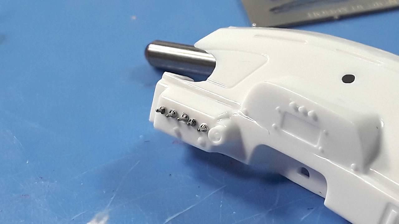

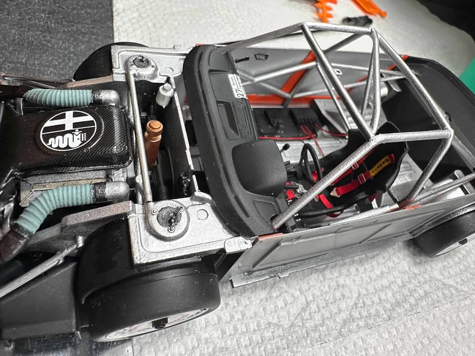

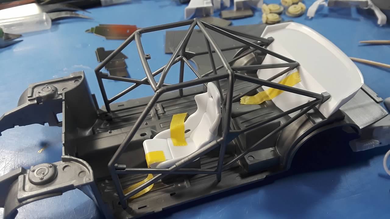

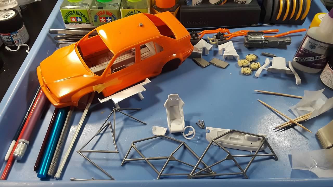

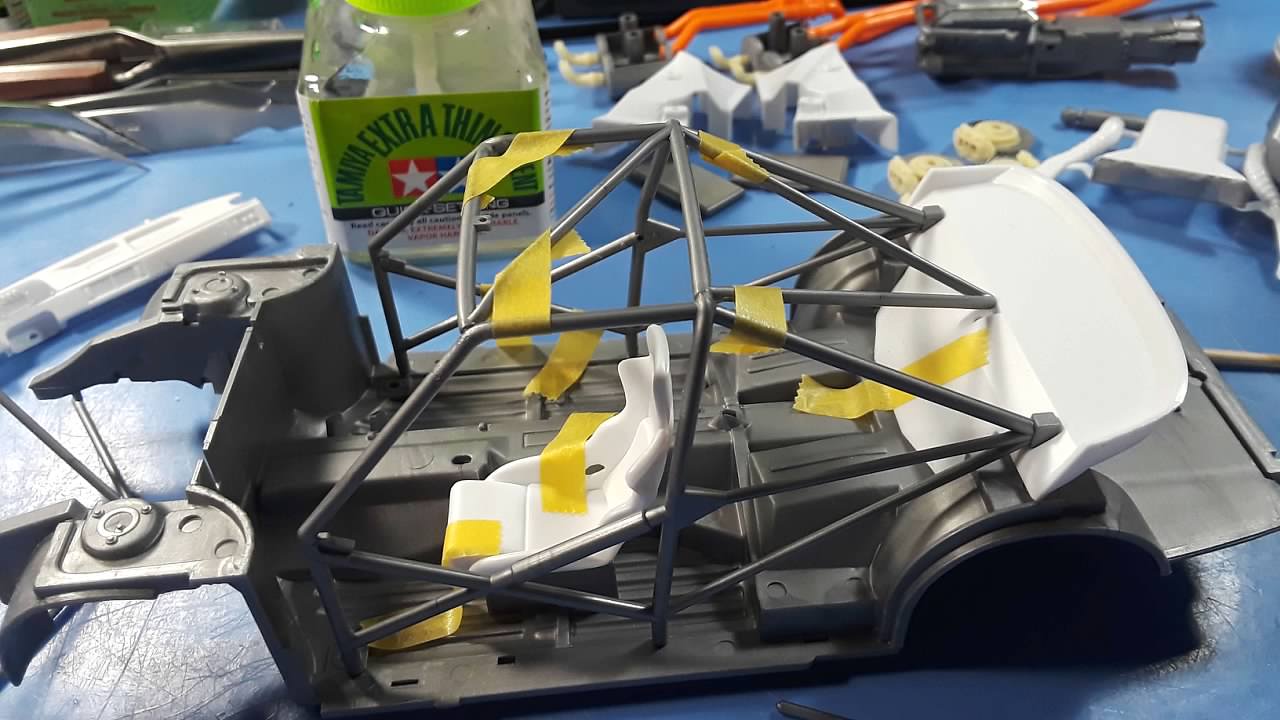

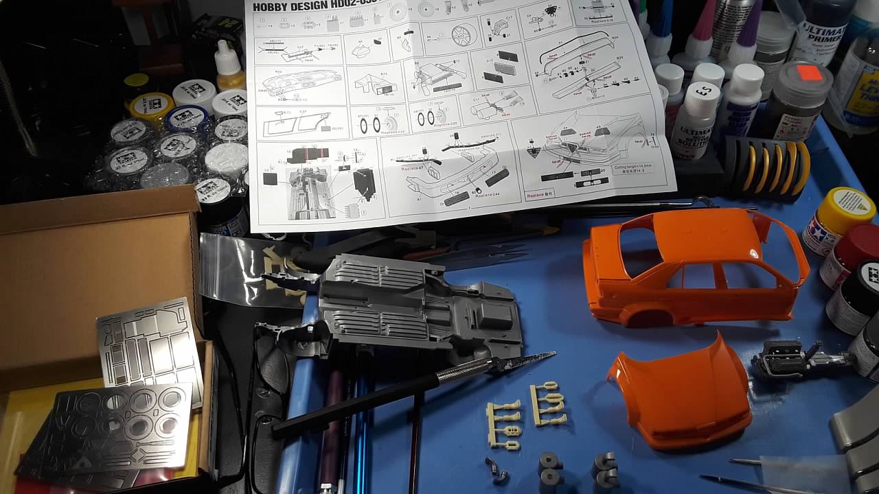

Got some time to work on the Alfa today... spent about 5 hours working on it - but man, this is slow going. My wife asked if it was worth it, as a lot of the detail-up stuff you probably won't ever see, but I'll know it's there. I say, so far, it's been worth it and a really good experience. Learning new stuff as I go, and that's never a bad thing.

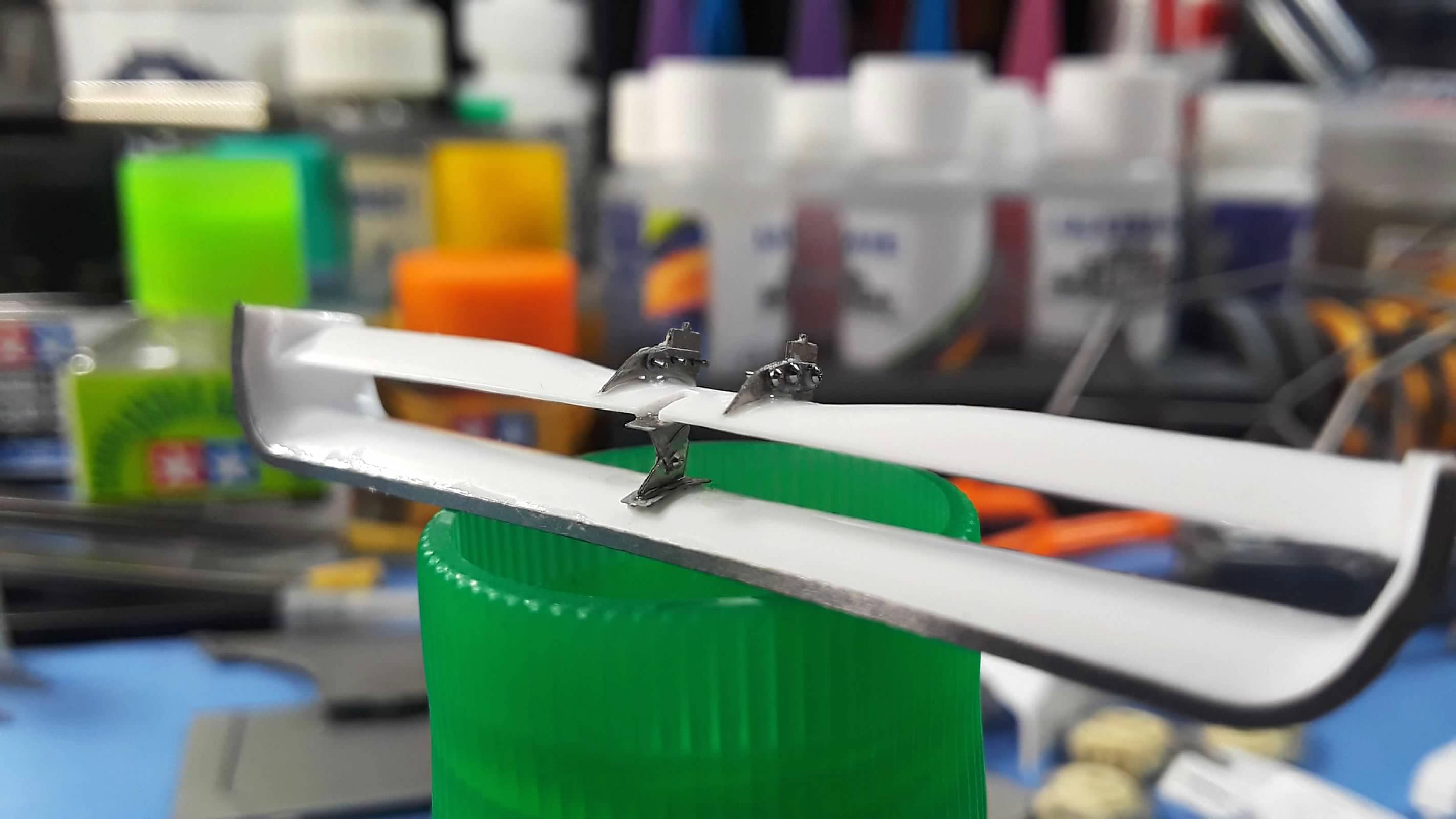

Worked on the front of the car and a bit of the interior, also made a start on the PE bits for the rear wing... but only got about half of it done.

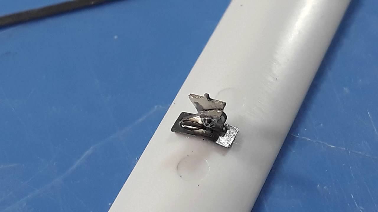

The roll cage was a real challenge, but pretty chuffed with how it turned out - it fits like a glove (and no, not an OJ glove, er, well maybe just like the OJ glove. LOL!!)
Had to get creative with the tape to keep it in shape...

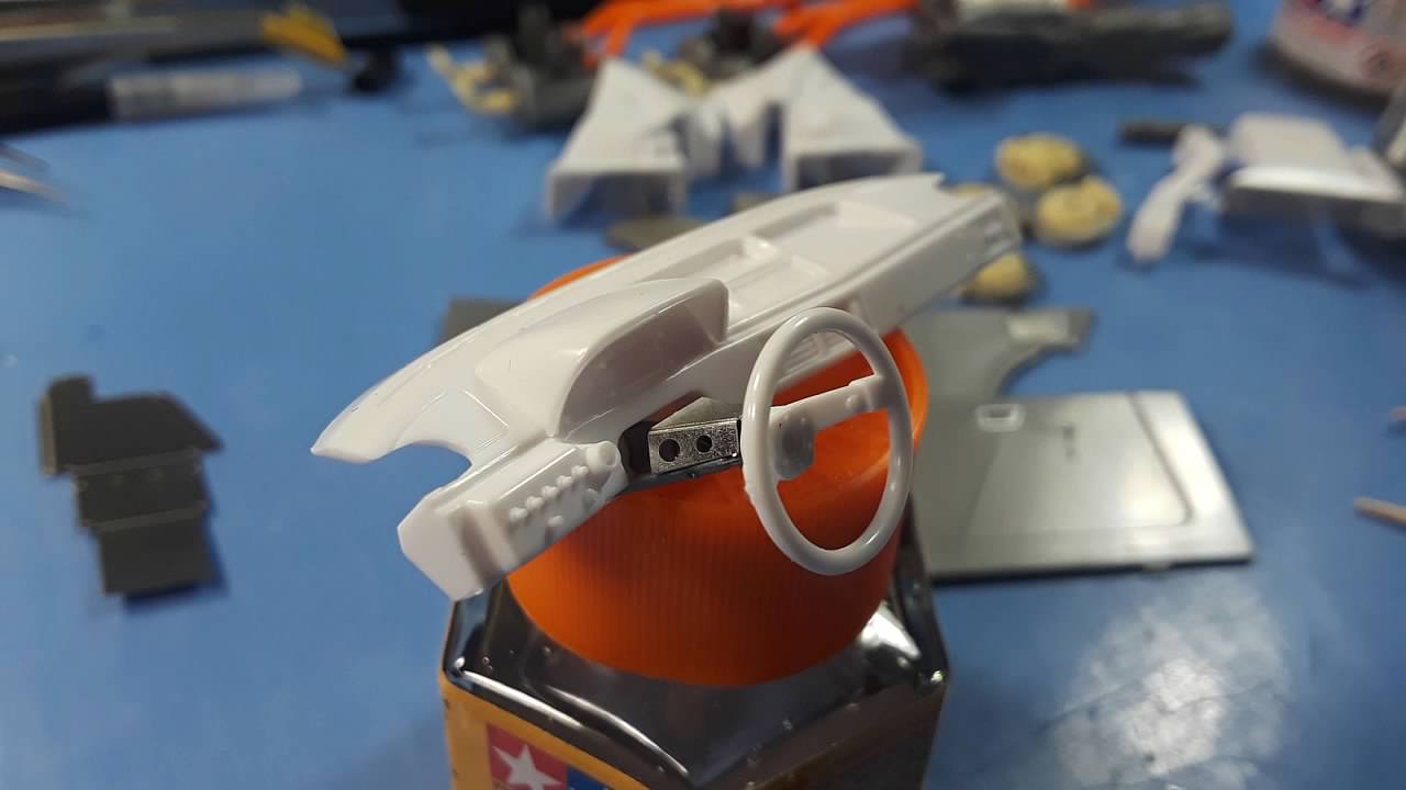

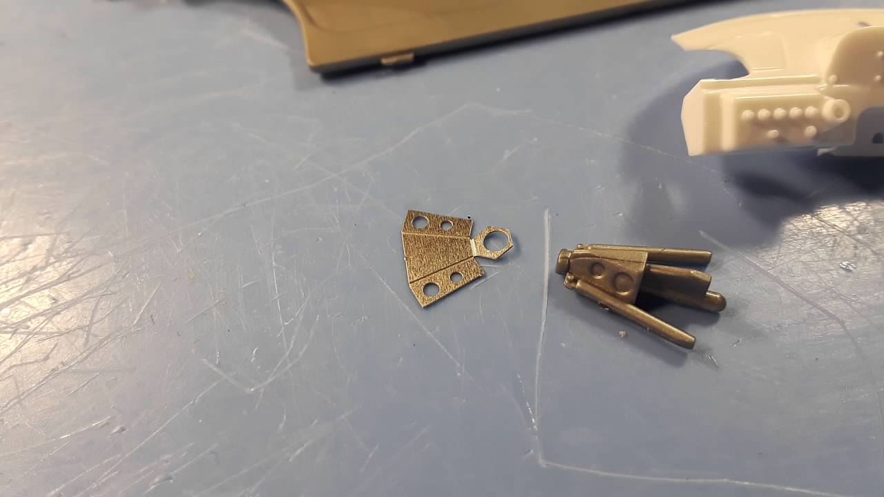

PE steering column...
Dash switches.
Rear support for top plane of rear wing... and yes, that's a gargantuan glob of CA glue on there. :roll: I need to get something other than a toothpick to apply glue in some areas...
Doesn't seem like a lot but it took me awhile. :lol:

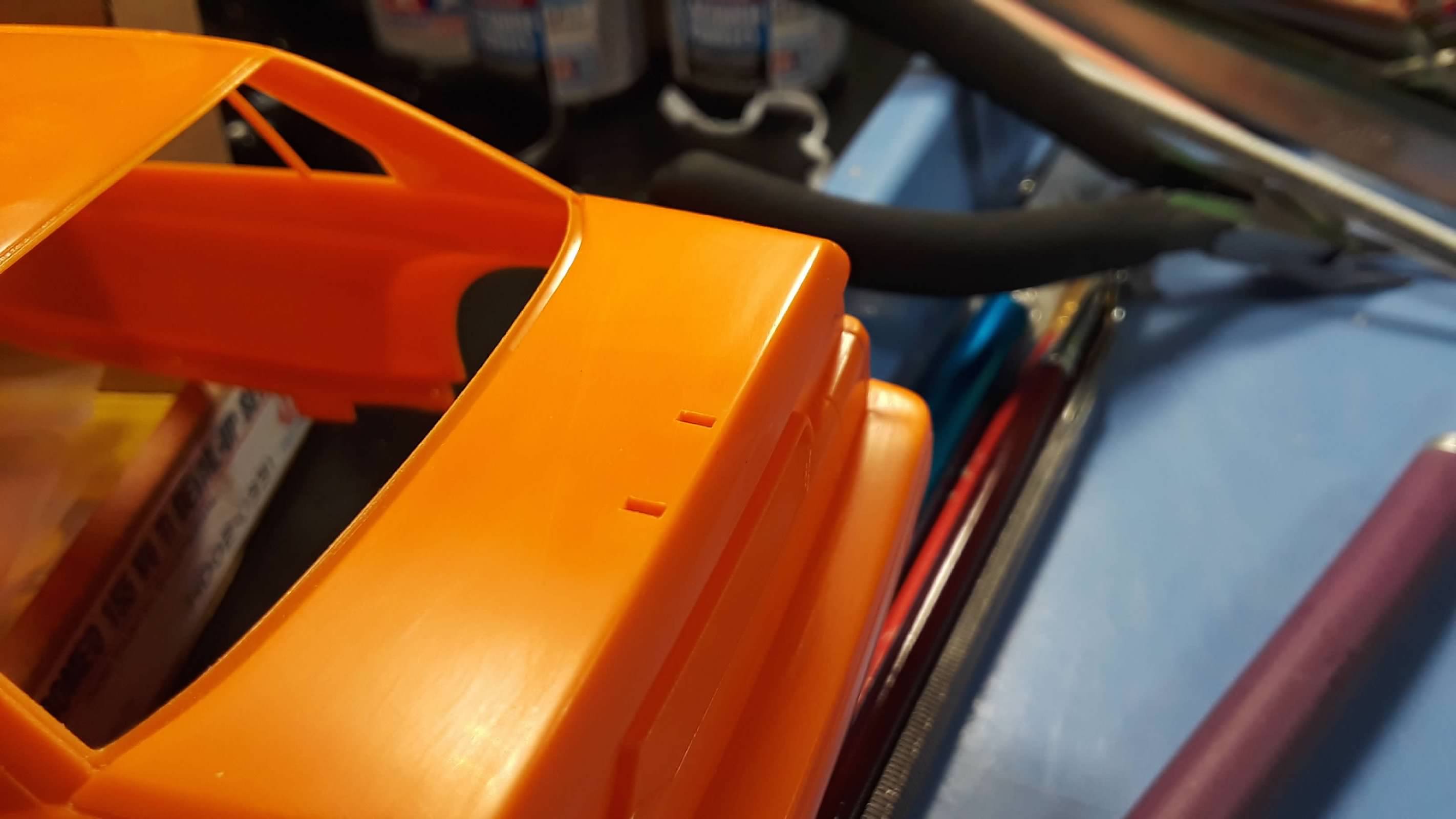

I also got some Milliput in the mail today to fill in the slots on the body for the wing. The PE supports are much thinner than the stock plastic pieces on the wing, which you cut off. It'll be the first time using Milliput, or any kind of body filler, so want to take my time on this part.
Thanks for looking in and hope to have a chance to work on it some more tomorrow. After that it may be on the shelf for a week or so as my son is coming for a week long visit. :thumb2:

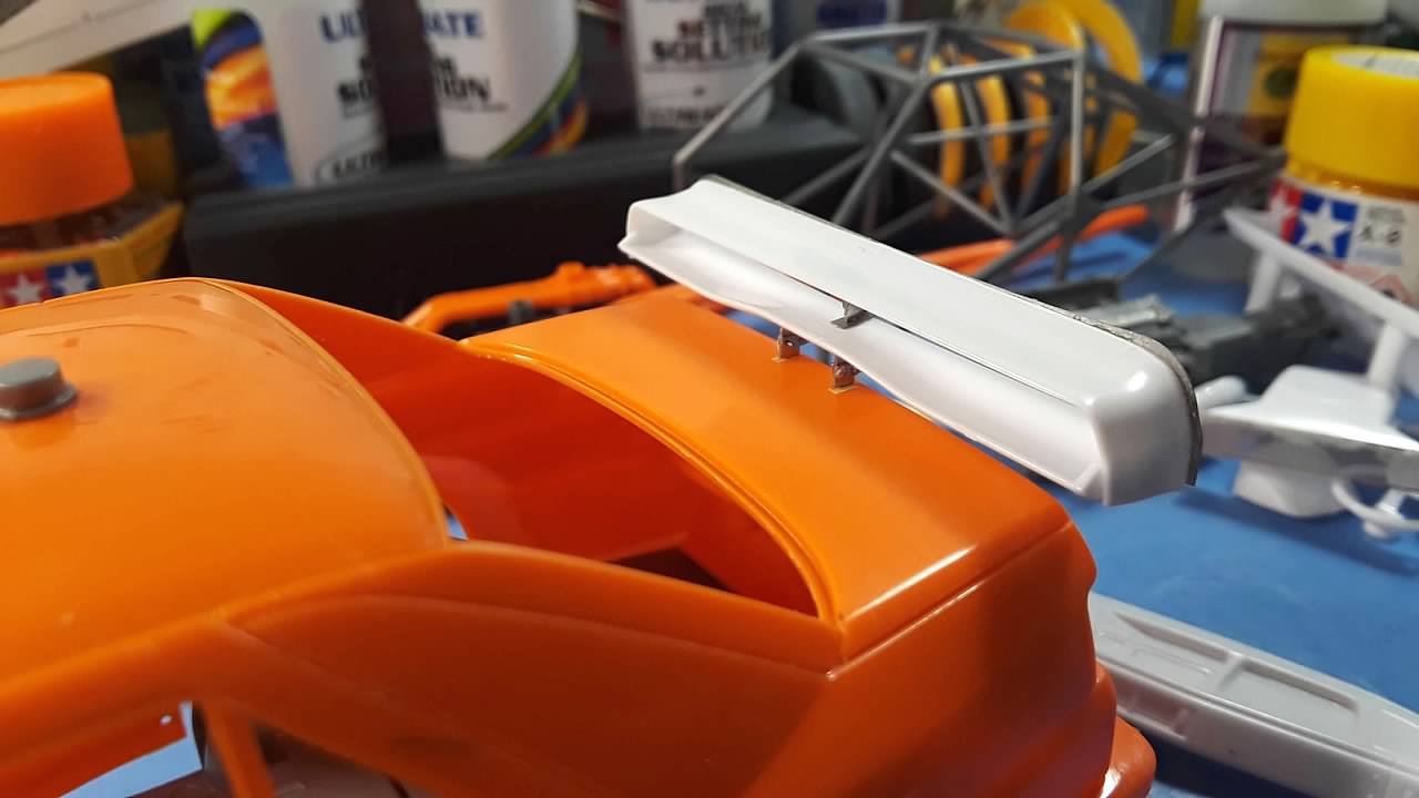

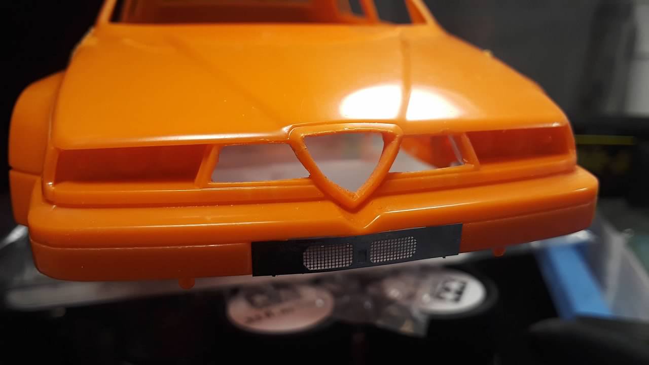

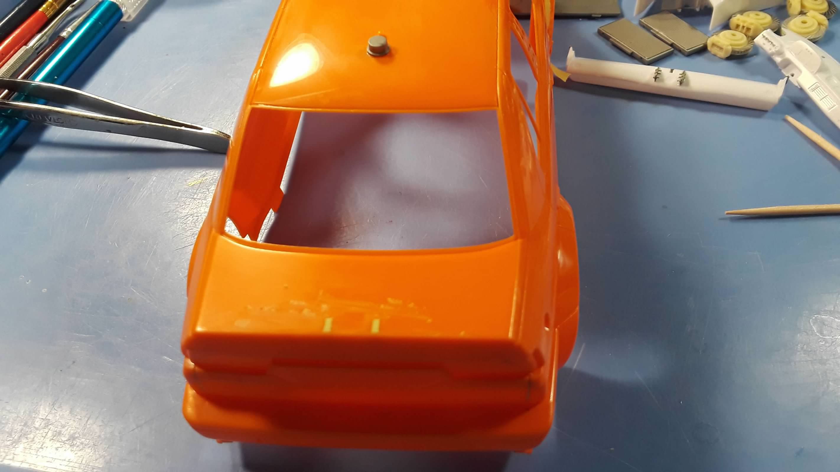

Got the rear wing put together and used the Milliput for the first time... made a start on the chassis - but no pics of that.
I prob need to get some molding tools if I'm gonna use this stuff, I ended up using the butt end of a pair of tweezers I have...
Came out okay (I think).

Those dash switches are phenomenal :jd:

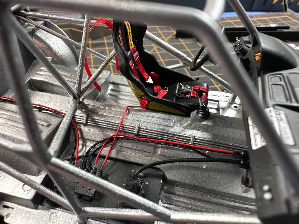

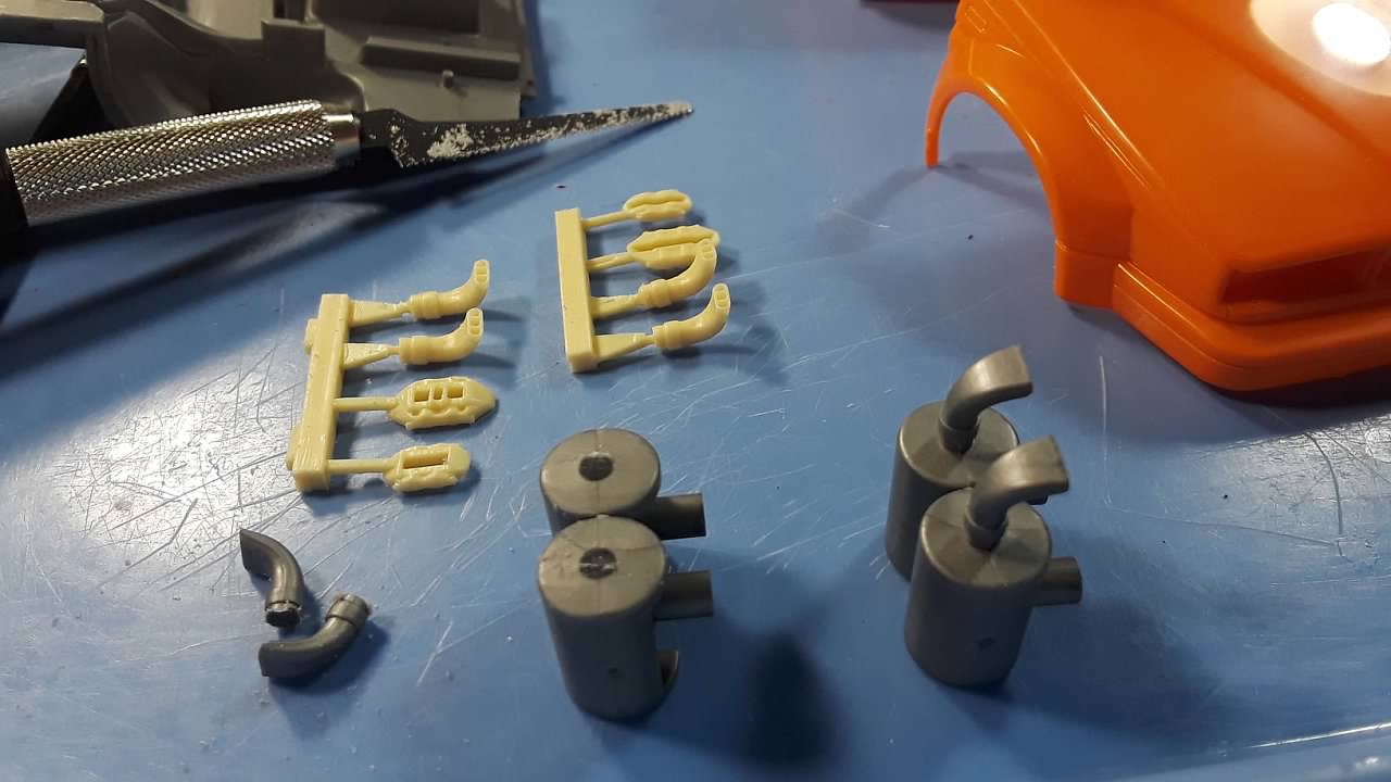

Had a nice visit with my oldest, but was able to jump back in and do a little bit of work on the Alfa.
Got quite a bit done again and "think" I'm ready to start the primer and paint process.
Got the rear of the body finished up with the new rear wing mounts, which are much thinner than the stock mounting standoffs.

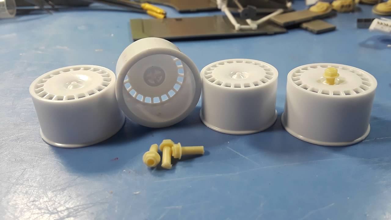

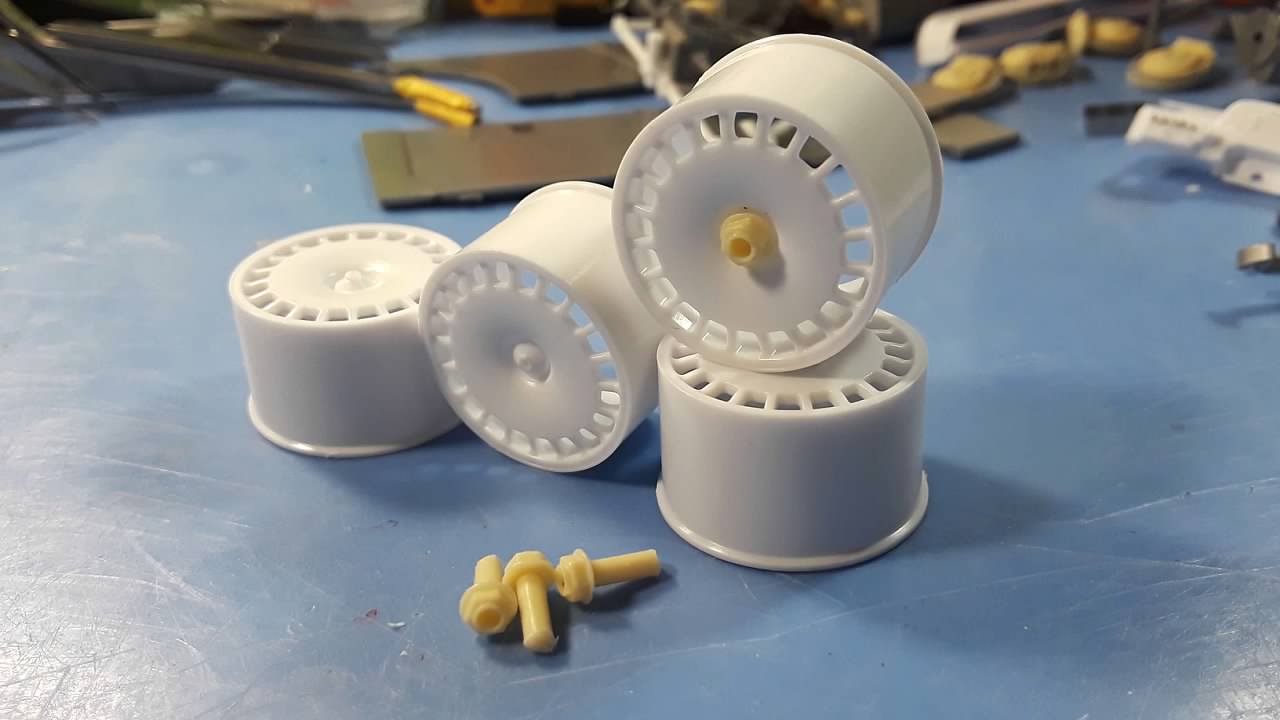

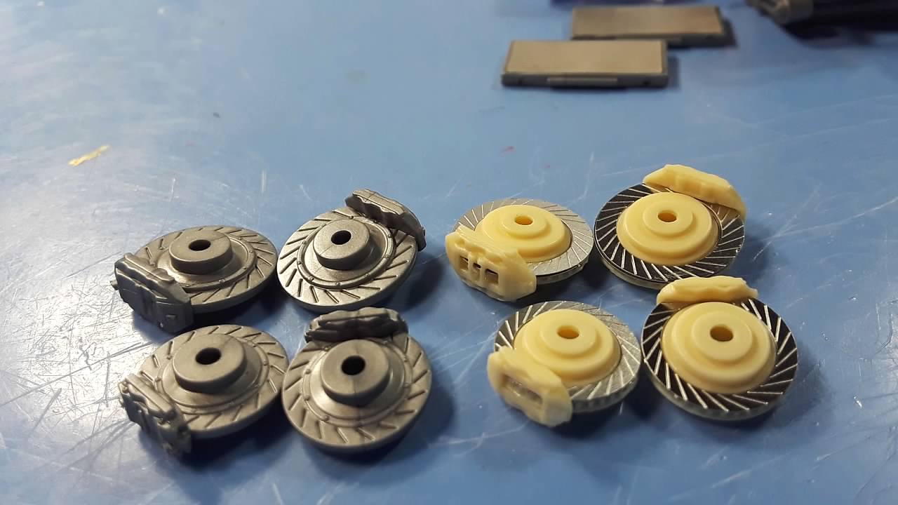

And some more fiddly PE and resin parts. Drilling out the wheels for the resin wheel nut was new to me... Along with the air intake vents on the front bumper.
Also, not sure if I have the right cables to "wire up" the car - but gonna try. :lol:

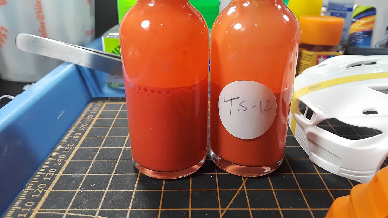

Gonna test the two orange paints I have also... may need to do a custom mix, but I have decanted some TS-12 and TS-98 to try. Have a spare BMW Z4 body shell to test on. :thumb2:
Looking at the paint in the bottles each looks a little "off". The TS-12 is a little too light, or pastel, and the TS-98 is a skosh too dark/neon... I want to shoot it on some spoons and the spare body though just to compare to the decals.

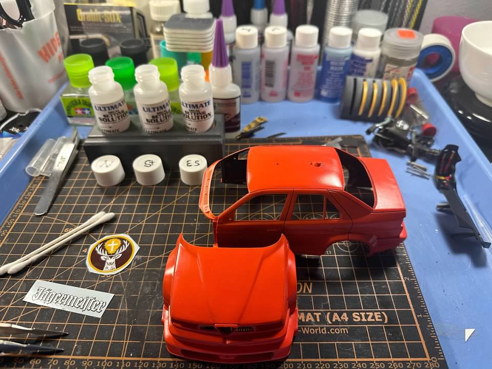

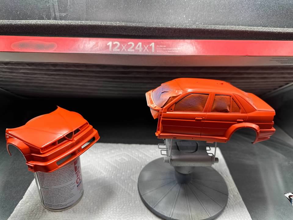

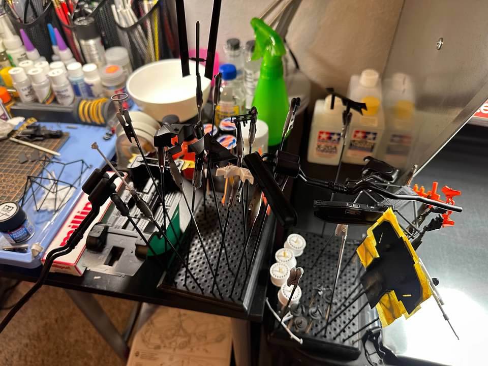

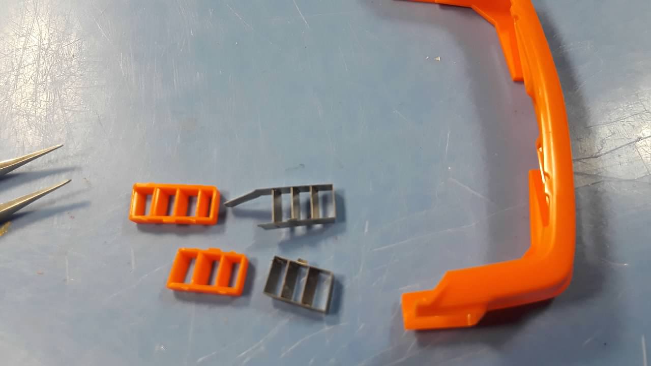

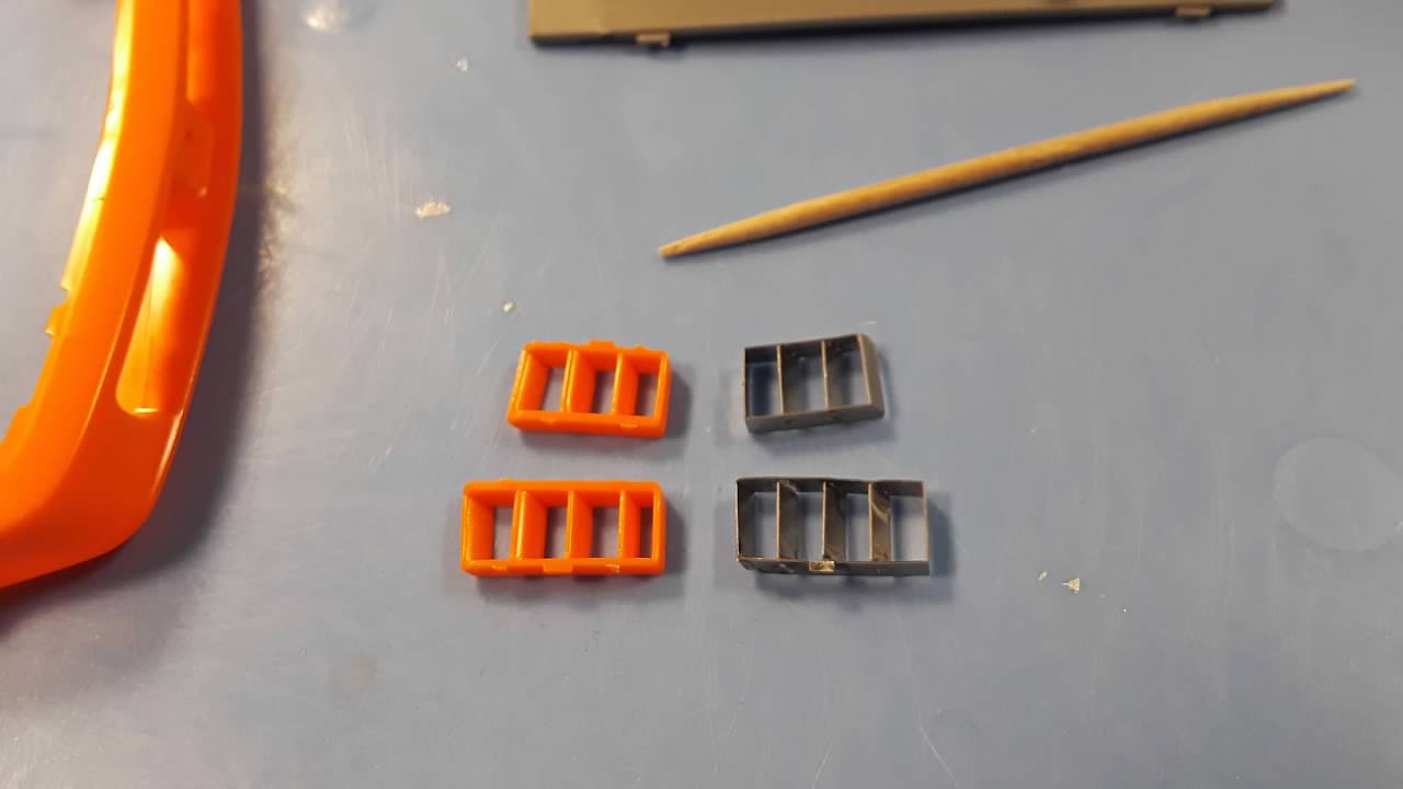

After the long'ish hiatus, I've been able to recently get back on this one... after I did the Nigel IndyCar for my bud, had some issues with me, but all seems to be back to normal. :D
Anyway, last time I worked on this I sprayed SGB on most everything and something just wasn't right - the paint was all flaky and fell off. Had to sand, scratch and re-shoot it all.

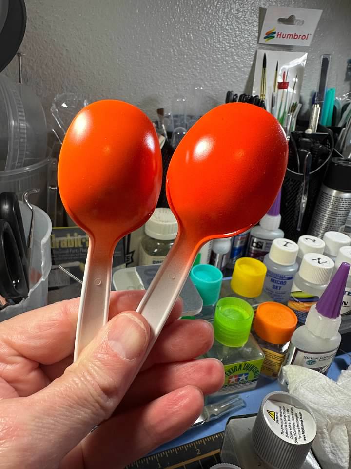

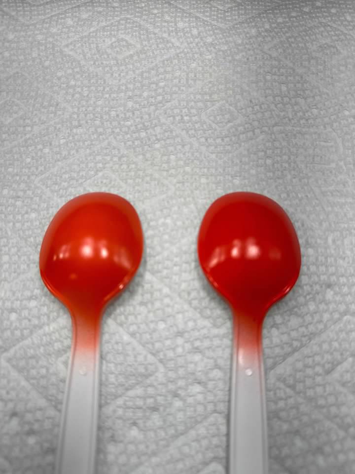

Was also able to test the two orange colors I had on some spoons.
On the left is decanted TS-12 orange, the right is TS-98 pure orange... The instructions call for X-6, which is the acylic orange, so the TS-12 is the equivalent. At least as far as I could check.
The TS-12 looked just a little meh orange, but the TS-98 seemed to have too much fluorescent color to it - kinda reminded me of a construction cone orange. :think:
Ended up shooting the TS-12 and pretty pleased with the results...
Will need a sand cycle (as I also screwed up the primer on there and didn't notice), prob do a light dry sand and then a wet sand routine... Will probably shoot another couple of coats before I decal it up.
Here's most the black bits painted in SGB again - after about 2-2 1/2 hour cleanup. :wall:
Gonna try and get the decals done over the weekend. (Do, there is no try.)
And then move on to the interior.
Just really enjoyed painting, trimming, masking, and generally just making a mess in my room again. :lol:

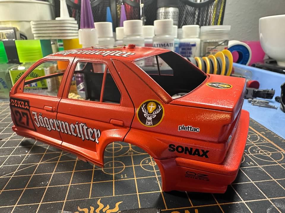

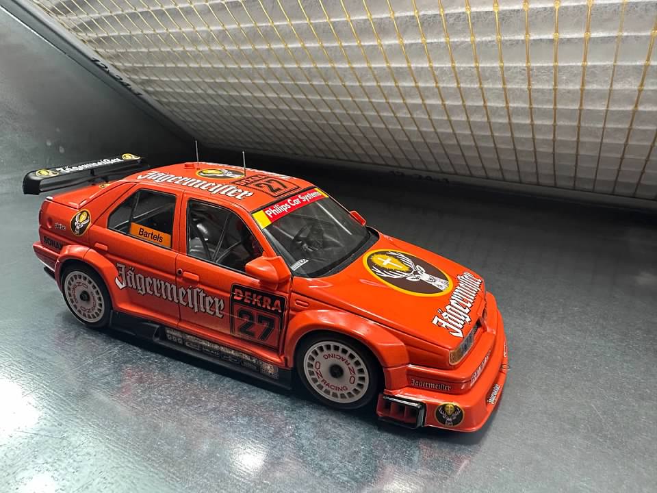

Got some time to get stuck in... paint job is a little lacking, but I feel okay with it seeing as I haven't painted anything in almost two years.
Putting the decals on is always the best part though - it becomes a race car at this point.
You can see a little orange peel on there, or roughness. Gonna let it slide as I don't think I had thinned the paint enough...And, I had decanted the paint almost 4 1/2 years ago. Any-hoo, gonna let the decals dry for a couple days and shoot some clear on there - whilst gonna go ahead and start on the interior & chassis. :thumb2:

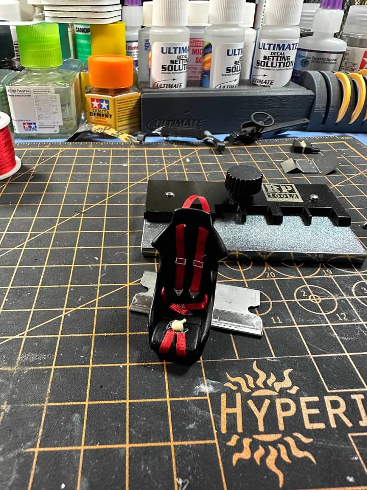

Tried my hand at doing actual seat belts, or race belts, and after watching Paul's interior tutorial on belts about 72 and a half times... Finally did it, aaaaaaannnnddd turned out, meh. I know, I know, we're our own worst critics, but just had trial after trial (can't tell how many pieces end up shot out of the tweezers and in the carpet black hole...) but feel like I learned a lot and realized a couple of things that will be done differently next time... but here it is (waiting on the race belt brands to finish, and paint the lap latch...)

they look all right. wont see much of them once the body is on anyway
Re: 1/24 Tamiya Jagermeister Alfa Romeo 155 DTM car
cor wrote: Wed Aug 21, 2024 12:32 pm they look all right. wont see much of them once the body is on anyway
That's kinda what I was thinking as I was looking for one of the tiny PE bits in the carpet (with two pair of glasses and my phone flashlight... :lol: ).
The latch has been painted and once the seat belt 'brand' decals get in, and placed, they'll look okay.

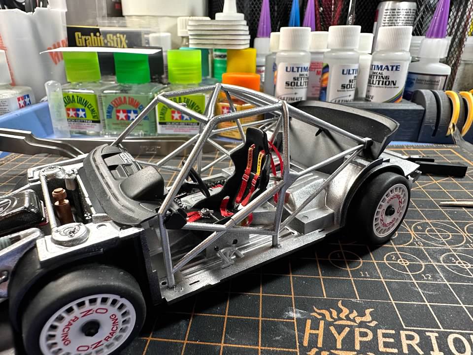

Realized that I really don't have the right kind of wiring (thickness wise), as mine is either too thin, like ignition wire - or too think like stuff for hoses. Now, having done it, I definitely was looking at it and thinking about how it will be done differently next time. Anyway, here's a couple shots of it, and on a side note: did that trick of using the MLT as Paul suggested on his instructional video on belts, and man, he wasn't kidding about just touching it one time. I was very conscious of just a touch with the brush and 'let it be', but dang, one of the SABELT decals completely faded into the fabric (well, ribbon). Lesson learned, be cautious with how much of the MLT you have on the brush.
:pop: :th: :pop:
Looks good. I make an effort to look for and collect a heap of wires and threads of different thicknesses that I use for that sort of thing. Once again, will be invisible with the body on,

She is coming together :th:
Super interior wiring and details
I like the decal stage too and those look great :clap:

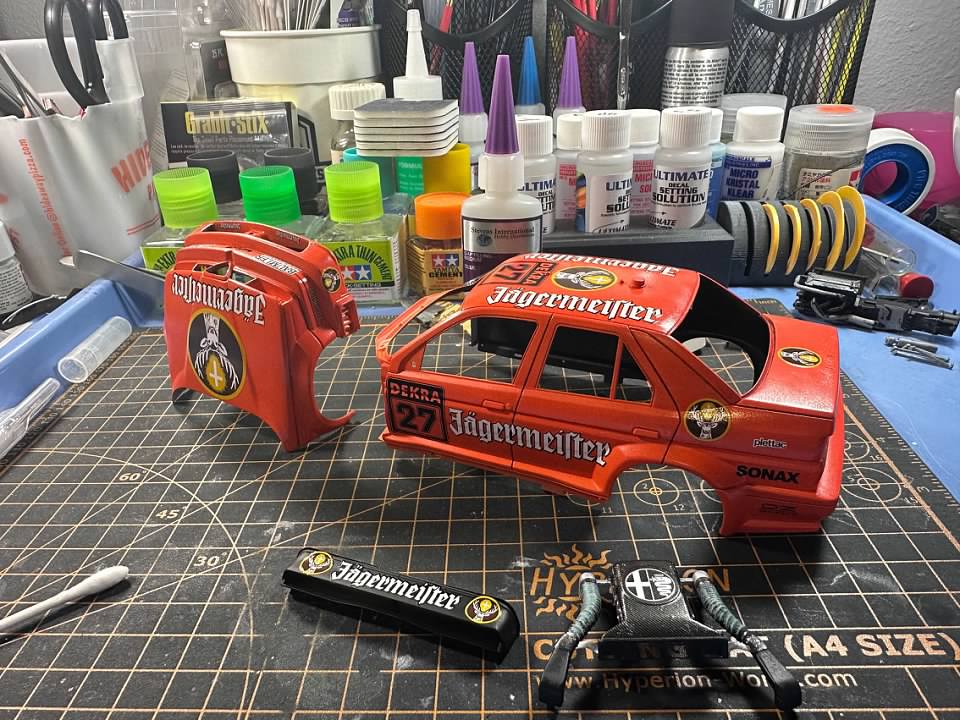

Thanks guys, for posting and keeping me motivated... Have finally kicked this one over the finish line.
Lots of little mistakes, again (seems to be a theme :lol: )
Will say that I have got to learn how to do clear coating properly. Went to mask a part of the car, thinking that the clear was 'all good' and pulled a decal right off with the tape - ripping it in half. :wall: :bash:
After spending two nights fixing that ignoramus move, and "hand" painting the 'window rubbers', was finally able to complete it.
On to a Subaru WRC for a buddy (and then a dual McLaren MP4/6 F1 build :banana: )
