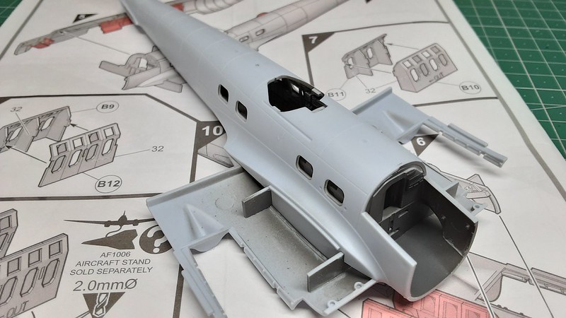

Like many I've found the moulding on Airfix kits can be a bit soft along the mating surfaces. I try to deal with this as early as possible with some dry assembly. In my experience with their more recent kits, this one is 2015, with a bit of clean up the fit is generally pretty good (tempting fate here).
Happy so far I assembled the bomb racks and painted the rear fuselage internals in Mr Color RLM66, rubber black and a bit of dry brush highlighting. With research it appears that this may have been a lighter colour but not much will be seen when it's all together.
With this dry I glued up the main fuselage parts. The fit was good enough to just use Extra Thin, no filler so far!
After a couple of days drying and some initial clean up I'm happy with the seams but to me the fuselage looks a little bare so having found some relevant drawings I'm going to attempt adding some rivet detail to spice it up a bit.

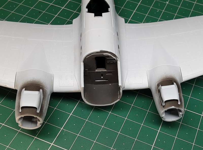

Some more progress although I'm starting to wonder if the rivet idea was a good one, many hours spent so far and still a way to go. Anyway the wings are done although I did end up doing the rivets before joining the halves.
Painted the wheel wells and fitted them after attaching the upper wing halves.
With the lower wing halves fixed I set about making the engine nacelles with p/e radiators.
Having seen a few online builds of this kit it appears there is a common fit issue between the nacelles and wings but nothing that a bit of filler won't hide. I found the fit around the wing root to be very good.
Re: Airfix 1/72 Heinkel He111 P-2
Just seems to be the upper half of the narcelles or should I say the upper wing half being the problem.
Even a bit of thin evergreen might be the trick.

digger303 wrote: Mon Jul 10, 2023 11:32 am Just seems to be the upper half of the narcelles or should I say the upper wing half being the problem.
A job well done with the rivets ....so even and straight.
Thank you very much Mr Digger Sir, you are right, plastic would be better than filler, I'll give it a go. As for the rivets, there are a few wobbly bits but I'm trying to forget where they are and hope I don't notice them again!

Thank you very much Francis, I have at last filled the gaps around the nacelles. I didn't have any plastic card thin enough but ended up using some stretched sprue that I flattened in an engineers vice, worked pretty well. Update coming soon.

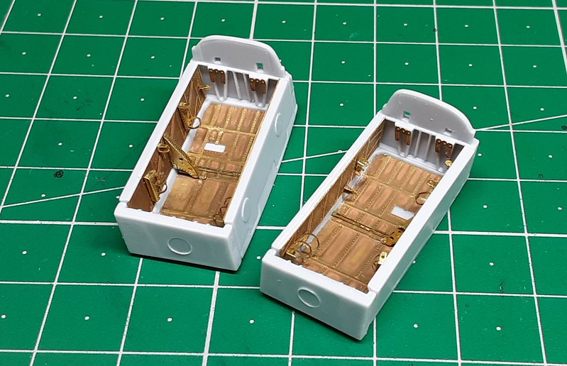

Before paint I thought it a good idea to permanently attach some of the clear parts. There are 3 pieces that make up each of the nose glazing and lower turret and they all fit together pretty well. The canopy is a fraction oversized where it meets the fuselage but not enough to warrant clear part surgery. Leaving the cockpit hatch in the open position will hide this somewhat but means a fair amount of the interior will be even more visible. With this in mind I managed to find a now discontinued Eduard interior p/e set, it's journey from Switzerland to the UK being more than offset by my lack of foreign travel in the last 25 years. And to blow the budget even more, a set of resin exhausts.
With the interior being upgraded I thought I should use the interior masks that came with the set, enough of the cockpit should be visible to make it all worthwhile. There are kit and p/e parts that fit to the in side of the glazing but with the interior painted and masks removed I think they went in without too much damage.
Reasonably happy with the results, at least content that I made the effort. Ready for paint at last.
