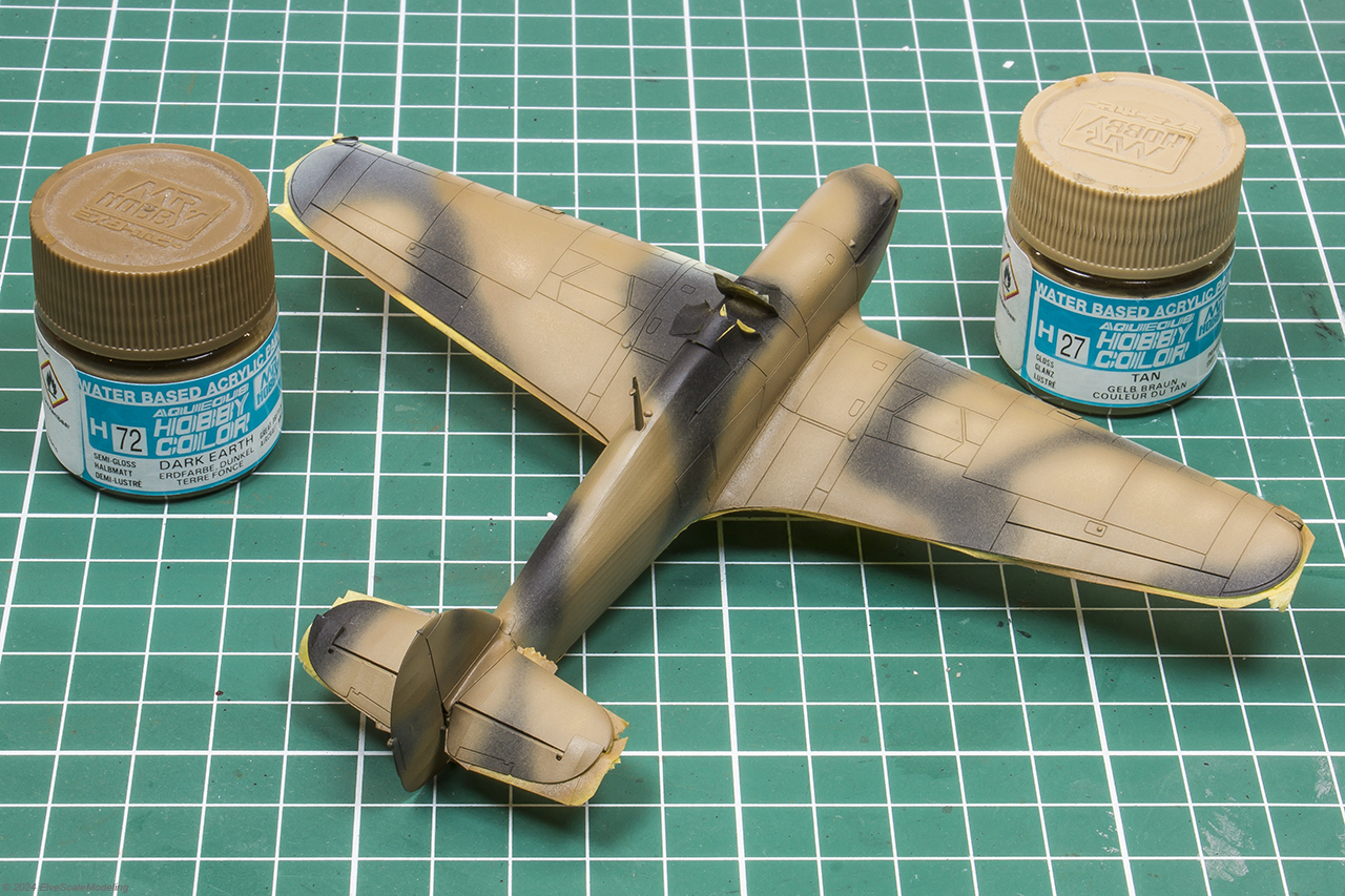

It's been a while sinds the last update, but i got a lot done. I got all the paint work finished, here are some pics of the entire process.
I started with the first camoflage color, in this case the brown color, for this i used Mr Hobby H72 Dart Earth.
With the first layer of Dark Earth down. I tried to add some highlights, i did this by adding some Mr Hobby H27 Tan to the base color. Altough the highlights are there its a bit difficult to see on the pictures.
After letting the brown dry, masked off the camoflage patern.
After wich i airbrushed the green camoflage color, for this i used Mr Hobby H330 Dark Green.
Here i added some highlights aswell, this time i added a couple of drops of Mr Hobby H4 yellow to the basecolor.
With all the painting done it was time to remove all the masking, this i what came out from underneath. In my opinion the brown is a bit light, i will try to give that a bit of a dark look with some fliters later on in the build.
