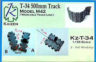

Hi Warren, I recently had my first venture with workable tracks and on Stokesy's recommendation I used Kaizen tracks. They are single plastic links pinned with thin wire and worked really well.
I've had a look around and they do a T-34 set so it may be worth taking a look and seeing if there's any recommendations on the web about how well they'd work with the academy kit.

I was considering the Kaizen tracks. The MiniArt tracks that I bought are in transit. However, they are held together with little pins which come attached on a link. These are very easy to shear off. If these do not work I will give the Kaizen a try.
Thanks.
Warren
PS Is the wire pre-cut, or is it a spool ow wire that has to be cut to proper length for each link?
Re: Need Advice on Tank Tracks
The wire is in straight lengths rather than on a spool but you do need to cut it to length. After some experimentation I found it was easier to push a full length into place and then trim to fit rather than trying to cut the right size up front. But I did put a dab of CA on the end of each link to make sure the wire stayed in place.
This is what the contents of my box looked like (it was for a StuG):
I assembled them in sets of ten links and then joined everything up at the end rather than trying to work with a full track length the whole time.
Hope that helps.

I agree with Tomcat64. I have used the Kaizen tracks on two vehicles and I really like them. They work perfectly and the price is right. They are also quite sturdy... not delicate at all.
