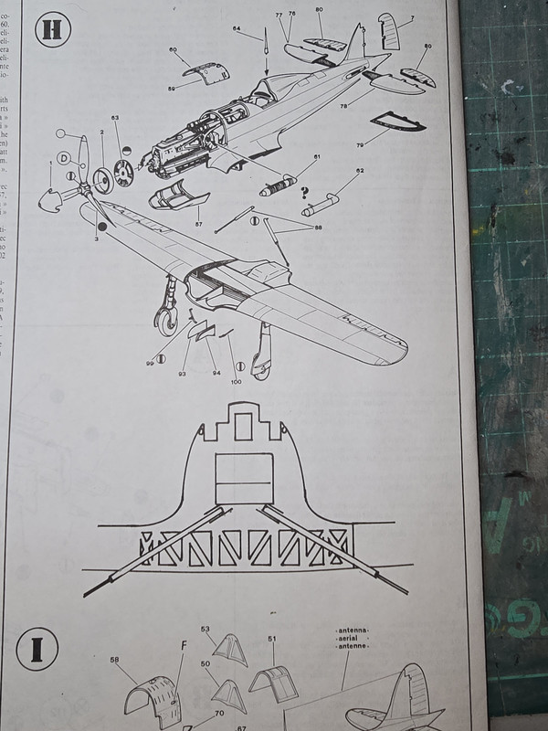

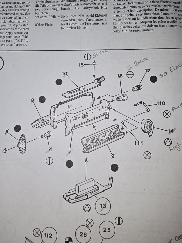

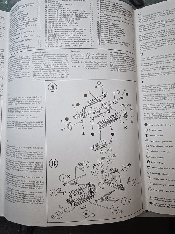

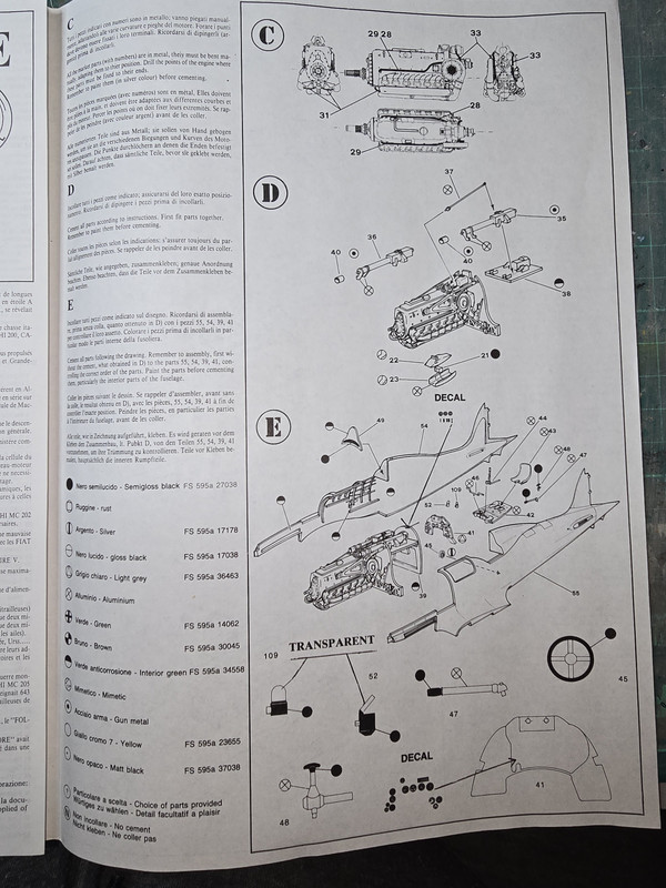

Assembly instruction

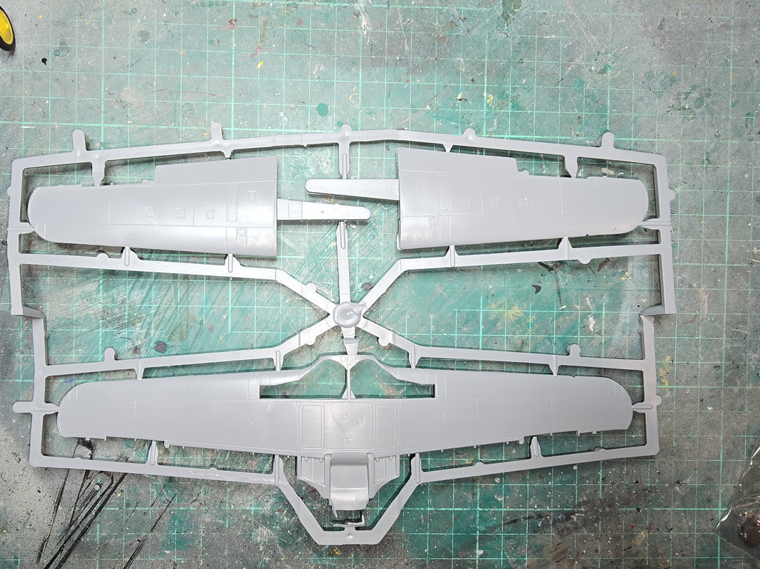

Sprues
Actual assembly won't start until I clear the Flycatcher and Viggen but first sights are the sprue gates are incredibly thick and there is a lot of flash that will need cleaning off - especially on the smaller parts.

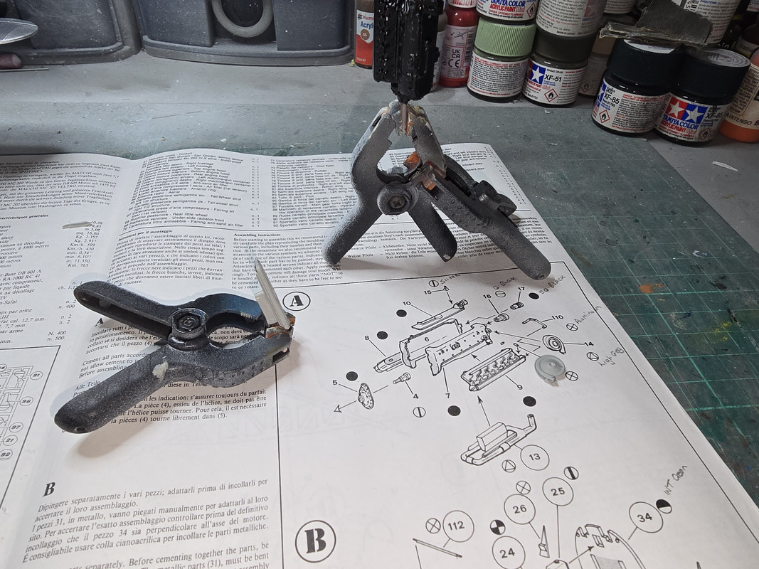

    Well - I've made a start - and the start is not promising!! I've used 9 parts and spent nigh on 2 hours cleaning flash off and sanding to get them to fit. In fairness the main engine parts (block and cylinders) went together fairly well. The shaft for the prop (part #4) needed the head reduced in thickness by at least 50% as it it sits in a cup on the front cover (part #5) which in turn sits flush on the front face of the block. What I think is the air intakes (part #13) lined up with with the supercharger (part #14). However the positioning of parts #16 - generator, part #17 - generator and part #110 - rear oiling tube have no guide as to actual placement plus part #110 only has a passing resemblance to the illustrated part!!

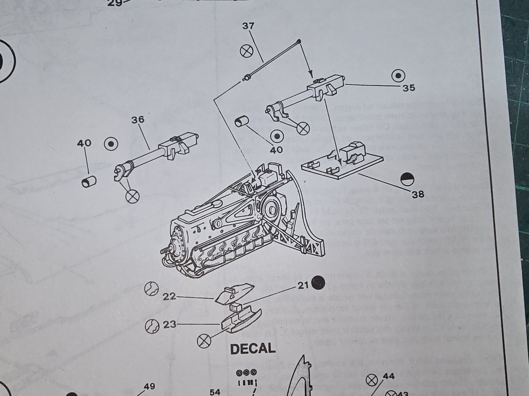

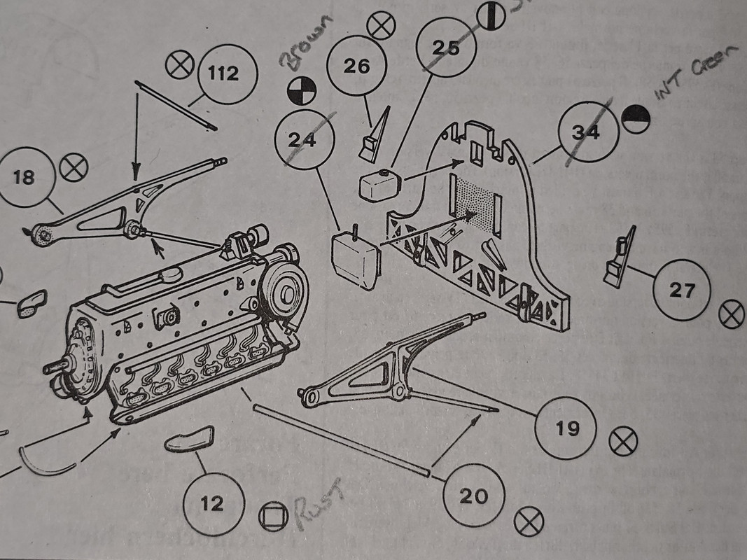

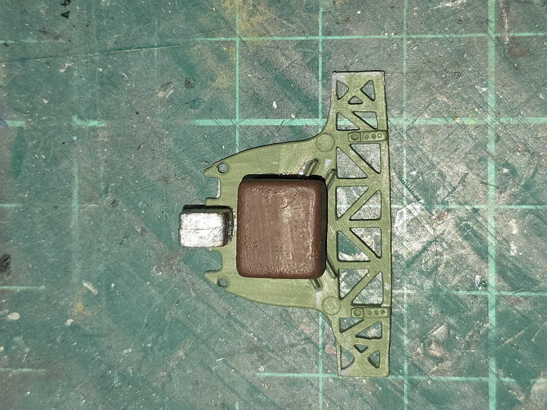

      Moved onto the engine bulkhead today:
      The brown item (part #24) in the middle is supposed to sit flat against the bulkhead. As can be seen it doesn't! The flanges for the main undercarriage struts prevent it.
      You can see how the struts go here:
      I think I need to take that brown item off and modify it to fit as intended. And there is no indication of where parys #27 and #28 are meant to go....
      This is NOT boding well either for fitting the interior to the fuselage or assembly of the major items...... :( :(

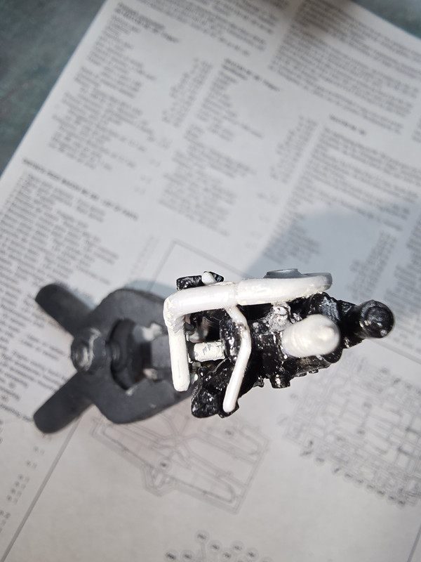

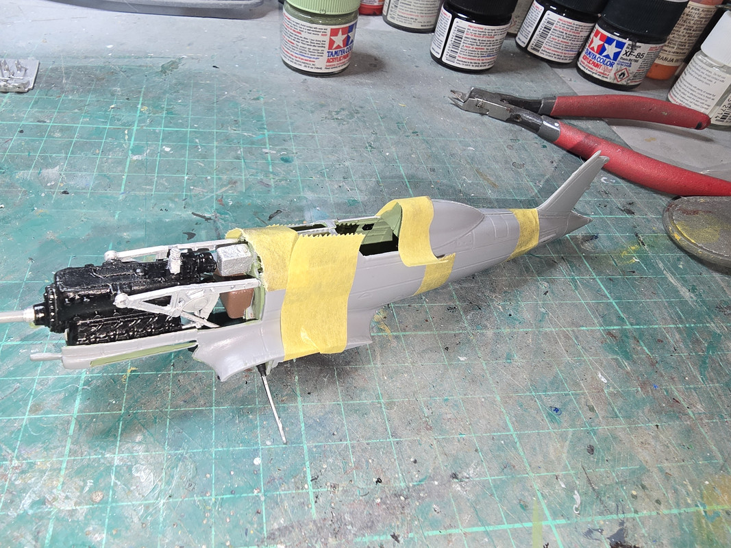

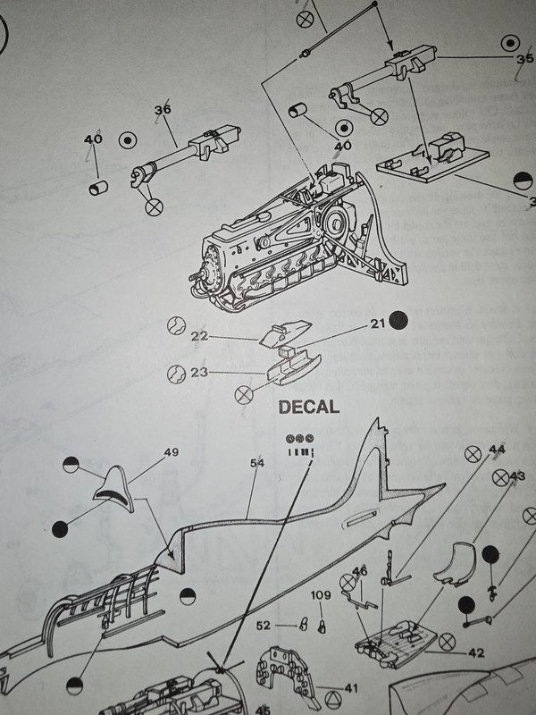

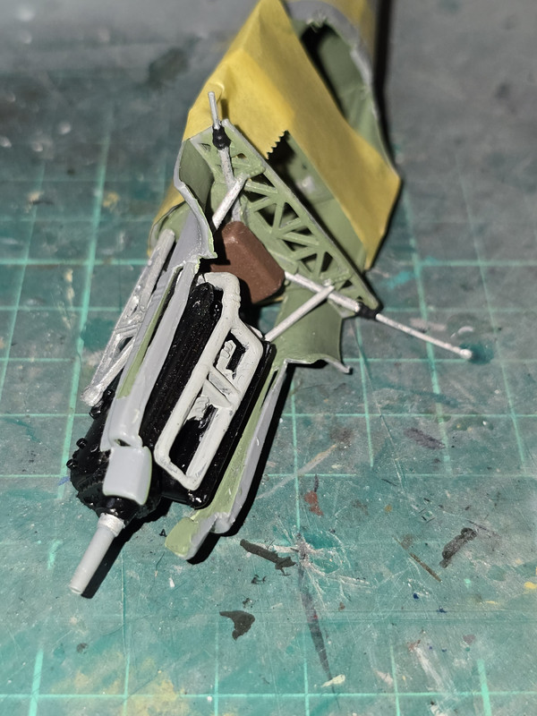

        The engine is now in the support cradles.

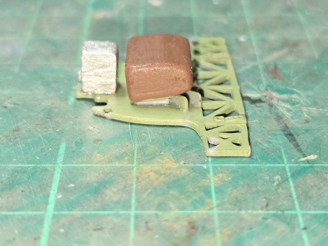

        I modified the brown "oil tank" to clear the flanges for the undercarriage legs. I also, having first checked to make sure they'd clear the wing openings, fitted those undercarriage supports as it was obvious fitting them once the bulkhead was in the fuselage would have been a nightmare.
        One of the two round objects on the back of the engine had to be relocated - I think it was the one labelled as "starter motor". I had to guess where they went as, quite frankly the instructions are crap! Once you try fitting the engine to the cradles, though, it becomes glaringly obvious.
        I should now be fitting the exhaust stubs - but I'm going to leave those until I can dry-fit the sub-assembly into the fuselage halves as they have to fit through a narrow slit.
        There is an air scoop that goes under the engine - once again the parts on the sprue don't match the assembly diagrams - can you spot the difference?
        Moving on - the cockpit floor is assembled, just need to add the pilots seat. Again that will wait until the sub-assembly is in the fuselage so I can get it to line up with the headrest. A couple of handles need to be done semi-gloss back too. I had to drill a hole for the rudder pedals as one was shown in the diagram but didn't actually exist!!!

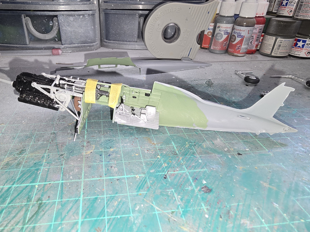

        Finally the fuselage halves are being detailed. And it's at this point I realised not only is there a LOT of flash but some of it is so thick its hard to tell whats flash and whats the actual part. Which is really worrying me as regards the rest of the build.
        Adding the platform for the guns (part #34):
        I found it easier to tape the fuselage together, drop the engine sub assembly, drop the gun platform in and join them that way. Letting this set overnight.

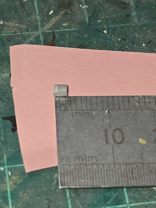

        The instrument panel has a decal to go on it - I think these location "blobs" are too high to expect a decal to conform so sanding them down may well be in order......

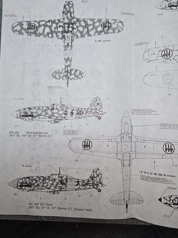

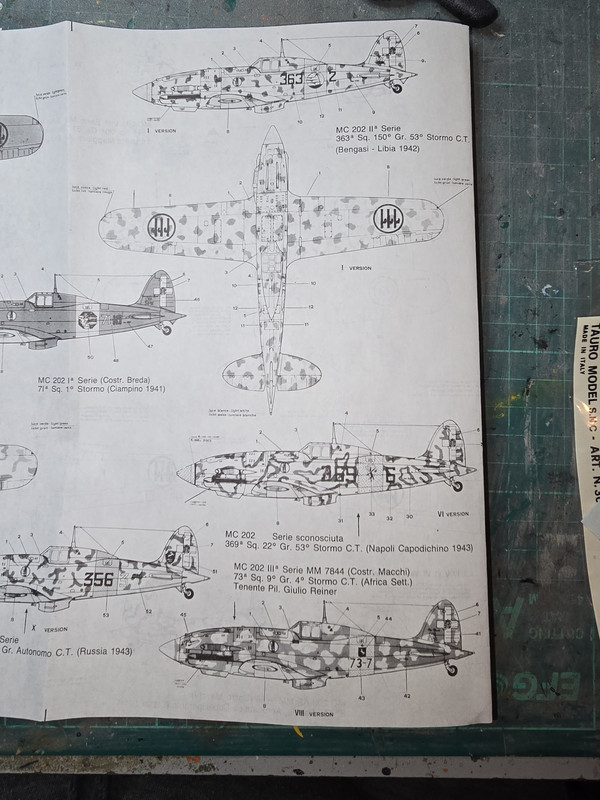

            In the meantime does anyone have any idea what colour "Mimetic" is? Its called out in the colour scheme and is used on the scoop under the engine.
            I've tried Google but that comes up with the name of a range of paints

              Mimetic.....is the camo I always thought for Italian planes all that swirly lines type of thing.
              Re: Taurus models 1/48 Macchi MC202 "Folgore"
              digger303 wrote: Sat Apr 05, 2025 12:44 am Mimetic.....is the camo I always thought for Italian planes all that swirly lines type of thing.
              Interesting!! The scoop is on the underside and would normally get a coat of the Italian underside light blue. Its odd thats the only part calling for this finish..... Oh well - think I'll go wth the blue, not enough mojo left on this project to go digging!

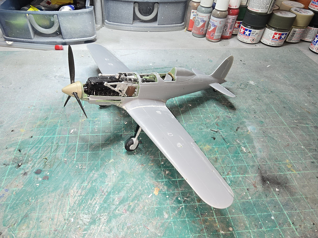

              So - onto the progress!

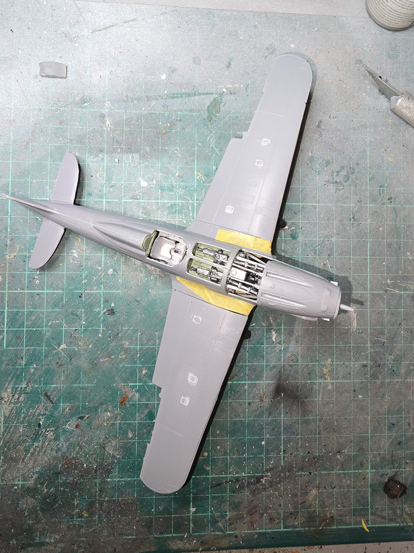

              The fuselage halves are joined - and no filler was required!!
              Tail planes are assembled and fitted - again, no filler.

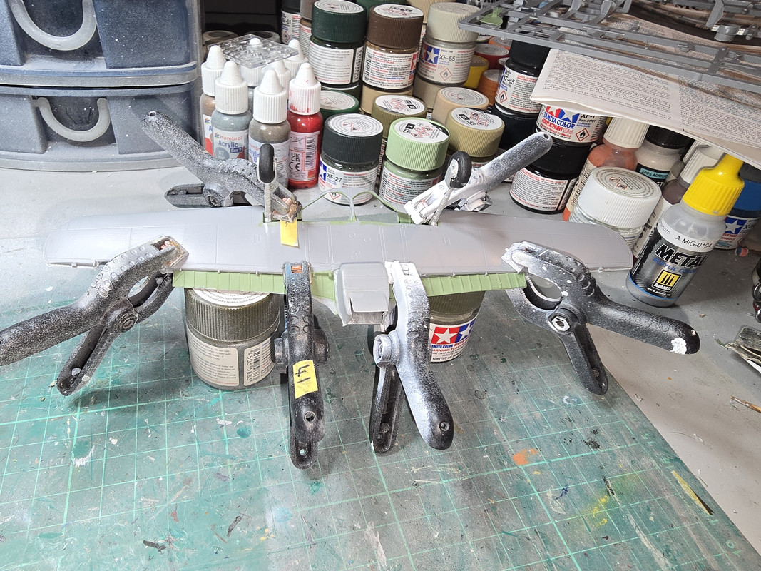

              Wings are assembled - again so far no filler required.
              Colour me absolutely amazed after all the crap fits so far

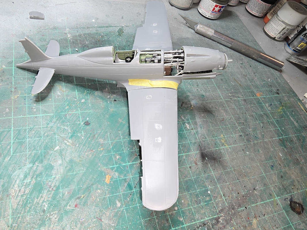

              However there is one issue I need to solve - the engine is kicked up at the front so I need to find a way of drawing it down. I'm thinking maybe a drop of debonder on the rearmost (lower) mount points.

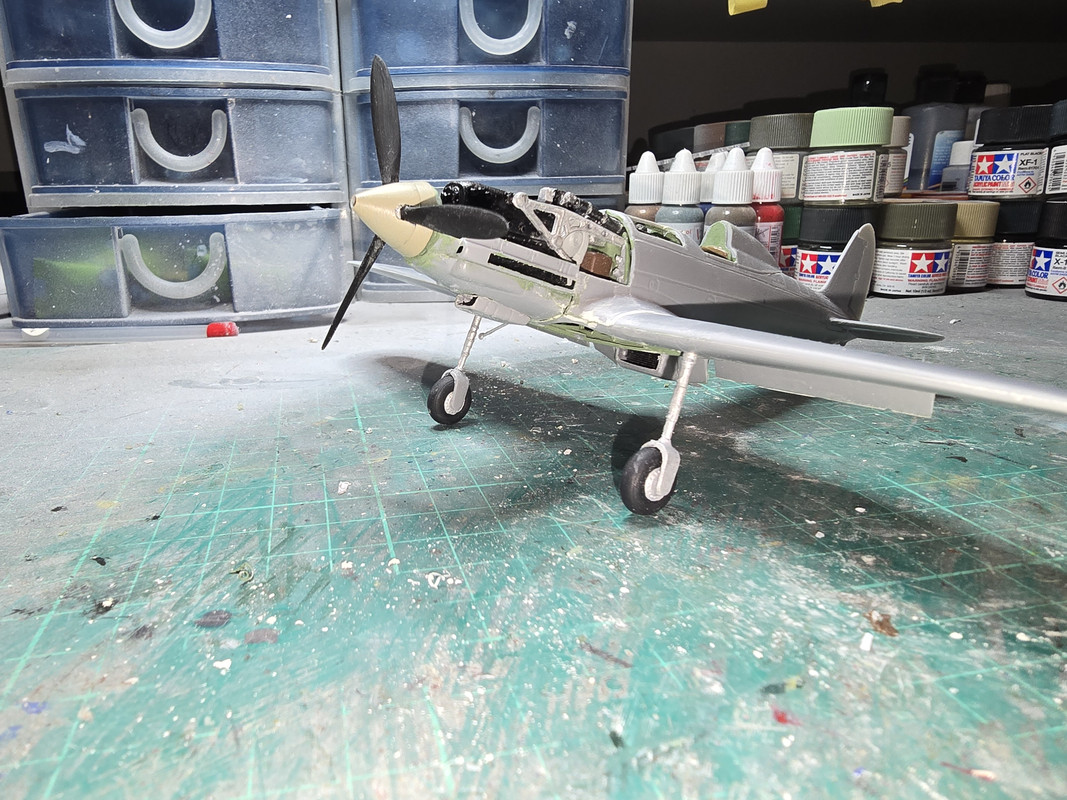

                Wings are on. And with the fit I'm now used - bad!! I think Diggers prophecy is about to be filfilled - LOTS of filler!!
                Gunports in the engine cowl are opened up:
                And the prop is almost done:

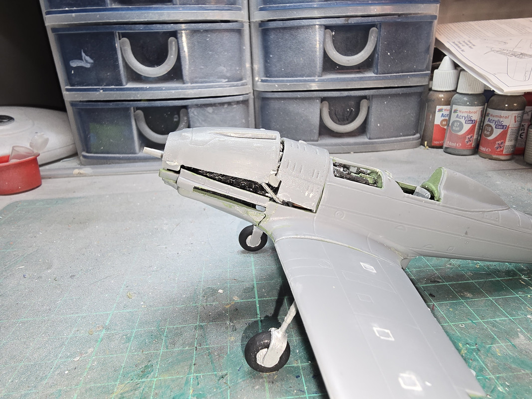

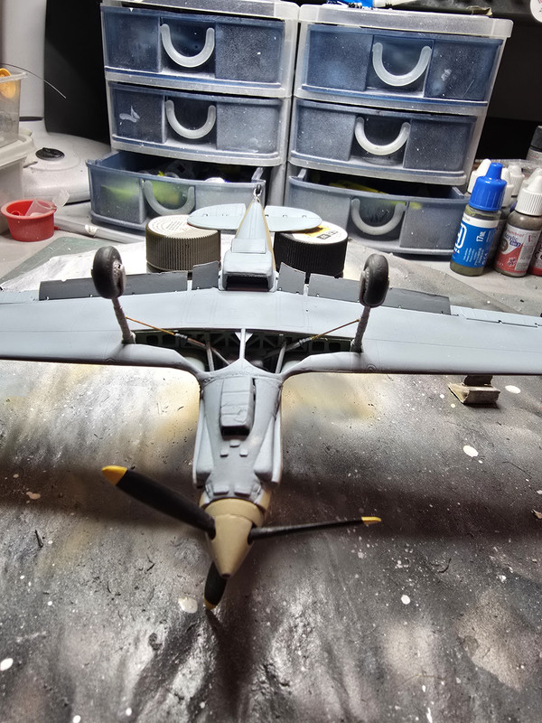

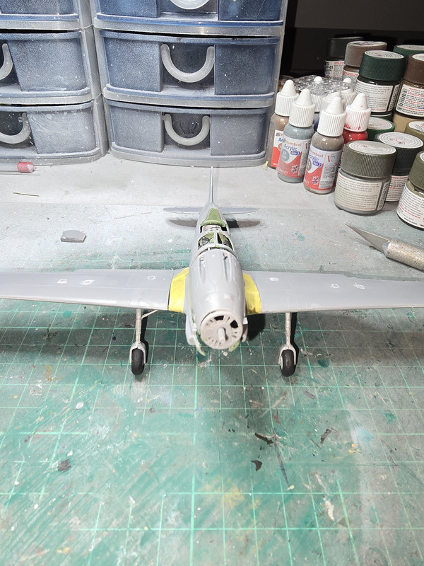

                  Progress continues - slowly.
                  Firstly the air intake under the engine was missing the mounting point, it wasn't actually moulded onto the top half of the intake even though shown on the instructions.
                  I had to trim 2 mm off of that new piece to get it to sit properly. At this point I'll make the observation that a good many parts were missing similar sections - outer halves of the under carrage legs and both halves of the tail wheel were missing the axle pins being the most annoying after the intake.

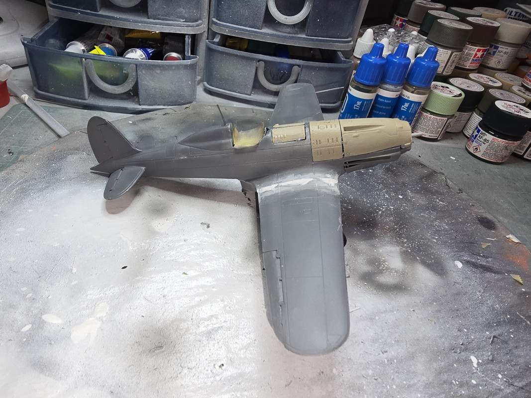

                  Wing roots are now filled and sanded.
                  As can be seen the engine has had the nose-high attitude corrected and all the lower parts of the nose are in place. However there is now a bigger, more serious problem - the upper engine covers will not fit as everything is too high.
                  I'm thinking at the moment the only solution is to remove everything above the support cradles ahead of the firewall - thats the guns, supercharger, iterrupter gear etc. I honestly can't see any alternative ......
                  Other than this the rudder, elevators, ailerons, flaps are all on so getting close to paint going on once I solve the engine cover issue.

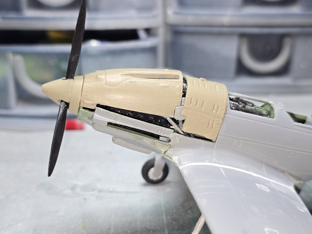

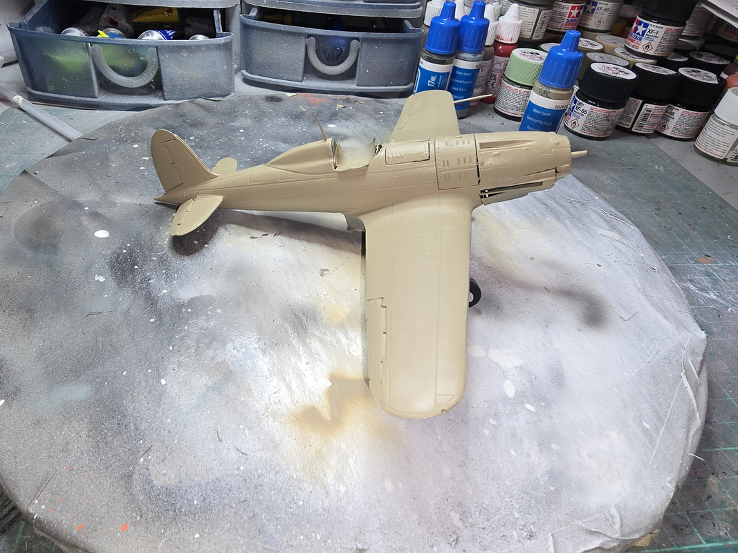

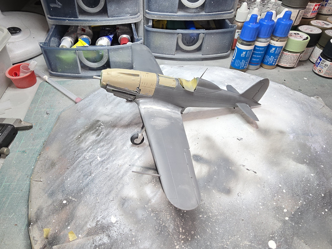

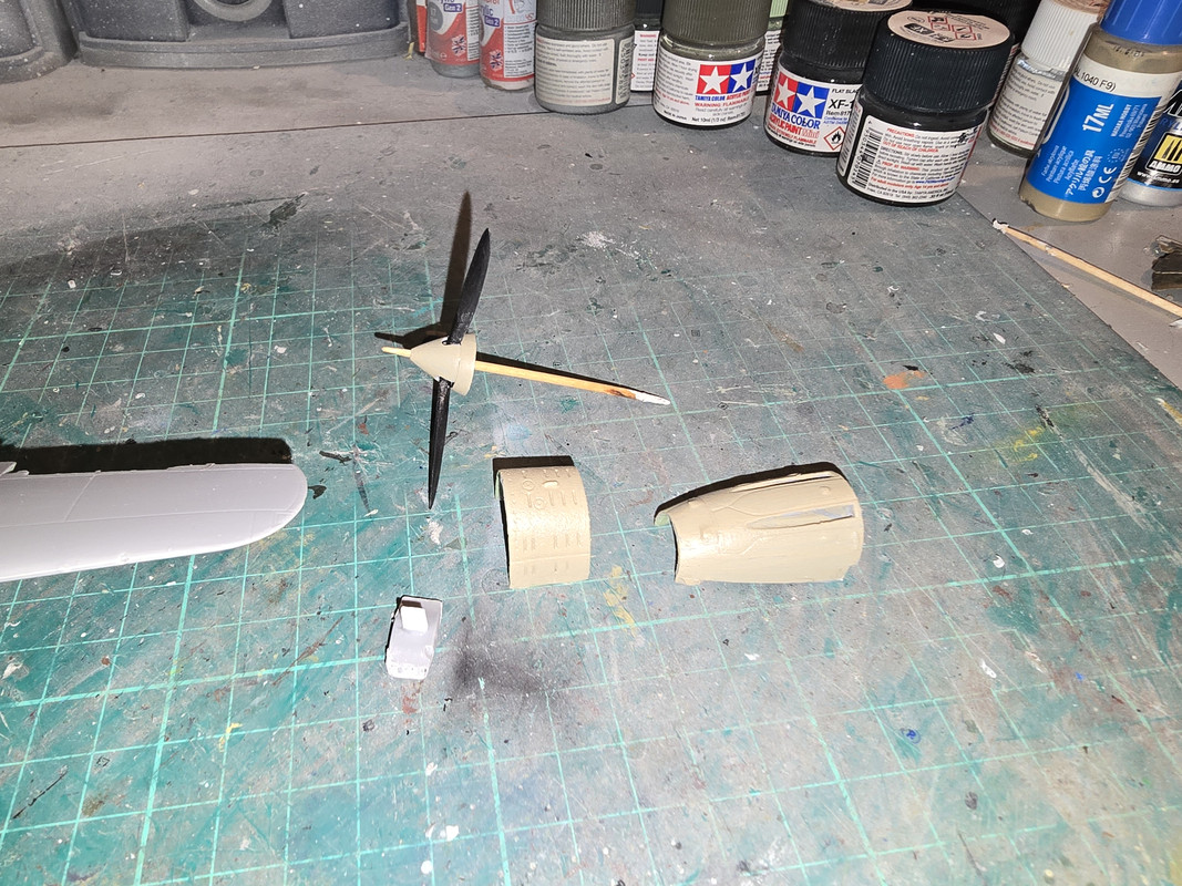

                      Latest status: Someone gIve me a hammer - PLEASE!!
                      I cleaned the top of the engine off and the cover still wouldn,'t fit.... Ended up javing to sand the bearer frames as thin as pssible and retain integrity. So it now fits - but poorly. Same goes for the gun access doors. I couldn't be bothered to sort this out as, AFAIC its just gonna get a quick paint 'n decal then get pushed to the back of the display!! :evil:

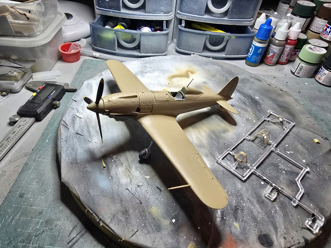

                      And with tne top coat of "Nocciola Charro 4" applied.
                        At least the paint has gone down nicely.

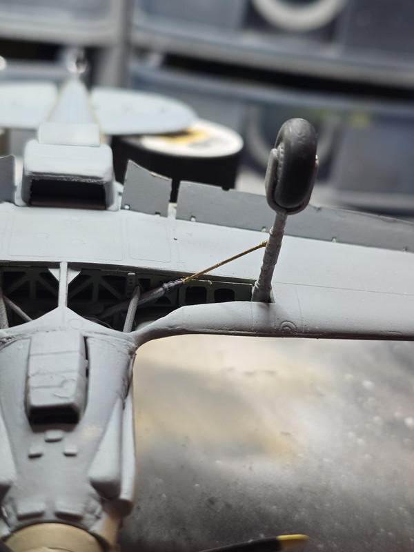

                        That said - todays first job was fixing the undercarriage supports. Avid readers of my ramblings may recall one managed to get broken and half lost to the unforgiving floor monster. I'd taken a quick measure of the survivor and a Tiger 1 trackpin was just the right size so today both of the support legs were so modified.

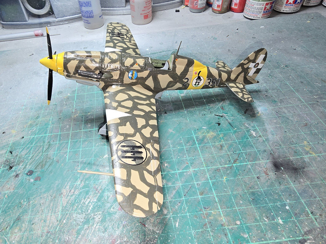

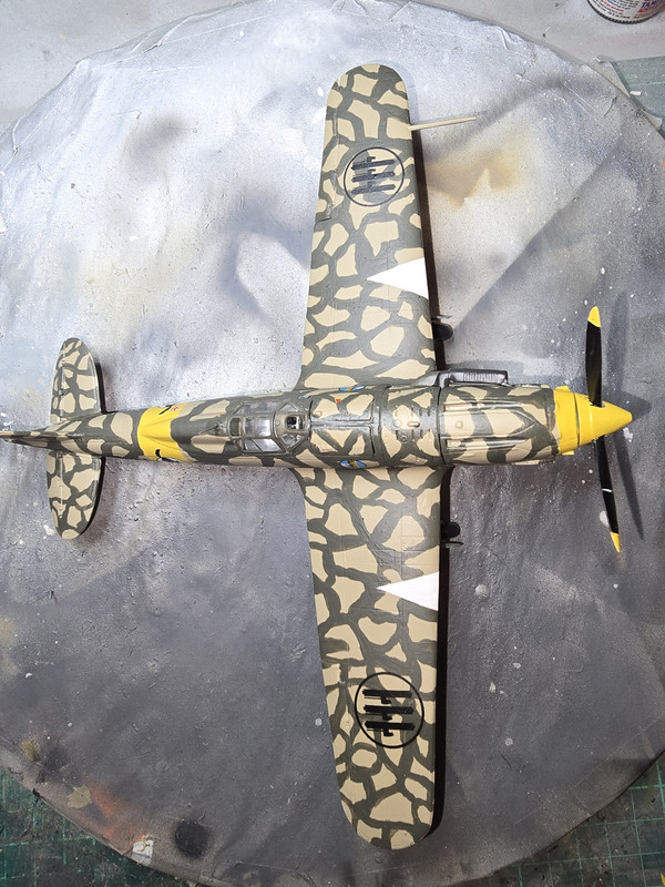

                          Oh well - this one is what it is. I picked the - for want of a better word - "block" cammo scheme rather than the "smoke ring" one in the hopes the Dark Green overlay would hide the poor fit of the panels from a distance. I think it might have worked!
                          Just needs a gloss coat now then its time for decals - and I am praying like hell the decal sheet is OK, not going to break up as soon as they hit water....

                            Nice work on the camo.
                            You were right about other manufacturers. Hasegawa definitely do a 1/48 Folgore.
                            Posts: 1386
                            You nailed this difficult camo perfectly ! nice job !
                            Decals went on tonight. Amazingly they went on perfectly!!!
                            Next step - matt clearcoat then fit the canopy parts and work out how to rig an aerial wire!!

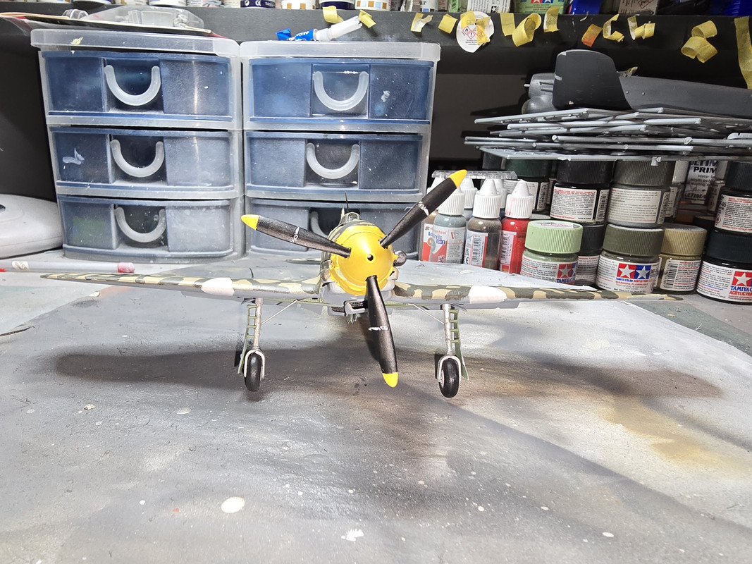

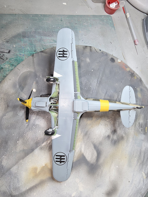

                              All finished bar the aerial wire - going to leave that till I feel happier.
