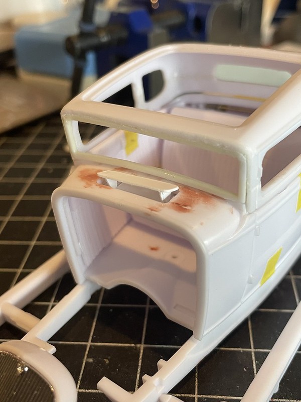

So, as Matthew pointed out, I never just make it out of box.
Starts with modifying and chopping stuff up to lower the roofline
The top has 3mm taken off the struts to lower or chop the roof down…it looks so much better than the box stock
I just used Tamiya tape cut 2mm wide, put it around mid roof level and made the saw kerfs on all cuts
Then the bottom cut off fully
Then the top cuts completed
Dry test fit
Glued up

Looks cooler for sure, but now your going to have to make all new windows. Is that a issue ?
Re: American Graffiti ‘32 Ford Coupé
digger303 wrote: Sun May 11, 2025 11:46 pm Looks cooler for sure, but now your going to have to make all new windows. Is that a issue ?
Yep
All the windows have to be modified :wall:
But I knew that going in

I cut the front windscreen shade off and will make a new flush frame for a shortened window

Rough out from the front window.
Chopped the frame and trimmed the kit glass 2mm each side
Cut the frame bottom from the top
Test fitting glass behind to determine how much clear plastic to trim. Top of frame is cemented so have a stable reference
Fit with out glass. Cut a good 2mm off each vertical side of the frame
Fit with it all together
Lots to clean up, but this should work

So next project in this build is the vent in front of the windshield
Reference pics
So I cut out the rectangle and sanded the sides. Had to fill in a couple errant razor saw scratches too
Playing with the front grill/radiator
Vent rough made
