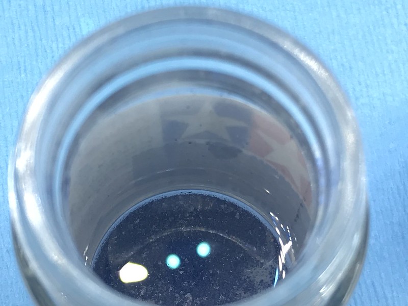

1. Recylce paint thinner: I now gather up my Mr Hobby thinners used to clean airbrush and brushes and put into a settling jar. Allow solids to settle and decant the clear top stuff for re-use. The solid paint particulates can be added to paper shavings and then thrown out. I will still use the "purer" MLT for my paint, but for cleaning I will be using the decanted stuff. Apparently we should be doing this for all lacquer thinners, white spirits, turpentine as petroleum distillates have infinite use and shouldn't be put in the drain. I have been putting them down the drain my entire life, so that changes now.

This is decanting some lacquer thinner used to clean airbrush from dirty jar to the cleaner jars after letting it settle and also filtering it
I use an old shot glass to hold my medicine cups so they don’t spill and these little Mr Hobby mixing caps make great hats for the medicine cup
I hadn't got around to using filter paper to clean my thinner yet. I'm a bit lazy and just let it the paint settle then pour off the clean liquid. The shot glass holder is a good idea, but when I'm not finished with my paint and it's a a blended color I wish I had a lid that seals so I can store it for a week. A silicone stretchy cover would be nice.
I'm still using those disposable pipettes which don't last long if you press on the seam lines. It was a 100 pipettes and I'm still working my way through them. I may have to buy a 3 glass ones. One for paint,one for thinner and a spare.
