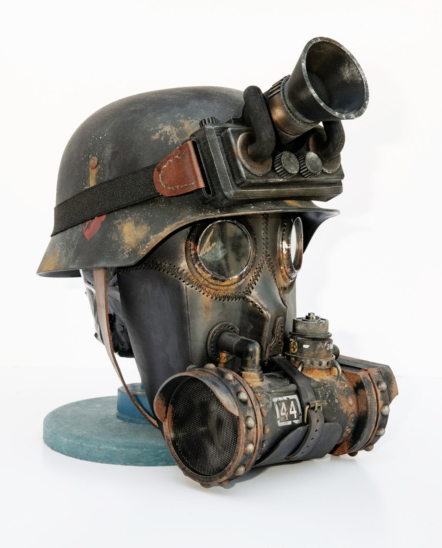

I’ve been playing with 3D printing making my own stuff from scratch ( Think life sized Steampunk Nazi Zombie apocalypse )
So far I’ve been using left over decals to enhance the finished prints, but I’d like to be able to make exactly the decals I want..
